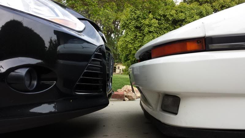

On topic, the last thing I did was put on the stock lip, wash and wax it (In all honesty, it needs a clay bar and polish). Then decided what to drive. The dilemma I have is MPG vs HP. Although I pick the Supra more often:
I didn't realize the Supra was that low until I took that picture.
