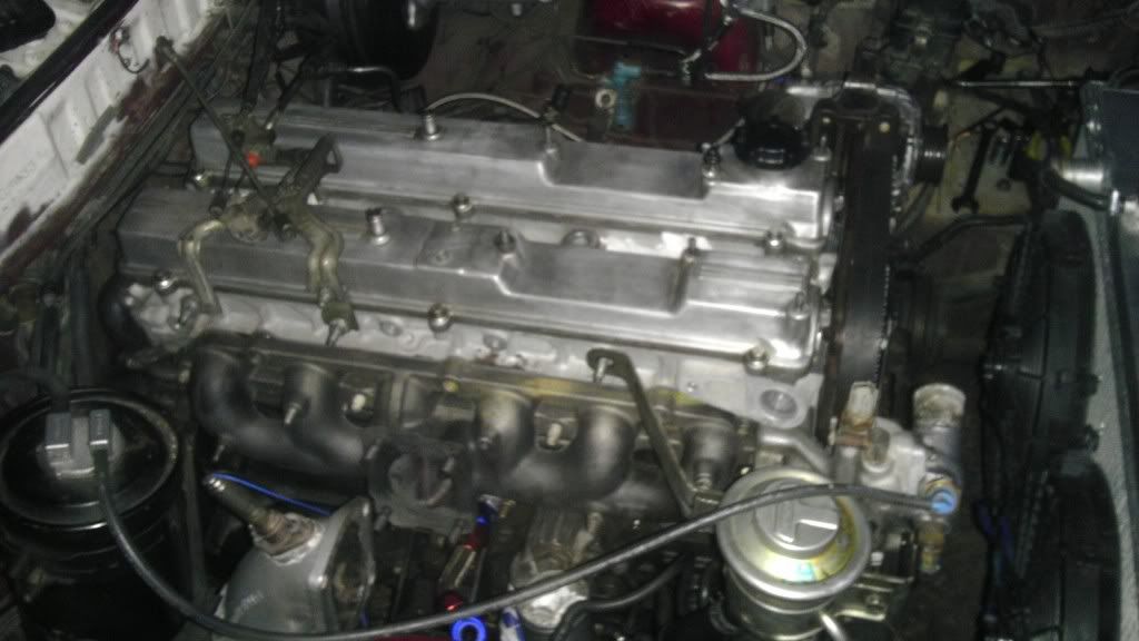

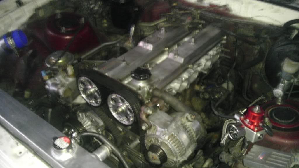

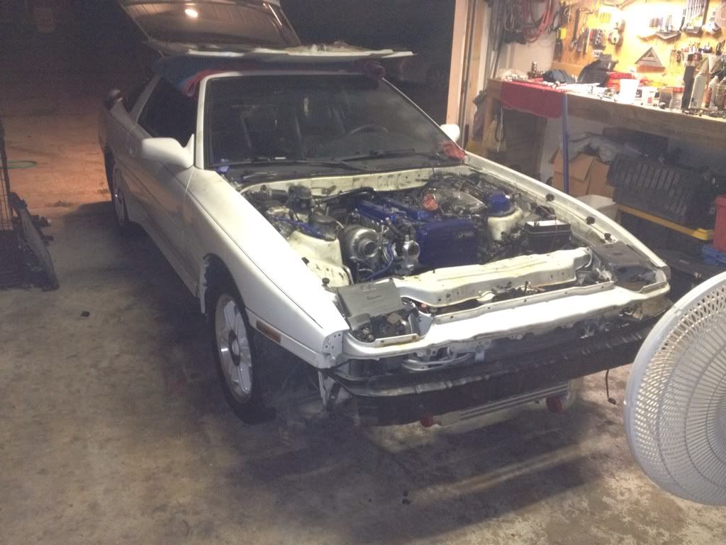

91whitepack
May 23, 2012
71
slidell, louisiana
cleaned the new head up, swapped all the intake and exhaust studs from my old head to my new one, relocated my oil cooler because of the drifmotion intercooler kit, and last but not least, got rained on as i started to clean up my work area

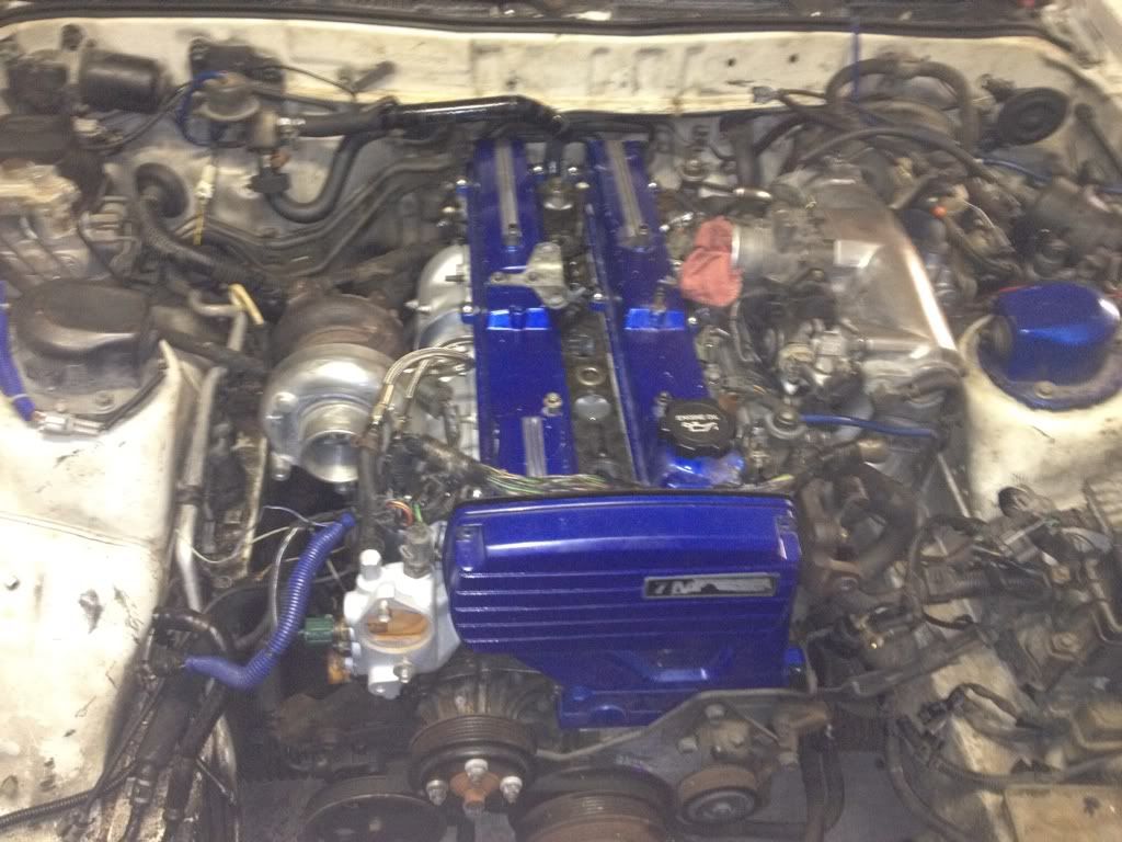

I put on the Nitto NT05's, cleaned up the engine bay of the dust with a rag, washed the windows off with my secret "water bottle and a rag" technique. Then I drove to my parents house to pick up the video camera they have, and found out that the gas station by their house has E85 now. :D
Took a bit of getting used to the stickier tires. They're also heavier, so it takes a bit more effort to get the car moving... Will install the boost controller this afternoon, but found out that the track is out this weekend. Not really working for anyone but me, and I don't want to drive 200 miles away to beat on my car without anyone else I know with me... never know when something will break unfortunately.

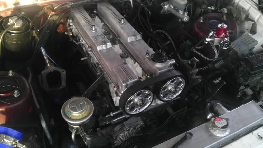

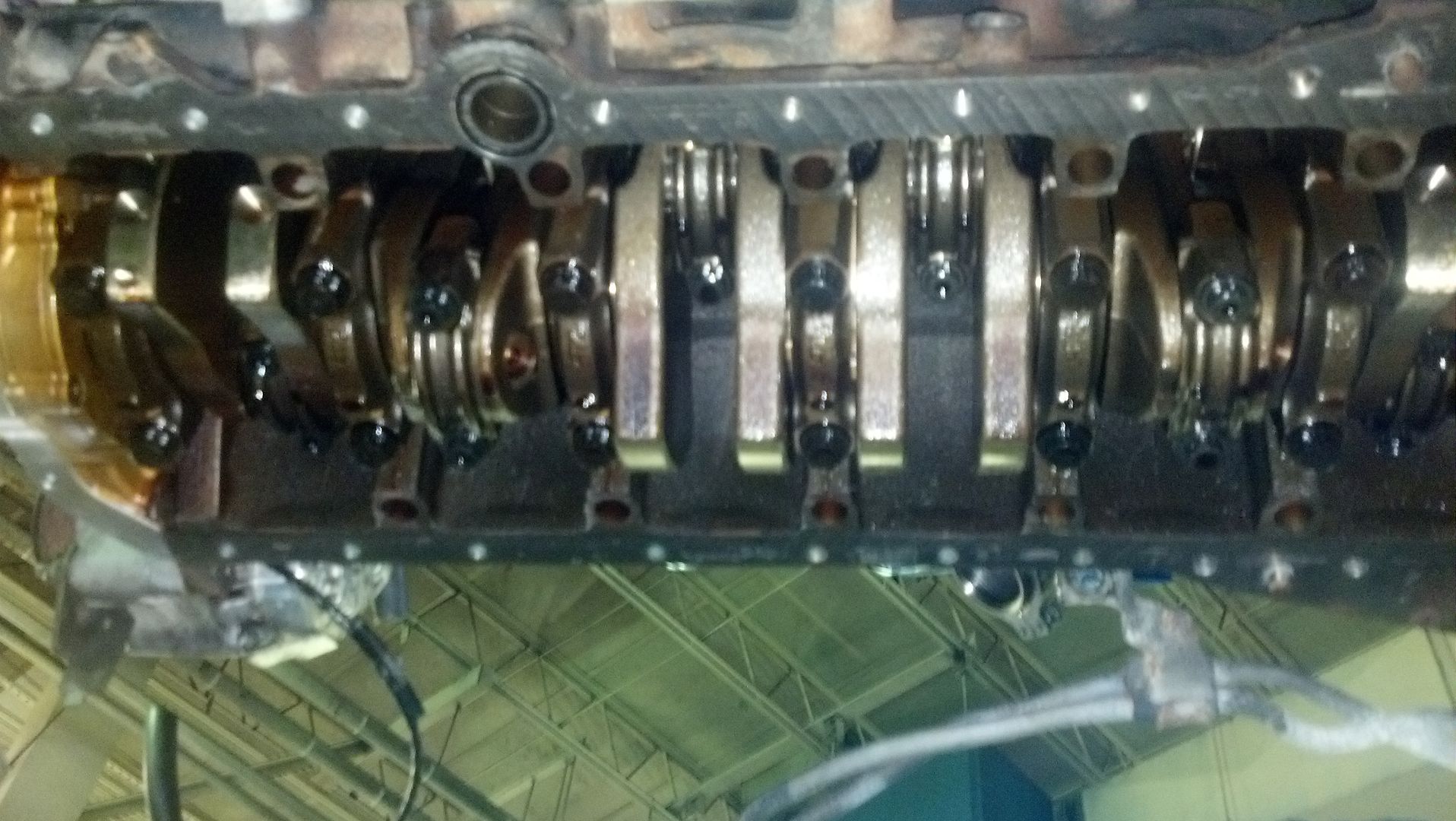

Installed new oil pan on 2JZ, took pics of bottom end of motor for cleanliness check...
Pretty.

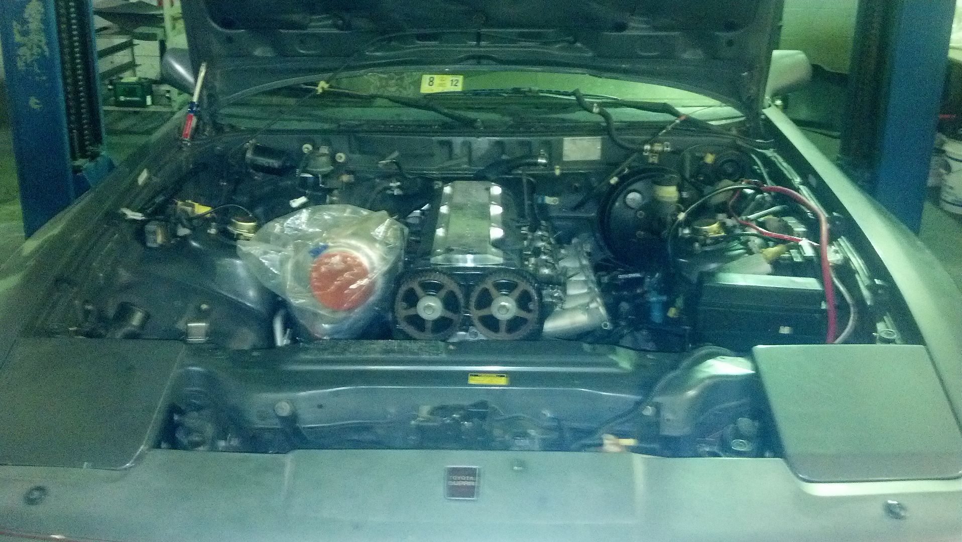

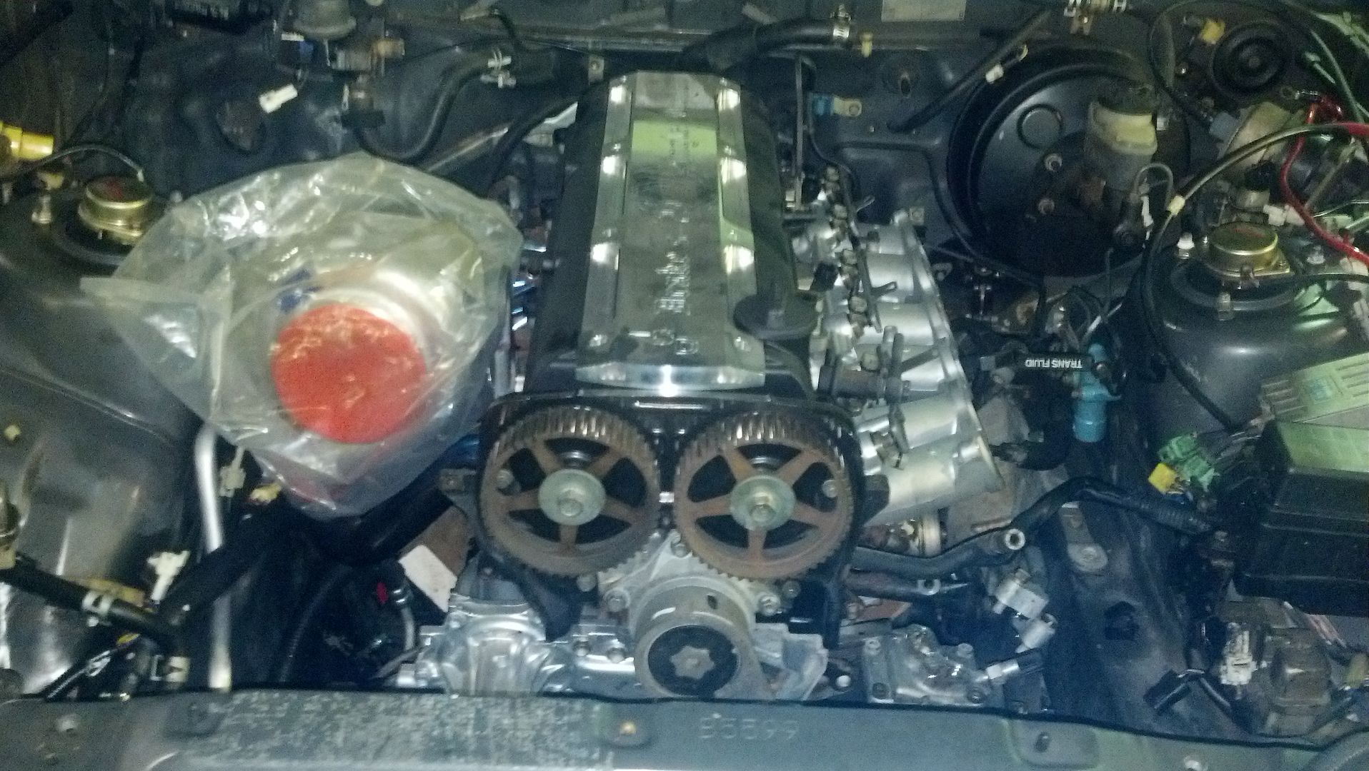

Then moved it into the bay to test fit the motor to the new mounts and setup for fabbing the new crossmember and piping needed to make this all work.
Not very good cellphone pics...

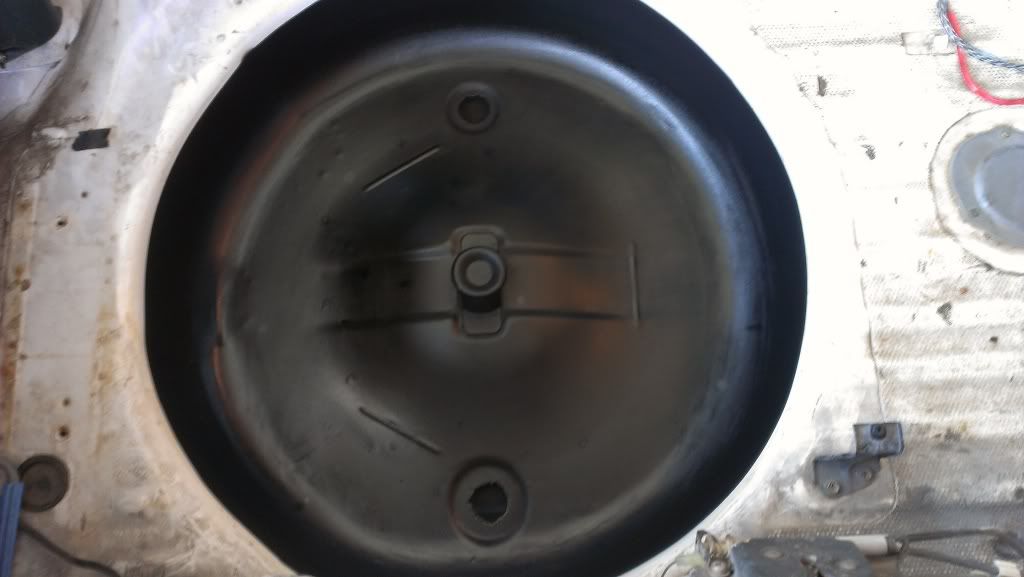

took all the interior parts out of the hatch area to find a water leak. cleaned her up a bit, and went for a drive.
contemplated putting on all my new parts, but got lazy. :(

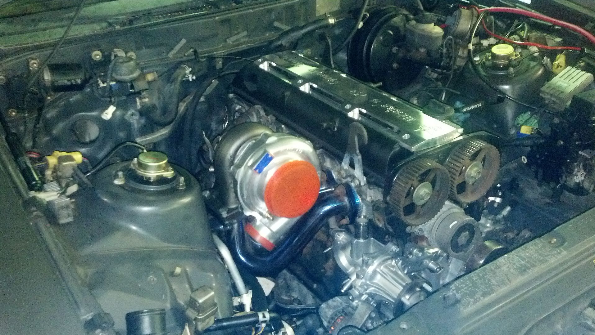

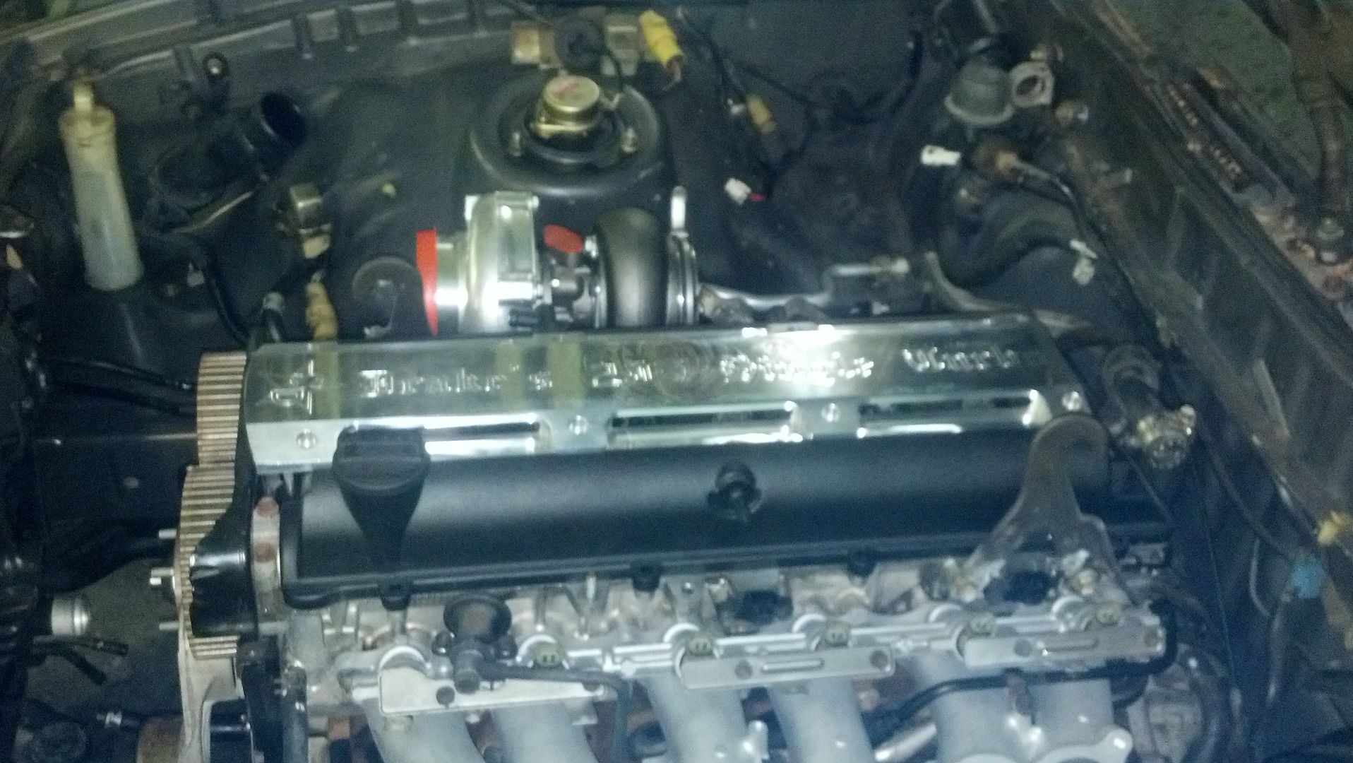

took off the old gasket crap on the intake system. test fitted the fuel rail, ordered an set of EGR block off plates, waiting on injector ring set, ordered my NA-T soft line kit, tonight im slapping on the turbo, fuel rail, intake system.
