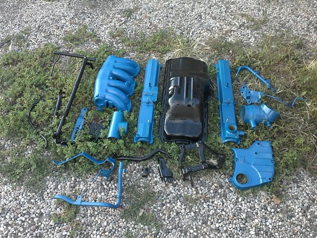

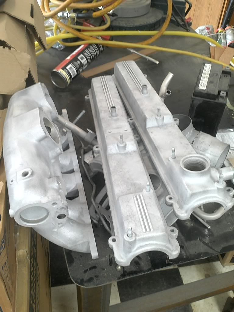

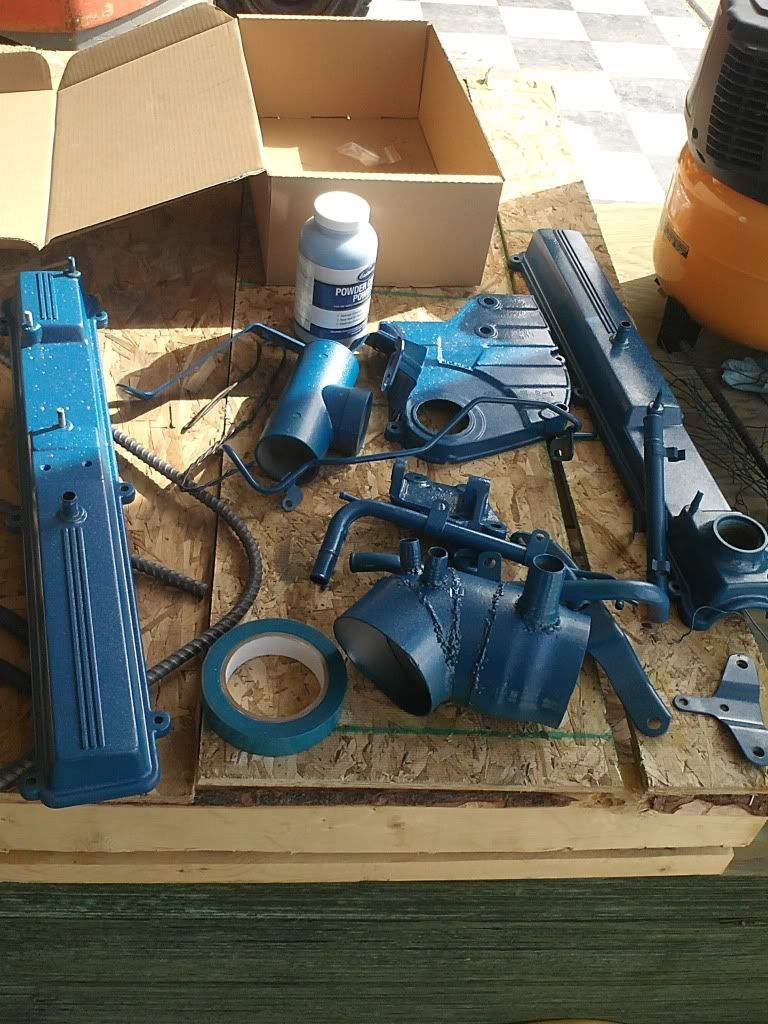

I had a productive day of playing with a powder coating machine.
Well, first the sandblasting cabinet
Then I did one with blue, and a metallic clearcoat
Then I did a bunch of parts in gloss black, parts that don't show.
test fit a few on the stand.
Messed up on the intake manifold, so I'm going to have to strip it down and do it again. Too much clearcoat. It's got the whole "milky way" thing going :( The powder kind of came out way too fast as I tipped the gun.

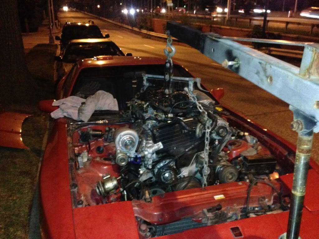

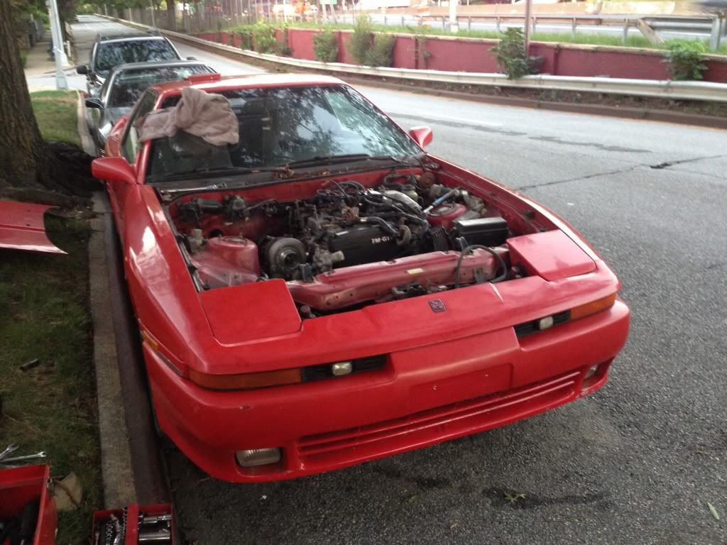

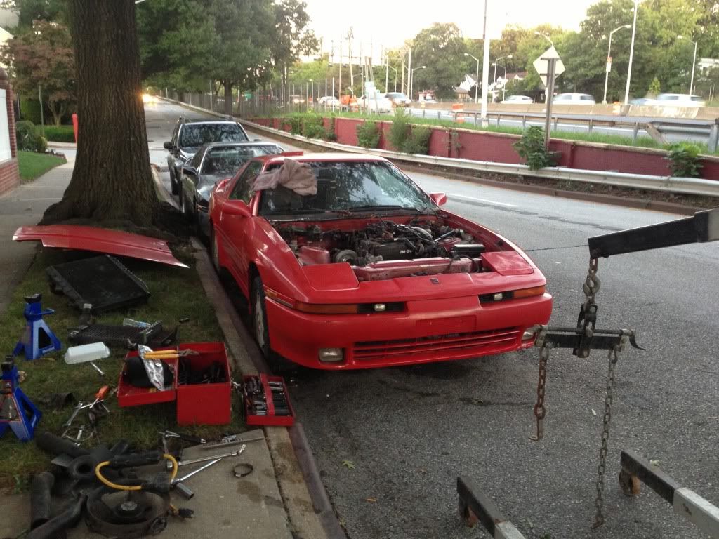

You pulled the engine on the roadside? I'm impressed. I figure that if I tried that here, I'd get in a lot of trouble.
