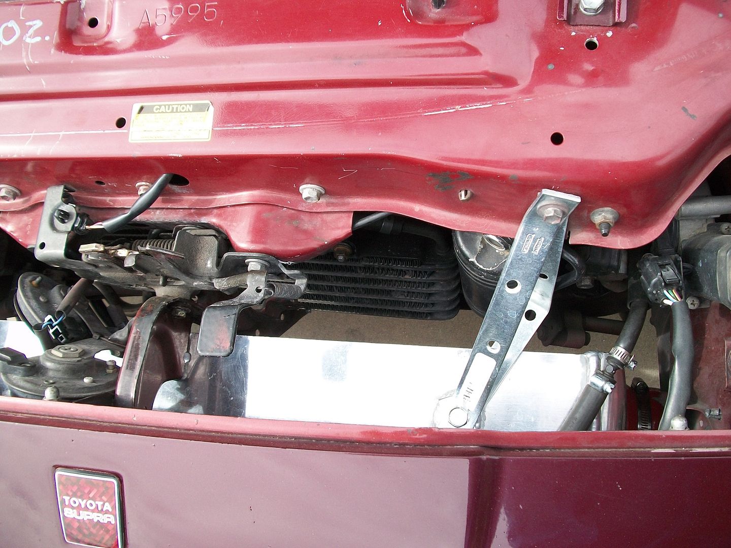

I just saw in the "what did you do to your supra today" thread about someone mounting their oil cooler in front of the radiator and it was mentioned not a good idea because of the heat the oil cooler generates. That might be half MY problem! I have my oil cooler mounted to my condensor which in turn means the radiator fans are sucking hot air caused by the hot ass oil cooler. I know for a fact my oil gets in the 150 - 200* range fairly quickly and stays in that general area. So, instead of the fans pulling 80-90* air through the radiator, a section of the radiator is pulling 150+ degree air. Hmmmmmm...now I have to think about relocating my damn oil cooler. Granted, it's a stock cooler, but it's still generating heat right in front of the radiator!

Nup, i dont think so, Ive had my oil cooler directly in front of my Radiator for years now and no problem at all. Check for tiny leaks,,, heater core especially.

Thanks -- I think I licked it today. The crap fans that came with my radiator were just that...crap. I replaced them today with a set of fans that were on the car I pulled this motor out of. They're not Toyota, but they fit my shroud mounts perfect and they pull about twice as much air as the POS ebay crap I took out. Ran around most of the afternoon in 95* Arizona weather and my temp never went above 190* -- the temp rating on my thermostat.
