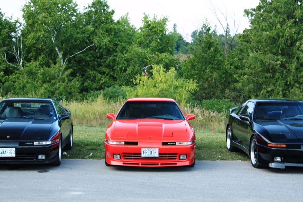

I was told that the best place to add a vent to the stock hood was 15" back from the front edge. This puts it between the radiator and the front of the engine. This is an area which has low pressure due to the shape of the hood and is placed where it can actually do some good for the radiator.
There are a few local guys with this done and it looks great.

spiller;1446654 said:
^^^ would like to see pics of that. i guess radiator assistance is beneficial but they are also good for reducing heat soak of the hot and cold sides of the motor.
This looks nice and subtle while being useful. It also doesn't cause a problem when raining or washing the car because of the vent location.
