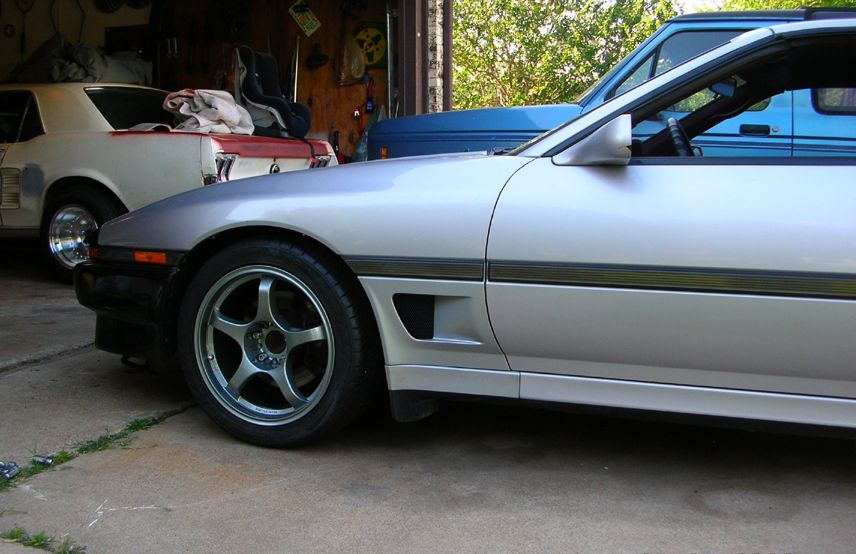

toy fanatic78;1262221 said:
Jimi87-t:I like the vents you did too,I take it they are 'glass/plastic add ons.Are you gonna mold them/paint them?
That side shot shows them better and they look like they are in a better location than I thought, so don't mind what I said about them being too far back ;)
Thanks, yeah I molded them out of fiberglass, they will be filled and painted with the hood like the side vents I did.

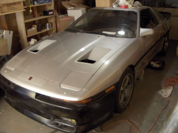

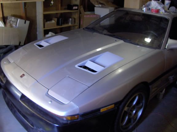

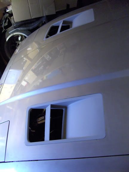

jimi87-t;1261126 said:
Nice work! You did a great job, I also like that style of vent, but I went a slightly different route. The only "problem" I see is yours are set back on the hood, in the high pressure zone of the hood and would be way more effective if they were more to the front in the neg. pressure zone of the hood. Not trying to be an ass, just pointing it out. I think you did a awesome job!
Here are some picks of mine, not done yet, still deciding on the number of louvers (if any) I want.
Jimi,
Are those drop-in inserts, or did you fab those up? They look great!
