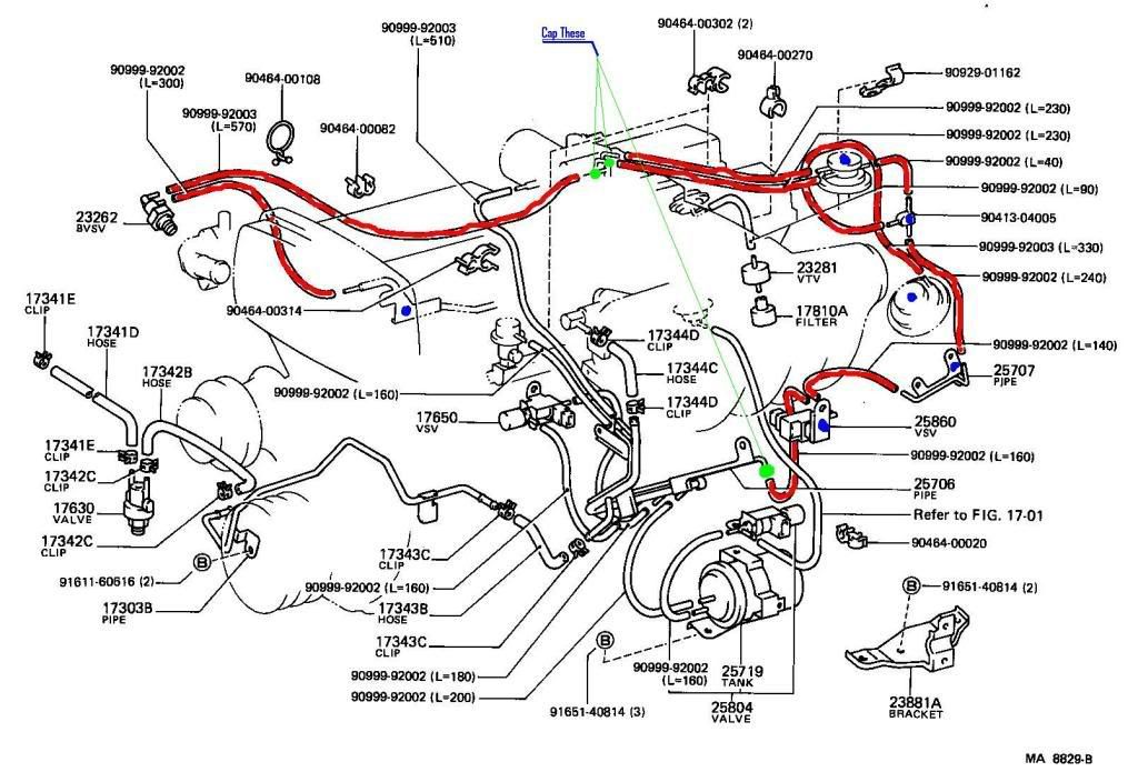

Now for your vacuum hose layout. All I have to say is the layout for the 7MGE Sux! no wonder you were confused. It's way more complex than the 7MGTE. Now I don't have a 7MGE so I can only tell you what I know you can remove. After that we need to get some one who has a N/A engine to tell you if there is any more.
Here is the pic, see if it helps.
Same thing as before. Red are the vacuum lines you can remove and the green is the places to cap. And the blue dots are pieces that you can remove.

okay, few things... the orange signifies where one of the lines run... can i just cap it at the source? and also...

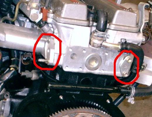

the light blue shows what i actually did... i re-routed the hoses to go into eachother to block off vaccuum leaks, is this okay?
