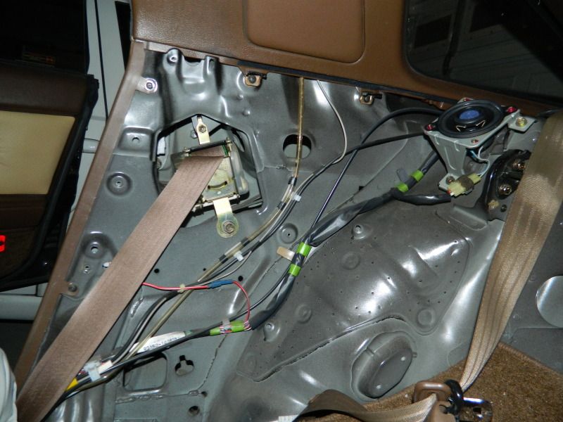

86.5-'88 rears are 4.5", but 5.25" can be made to fit. It's not an EASY fit, but it works. If you're not up to doing some cutting and making stuff work, you're best off sticking with 4" back there, too.
'89-'92 also have 3.5" speakers in the rear shoulder rests, which (IMO) are best disconnected and removed.
