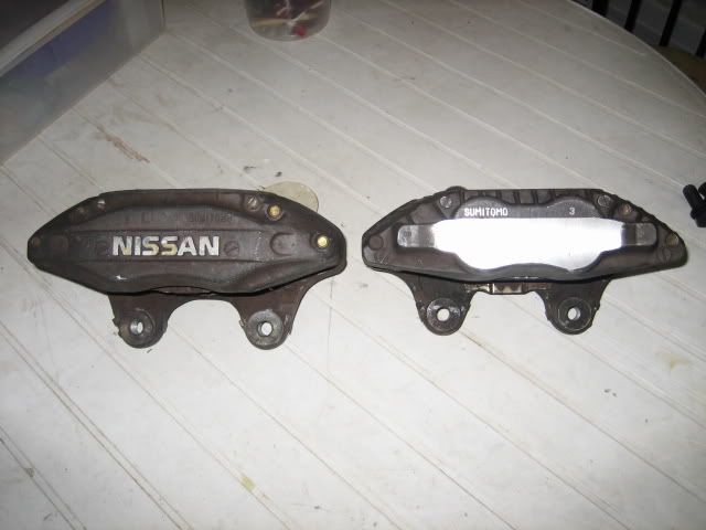

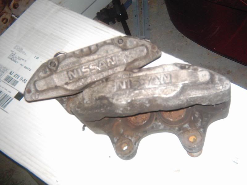

Upgraded front brakes 300 zx calipers.

Andre;947473 said:
BTW the Mk4 TT 17 inch wheels wil not clear the front calipers from the nissan you wil have to take some material of the calipers
You can also use an spacer
really??
well, i didn't think this would make a difference, but i have 1998 mk4 tt wheels, which toyota did some extra machining inside to make them lighter. supracentral has confirmed this in another thread.
because i just placed my discc and caliper and pads in the wheel and everything clears just fine. in the front ,where the word nissan is written,it comes close , but thats it!!
edit: look at post #16 by supracentral
http://www.supramania.com/forums/showthread.php?t=55852&highlight=mk4+wheels&page=2
Andre
Feb 4, 2006
115
Netherlands
marc3;948476 said:
really??
You are right they come close to the nissan letters
Now i remember when i test fit i did not have the rotors thats why the rims did not clear the calipers but the rotor its self is like an spacer so the ttrims does clear the nissan calipers
Stupid me :sarcasm:

The nissan skyline R33 GTR brembos has the same bolt pattern as the 300 zx calipers
You can Just bolt the brembos on the nighpager brackets and use 350Z track rotors
Brembos from an nissan skyline R33 GTR they must be from an GTR
Calipers from an nissan R33 GTST would fit to because they also have the sam bolt patern
So with the Nighpager brackets using the 350Z track Rotors
You can use 3 calipers
Nissan 300 ZX calipers (cheaper)
Nissan Skyline R33 GTST
Nissan SKyline R33 GTR brembos
