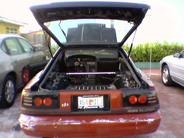

Those are all befor pictures. First went the wiring harness... the car wouldn't start because of the broken Cam Position Sensor wiring... I got a NEW Harness. I didn't like that it was running open loop, so I got another thermostat (like a dummy from pep boys). That worked for about 2 weeks then failed. I gutted it and continued on with my life. Then the Slave Cylinder stopped working. I was driving home from work and it just stopped letting me put the transmission into gear. This had all happened by the way in a matter of months. I got the car home, and decided that I was tired of all the problems. I was going to fix the whole car! :icon_mad: I was thinking, let me atleast start it daily to keep everything good. About a week into that I noticed that the brake master cylinder was empty (rear seal blew, was being sucked into the brake booster by the intake manifold) and so was my Koyo Radiator :):bhg::)

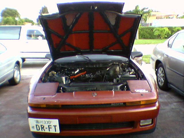

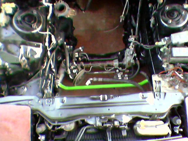

Well almost 3 years later, I present you the Following...

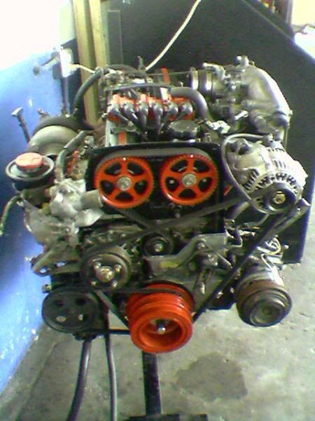

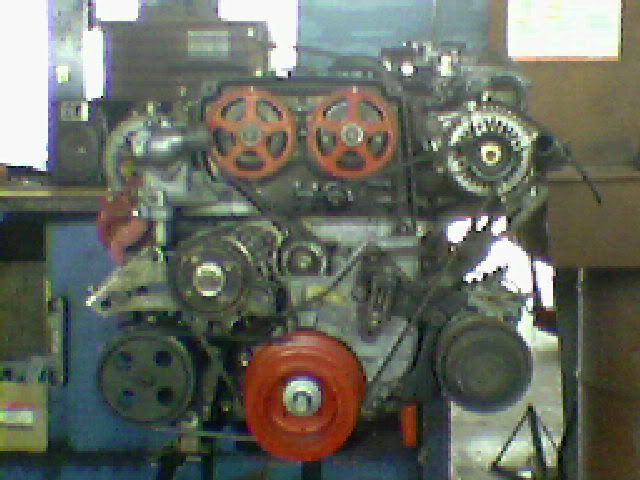

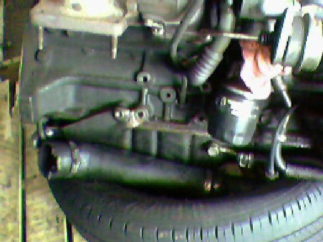

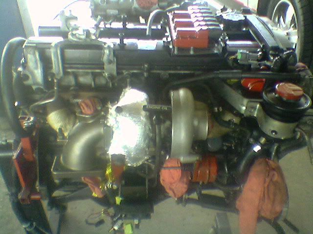

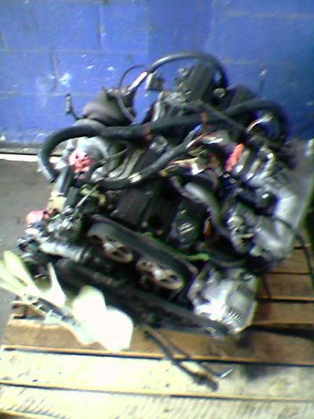

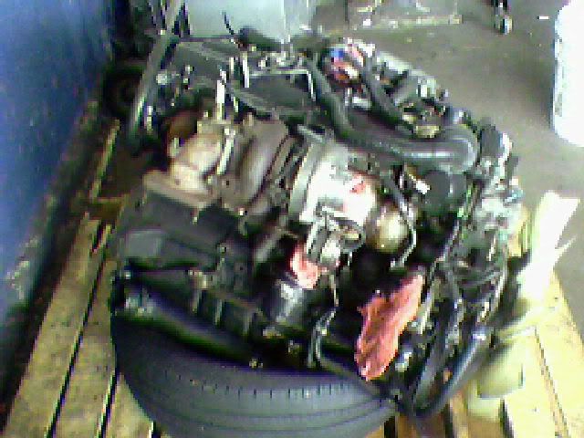

5Leater's Motor Befor.... (Thanks Man!!)

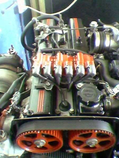

5Leater's Motor After....
Again UNDER CONSTRUCTION!!!!
Intake:
Red PowerAdder Cone Air Filter
Lexus V8 AFM
Cooleez Turbo Inlet Pipe w/ Red Couplers
Upgraded 60-1 Trim CT-26 Turbocharger
LIPP Full Intercooler Piping Kit
Red Tial Sport 50mm BOV
Greddy Oil Catch Can
Hose Techniques Red SVH Kit
Fuel:
Aeromotive Adjustable Fuel Pressure Regulator
Liquid Filled Fuel Pressure Gauge
Fuel Pulse Damper Removed
J Tube Blocked Off
RC 550cc Fuel Injectors
Walbro 255 LPH High Flow Fuel Pump w/ 12v mod
Engine:
Head Re-Surfaced
HKS 2.0mm Metal Head Gasket
Block Decked
Block Bored/Honed .020+
Cryotreated .020+ Pistons
Chromoly Rings
Cryotreated Wrist Pins
Shotpeened OEM Connecting Rods
ARP Bottom End bolts
Clevite 77 Connecting Rod/Main Bearings
8an Oil Pump Line
Rabid Chimp Braided CT26/7M Oil Lines
Greddy Timing Belt
New O2 Sensor
Cooling:
Koyo Aluminum Radiator
Flex-A-Lite 2500CFM Twin Electric Fan
SPAL PWM V3 Programmable Fan Controller
Red Samco Upper and Lower Radiator Hoses
Red Samco Full 7M-GTE Silicone Water Hose Kit
Exaust:
Turbo Blanket
DEI Exaust Manifold Wrapped
DEI Turbo Elbow/Downpipe Wrapped
Lipp High Flow Turbo Elbow
Megan Racing 3" Down Pipe
3" exaust to 2.75" Muffler
Drivetrain:
ClutchMasters Stage 3 Clutch
Heavy-Duty Reinforced Pressure Plate
Fidanza Aluminum Flywheel
1pc Braided Clutch Line
1pc Aluminum Driveshaft
OEM G305 2 Way LSD 3.73:1
Steering/Suspension:
KYB GR-2 Struts
Eibach Pro Lowering Springs
Suspension Techniques F&R Sway Bars
Megan Racing Front Strut Tower Bar
Cusco Rear Strut Tower Bar
Rebuilt Rack & Pinion
Beech Motorsports Steering Rack Spacers
Beech Motorsports Quick Disconnect Front Adjustable Swaybar Endlinks
Beech Motorsports Quick Disconnect Rear Adjustable Swaybar Endlinks
BIC Weld-On Sway Bar Link Reinforing Tabs
Brakes:
Porterfield R4-S Racing Brake Pads F&R
Braided Break Lines F&R
Slotted Rotors
Electronics:
Brand New EFI Engine Wiring Harness
HKS FCON
Optima Red Top Battery
Interior:

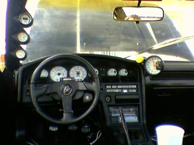

Lotek 3 52mm Gauge A Pillar Pod
Autometer Phantom 5" Monster Tach w/ Shift Light
New Upper & Lower Portions of Speedometer Cable
Autometer Phantom Boost Gauge
AEM UEGO 6-in-1 Wideband
Autometer Phantom Oil Pressure Gauge
HKS Turbo Timer Type 0
Grant Steering Wheel
EL Reverse Glow Cluster Gauges
Dojo Carbon Fiber 3 pc Pedal Set
New Black Carpet
2 Red Camlock 4 Point Harness
Titan Motorsports Harness Bar
NRG Inovations Integra Type R Replica Seats (Black/Red Stitching)
SOGI Short Shifter Mod
Engine Bling:
Zankoku Performance Carbon Fiber Cooling Panel
Exterior:
3.0turbo Grille Insert
Z31 Air Induction Hood
Tail Light Overlay
Pre 89 Euro Turn Signals
JDM OEM Side Markers
Fluids
6qts Lucas Full Synthetic 10w30 (Motor Oil)
4qts Redline Full Synthetic MT-90 (Manual Transmission)
1.5qts Redline Full Synthetic 75W90 (LSD)
2qts Redline Full Synthetic Power Steering Fluid
3 gallons Toyota Pink 50/50
