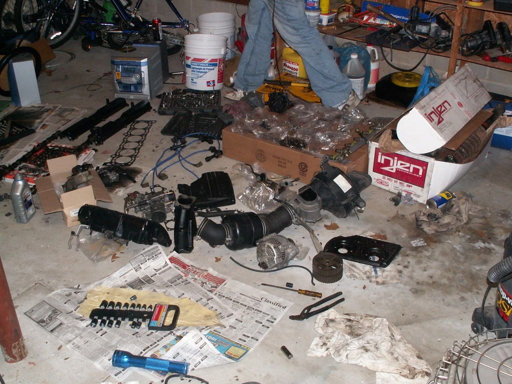

So I just spent 12 hours straight (minus a little bit for showing the '88 to a potential buyer).
Here's progress pictures:
GAY!!!!!! WTF!!!!!!!11

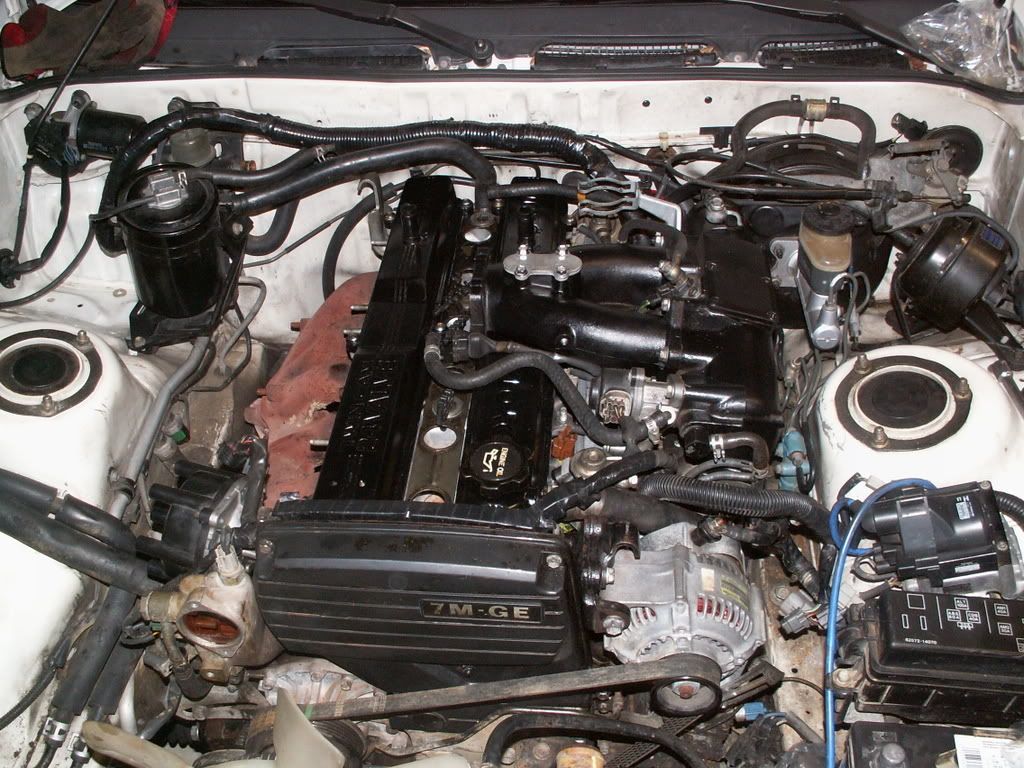

It started! Idle about 1500. I'm guessing cause of the timing. And its blowing some white smoke out that back I think. Its about 20 degrees here so its hard to tell. Gotta fix a few little issues but it started! And sounded fine!
gtsfirefighter
SM Expert on White trash
Sep 26, 2006
2,966
55
::w00t::
The smoke may just be steam since it's so cold.

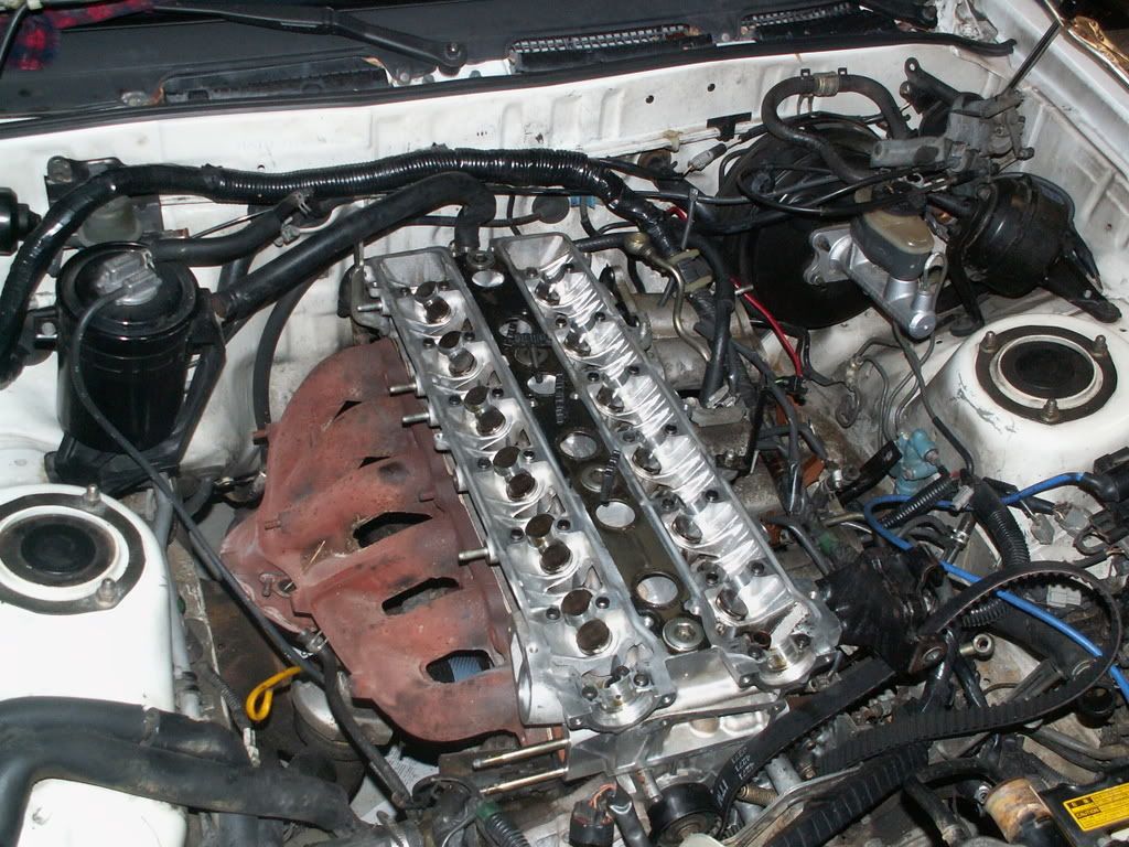

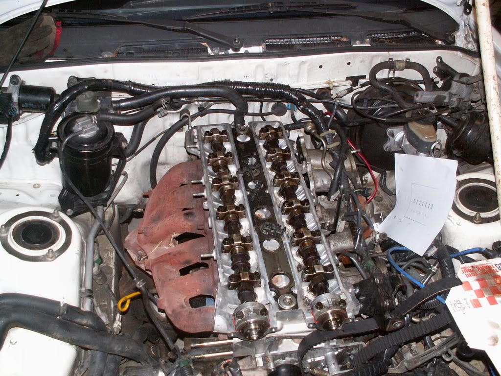

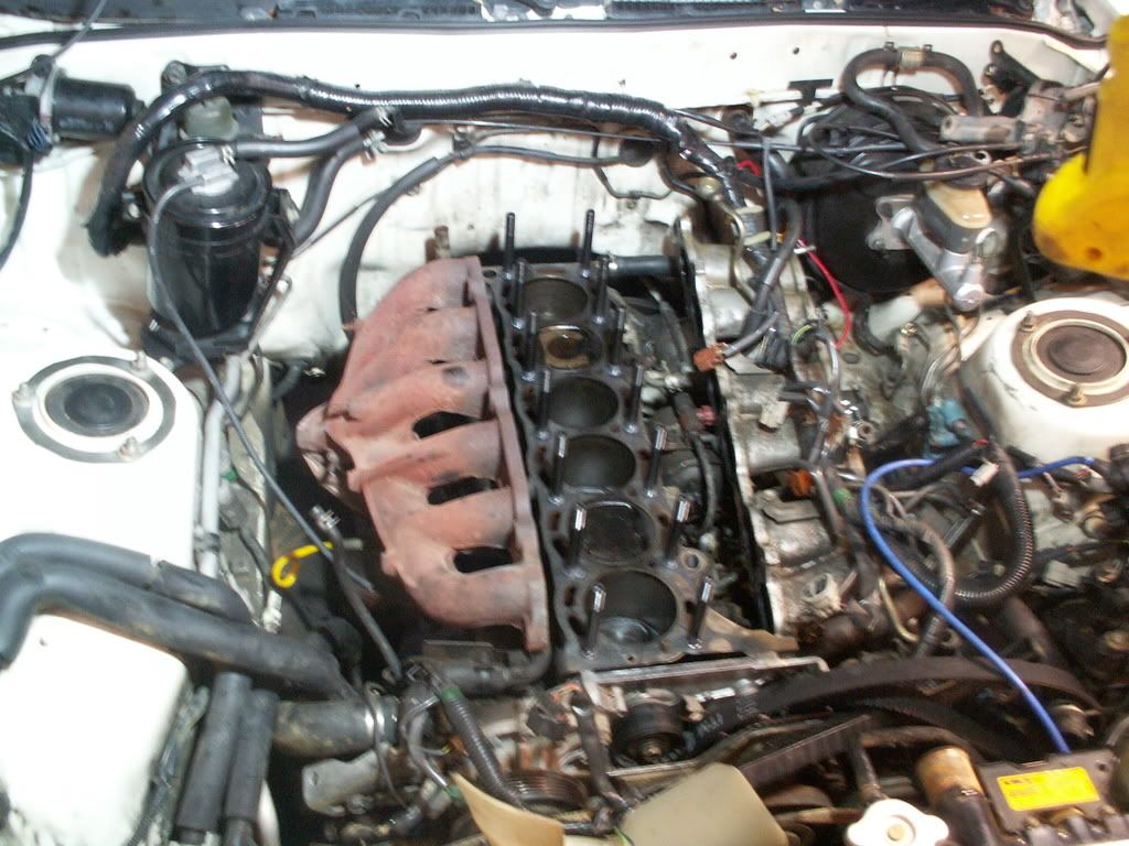

How did you get the head on with the block in the car and the head studs installed? I was under the impression that the angle the engine sits at would mean the head wouldn't clear the firewall...
MK3.0dudeman
brian L.
Mar 12, 2007
1,628
North Jersey
huh? maybe you have to move the harness out of the way a lil bit but it will slide right in place on the studs
TurboFreak
NOBAMA
Jan 22, 2006
1,374
East Coast
Wrong. There is no way in heck the head will go on with those studs installed...haha. I snapped that pic before i took them all back out. haha.

So someone school me about the afterfixingBHG process. Is it ok for it to blow white smoke out still? I'm guessing it will go away? (It still could be the car being not warmed up plus 20 degree weather but I'm just paranoid) Do I need to find a timing gun and do that jammy?
Only problems I have now are that the timing belt is a little loose causing it to come up and hit the timing cover when I give it some gas. Its not loose enough to skip any teeth though.
And my idle is at 1500 rpms.
Thoughts on these problems?

Possaibly a weak spring?
suprahooked
Built 7M
Jun 20, 2006
1,160
pa
TurboFreak;892970 said:
Nah I think maybe I just need to tighten the pulley or something. I haven't looked into it yet.
only tighten it to 36 ft lbs it might be 39 i cant remember, check the tourque specs very important not to over tighten because it will distort the #1 cyl wall.
