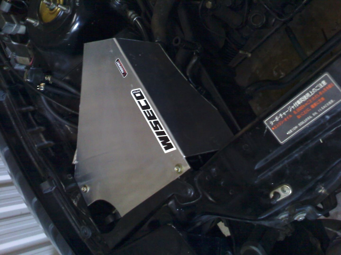

wiseco7mgt;1282426 said:Here's a pic of the airbox i made to keep some of the hot air away from the filter.
wiseco7mgt;1283154 said:Thanks Les, it was pretty easy and it's not fully enclosed, just in the places i want it to be. Shame your not closer i'd give you a hand !
