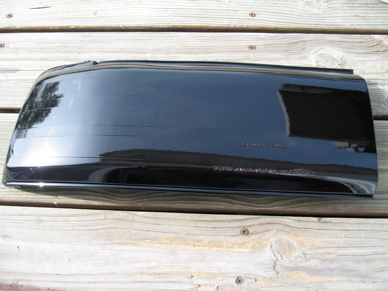

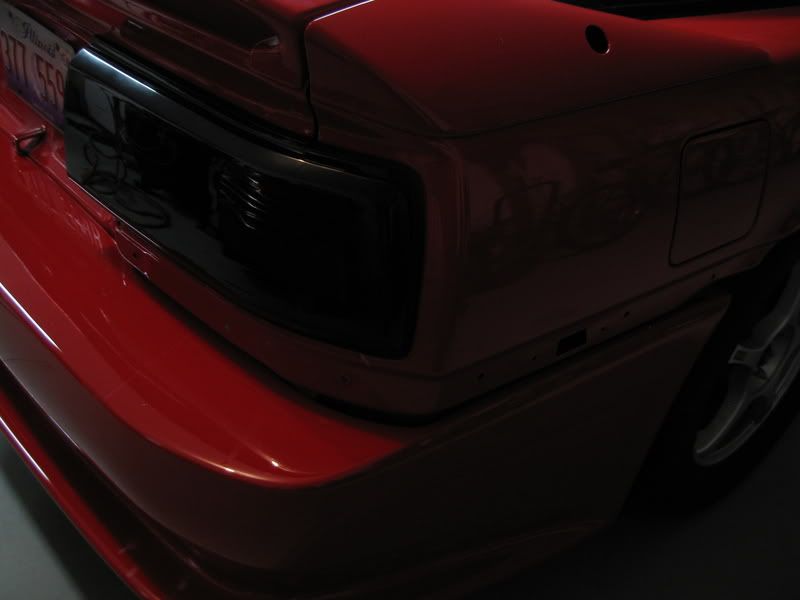

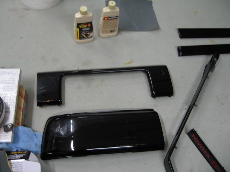

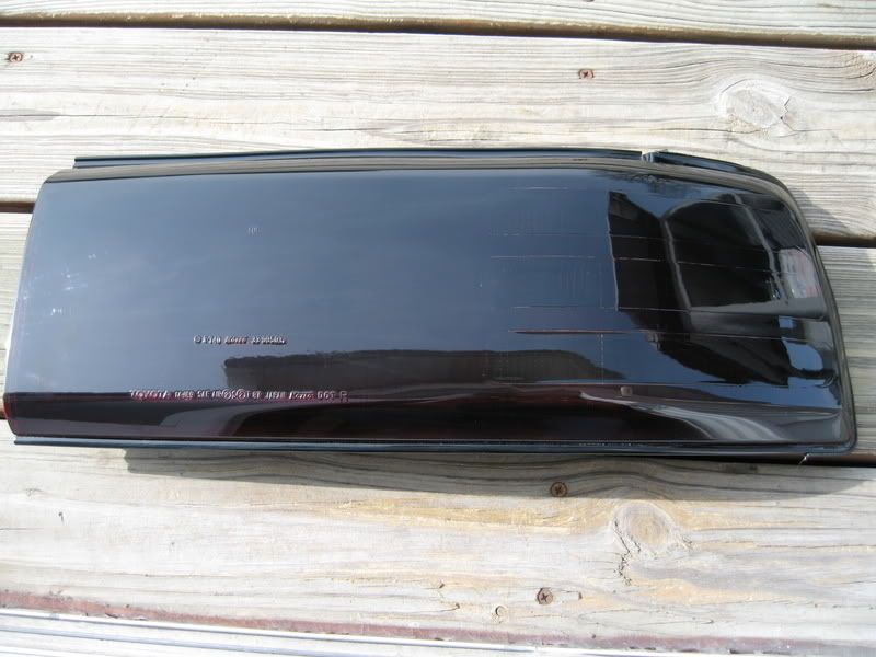

Have been slow at work last 2 days so I did some work on my tail lights and lettering on rear moldings. Here are some pics of my mad painting skilz.
Thanks to my gay blue buddy for the idea on the tail lights, and to Suprahero for allowing us to admire Vixen's rear end. I took it to much more extreme than Ryan did on Vonda's, but they look awesome. I will take a pic when they are in and lit up tomorrow so you can see that they actually still light up:)

Ryan, they turned out so much cooler than I thought!! I'll get some good pics tomorrow in sunlight. I didn't use tint like you did, I used single stage black in the dc3000 clear coat....about 3 clear:1 black. You can lay on coats ( I did 2) until it looks dark enough, then you can 2000 wet to thin it out if you want more transparency. After the 2000, buffed out with wool, and polished with foam....did all that with a little mini polisher I picked up at harbor freight. They look like they were made that way, you can't tell they are painted....it really was a good idea. Cool part is, if you get any scratches you can buff them right out with regular compounds instead of specialty plastic stuff.

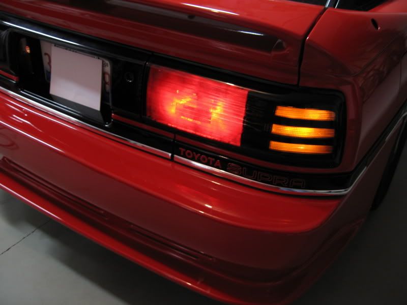

Ryan....don't think I'm doing the markers.
Duane.....sometimes I act first, think later...lol
Knightz....If I get rear ended it won't be cuz you cant see my lights, that would just be stupid....I DONT wanna get hit.
Jake.....Thanks man, got them all on today.
This is brakes and hazard.
