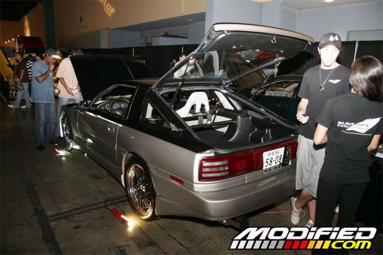

Here it is installed on my car. I drilled a hole in both sail panels so they will go in and look clean. I don't know about not trimming the interior, mine was so tight I had to "persuade" it to fit then install the sail panels.
Heres another one
http://us.st11.yimg.com/us.st.yimg.com/I/titanmotorsports_2001_335660502
I'll see if I can find better ones.
