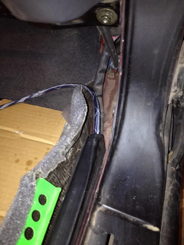

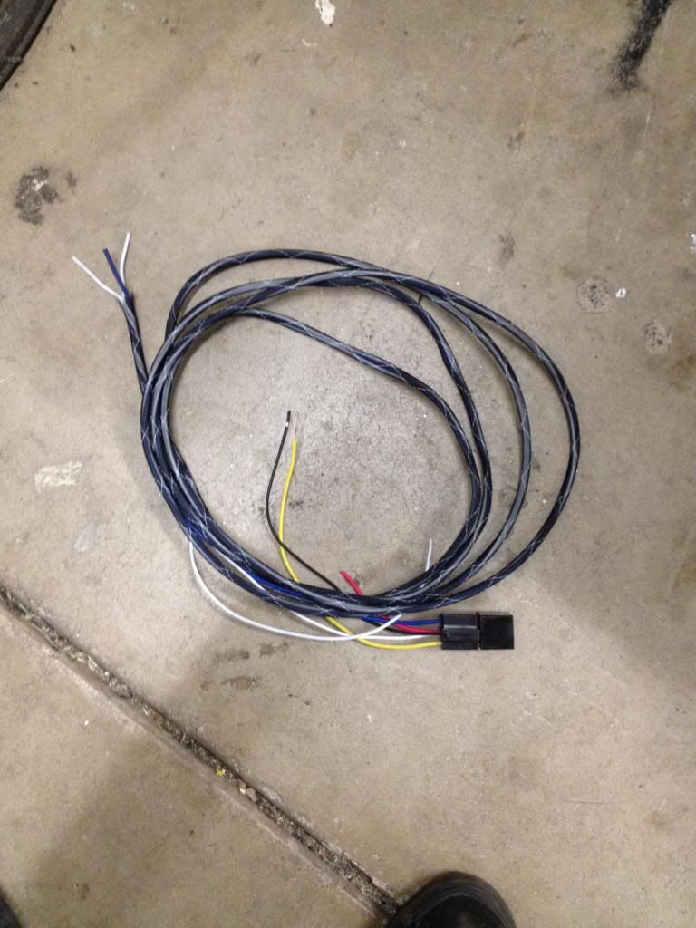

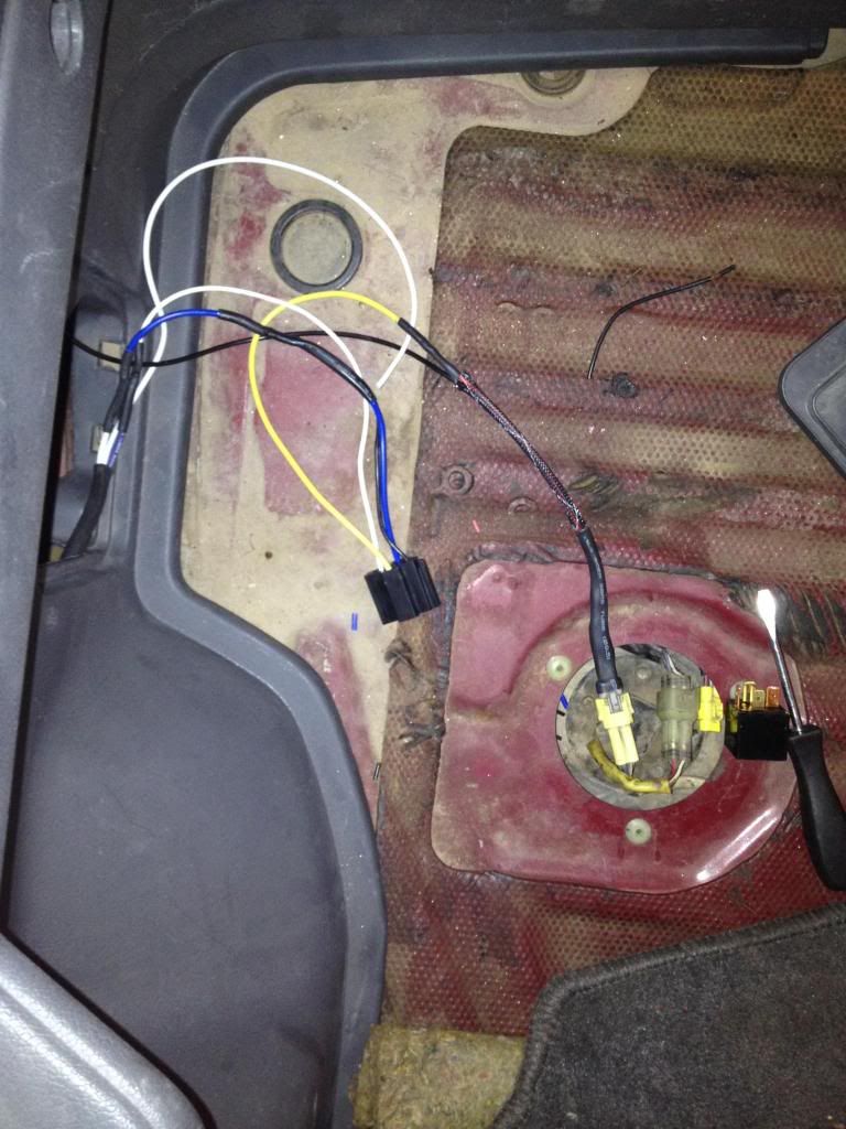

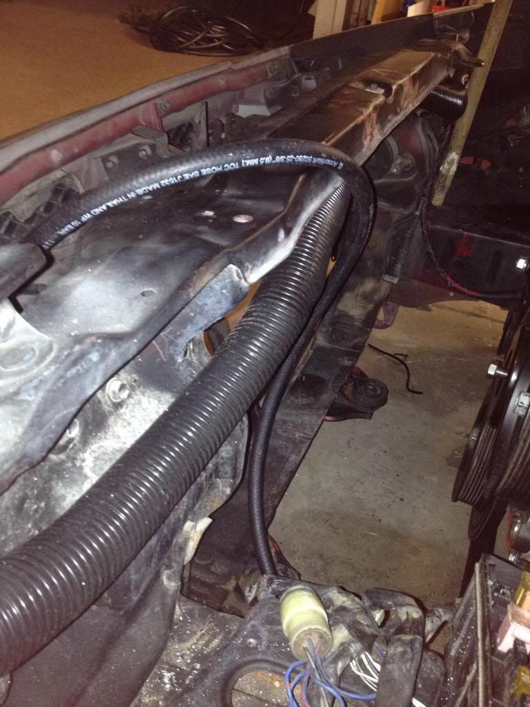

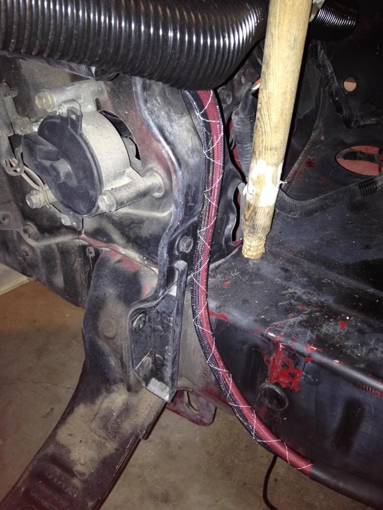

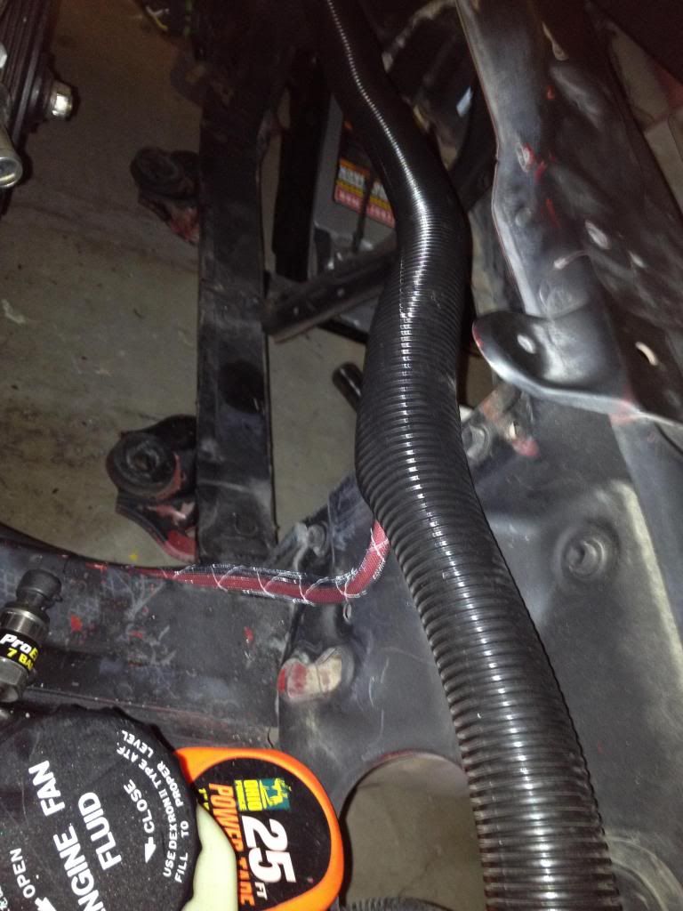

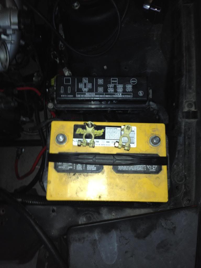

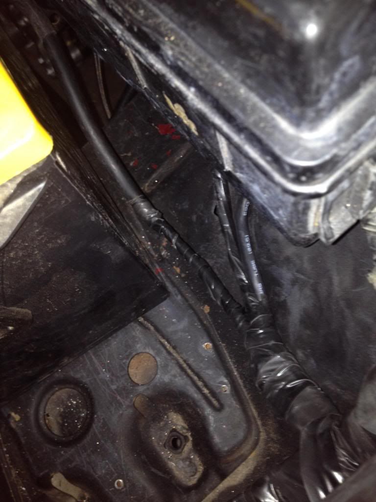

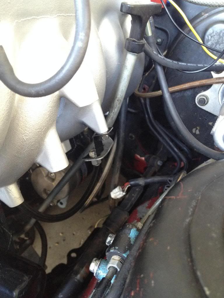

fuel pump wiring

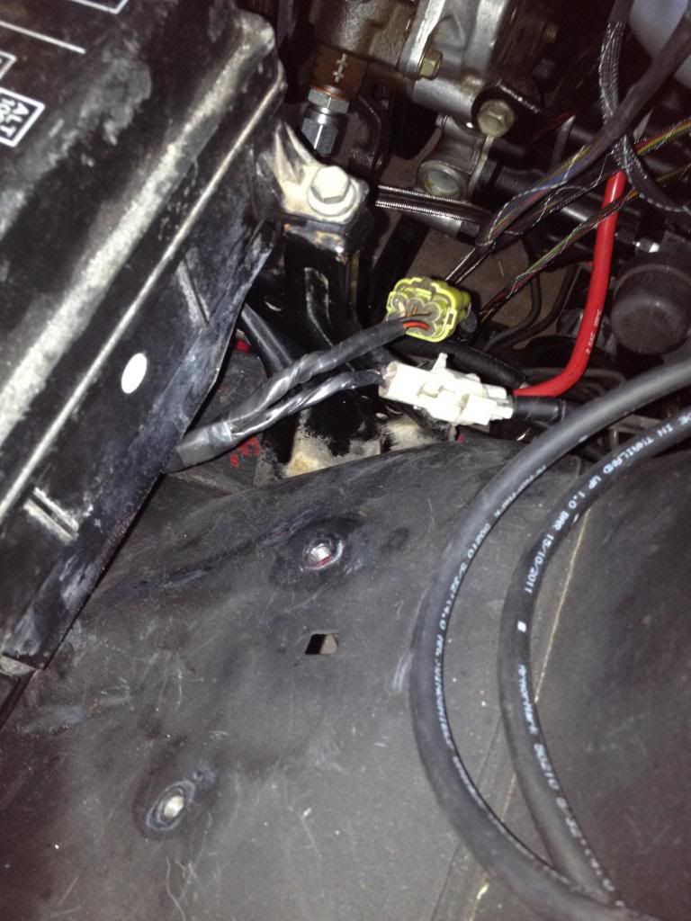

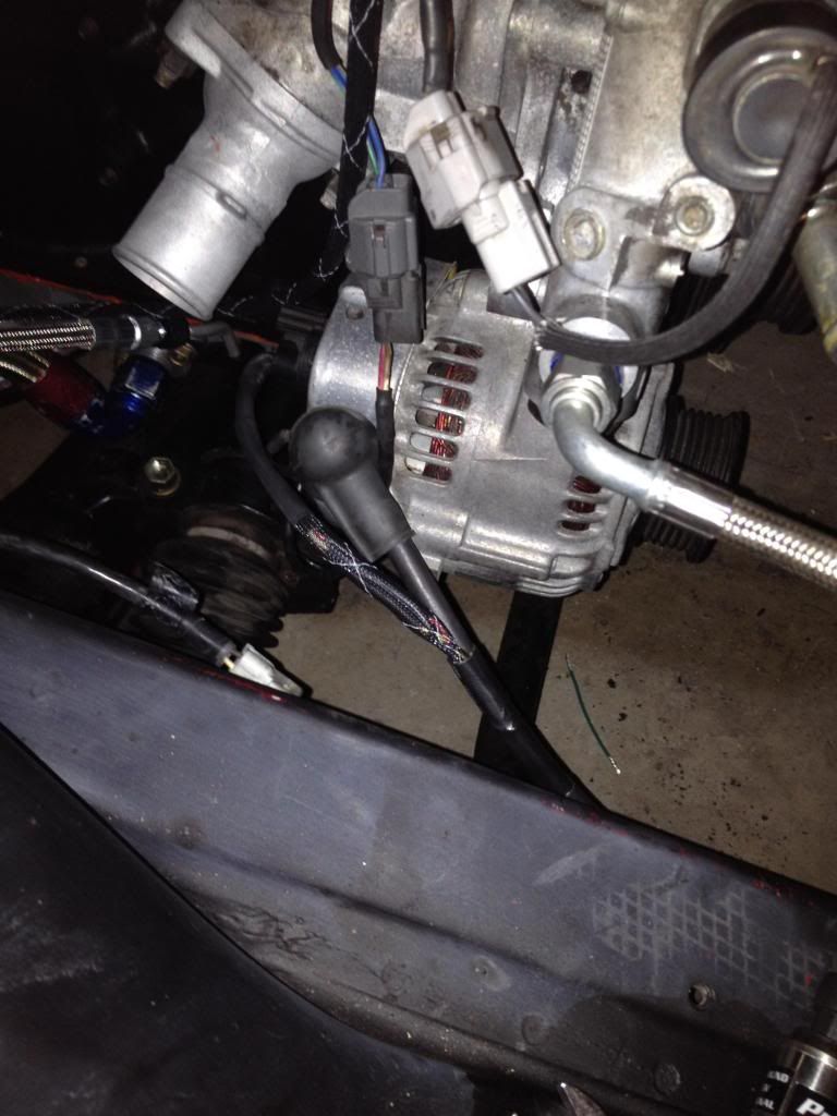

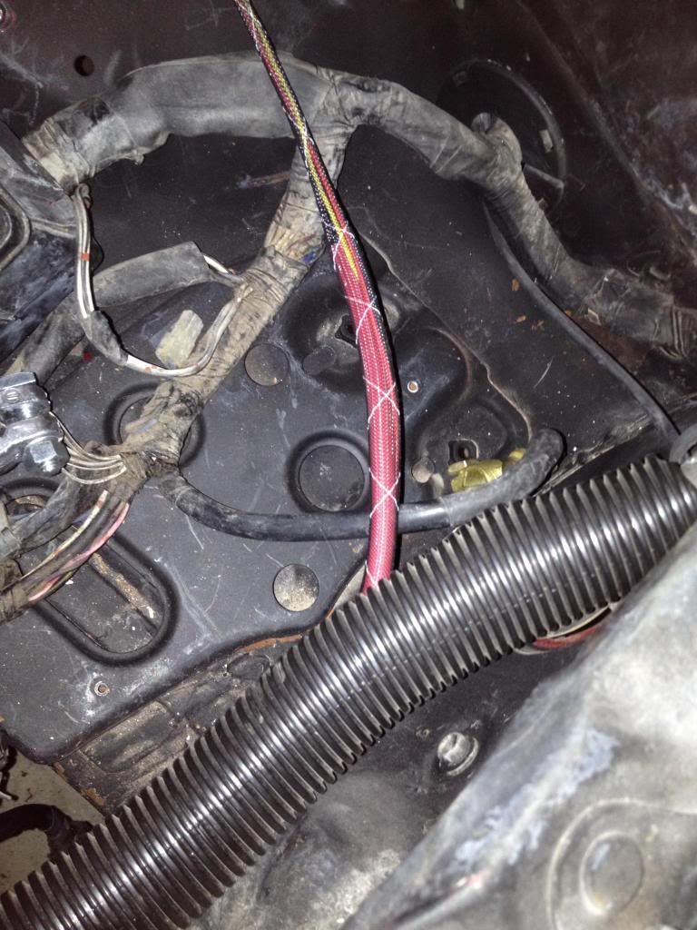

alternator wiring
update, well this weekend was full of win...

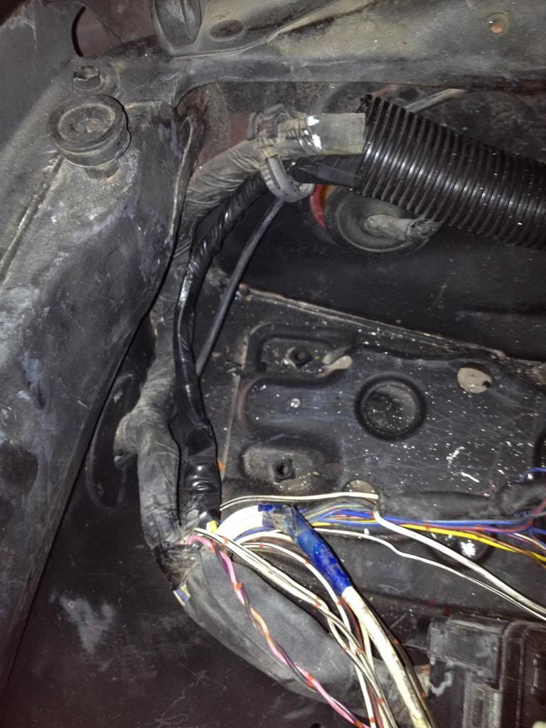

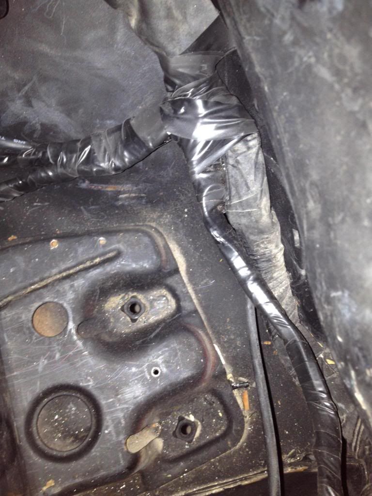

alternator / fuse box cleanup
few more things i need to go through and get rid of but its getting there

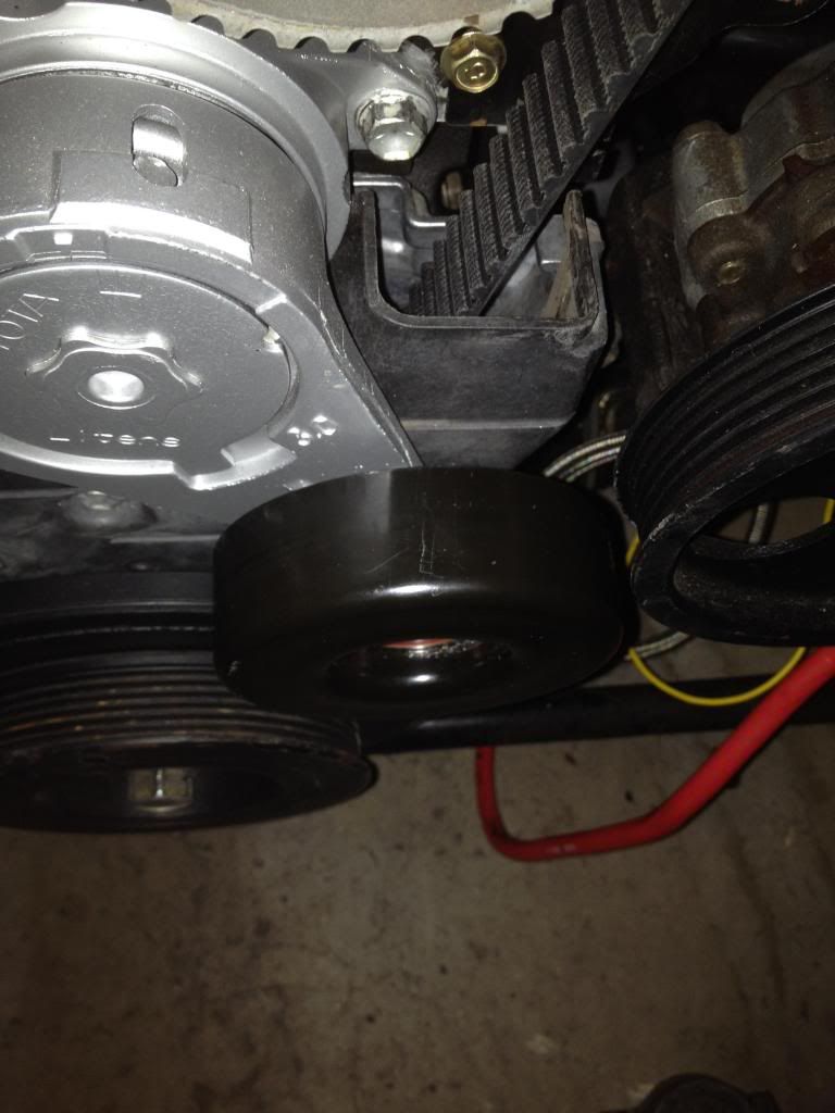

being im doing a 1.5jz and the deck higth of the 1jz vs the 2jz is different i had to make this bracket so my dipstick would stay in place

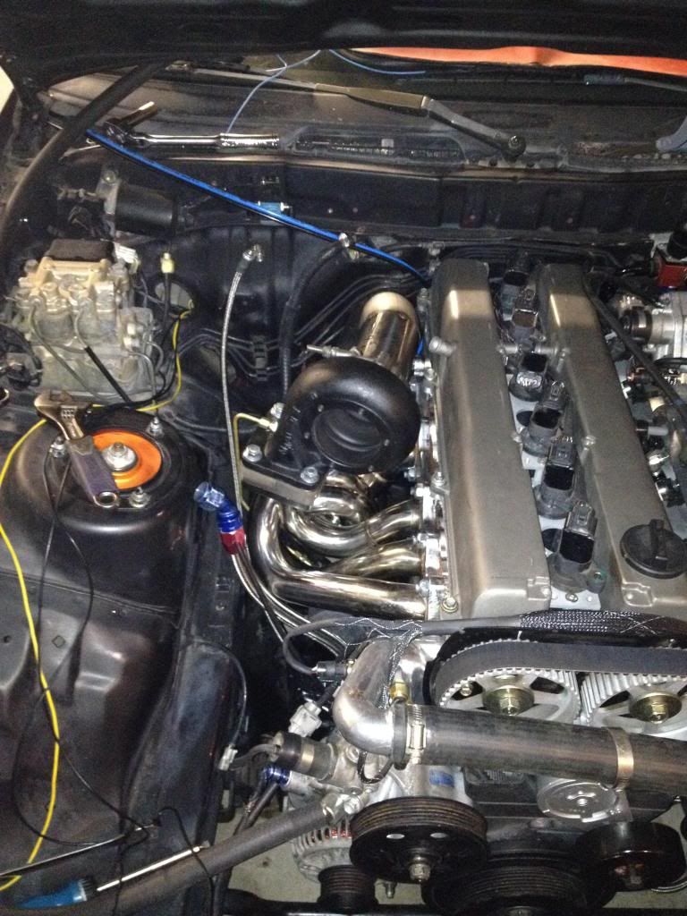

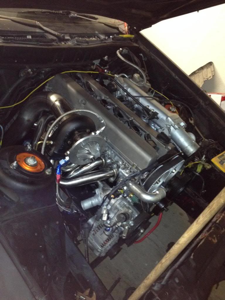

motor

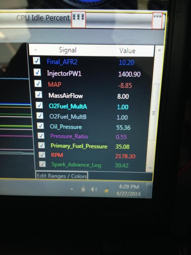

oil pressure was my main concern but looks good, will go modified 2j pump later on down the road to bump it up a bit more.

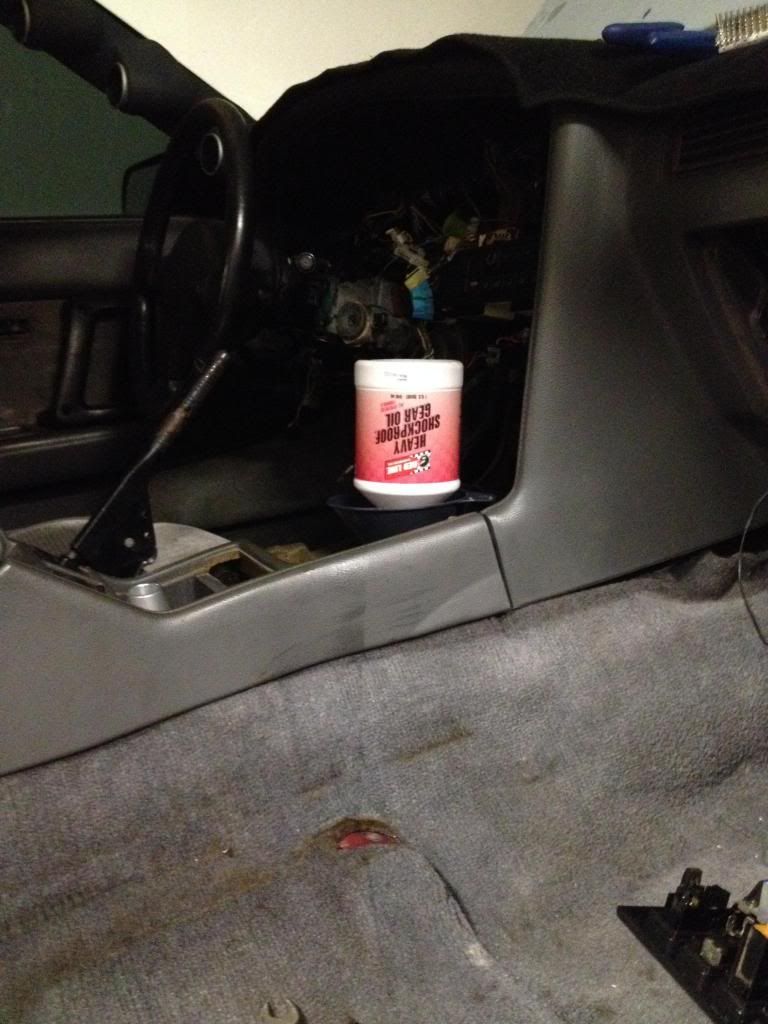

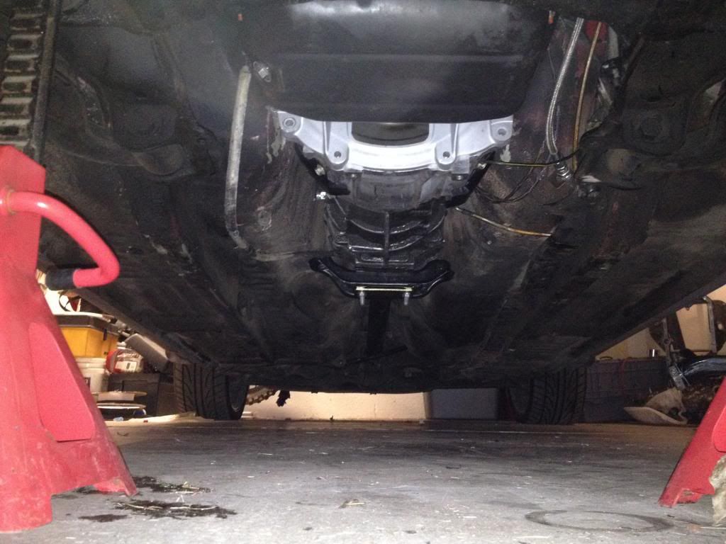

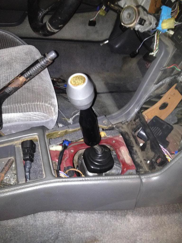

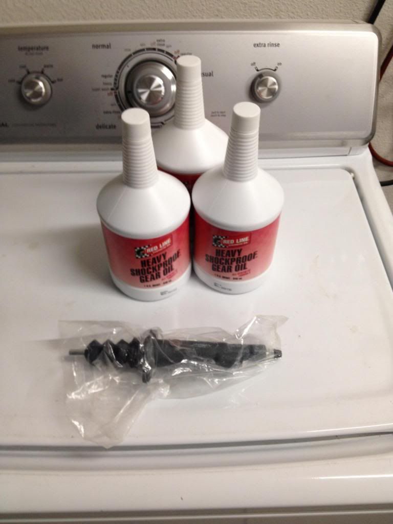

finishing up drivetrain, flushed trans with mt90 then refilled with shockproof heavy duty

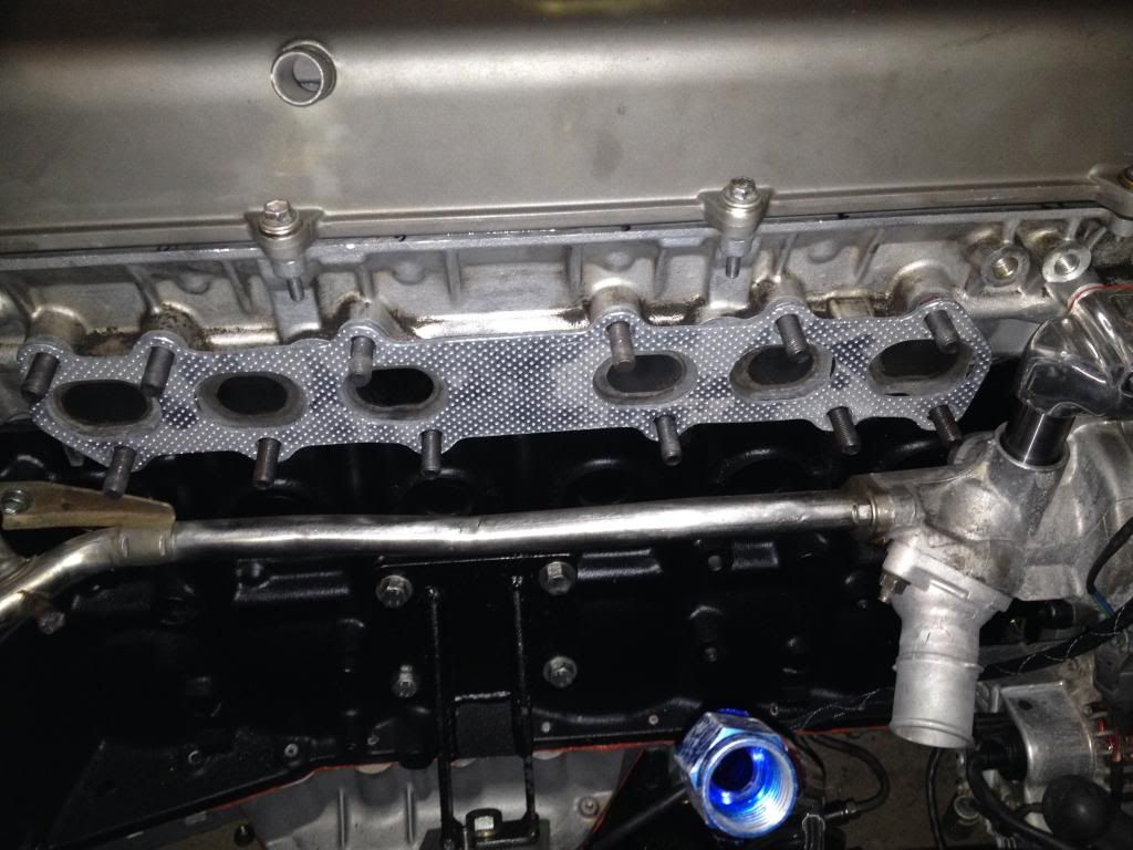

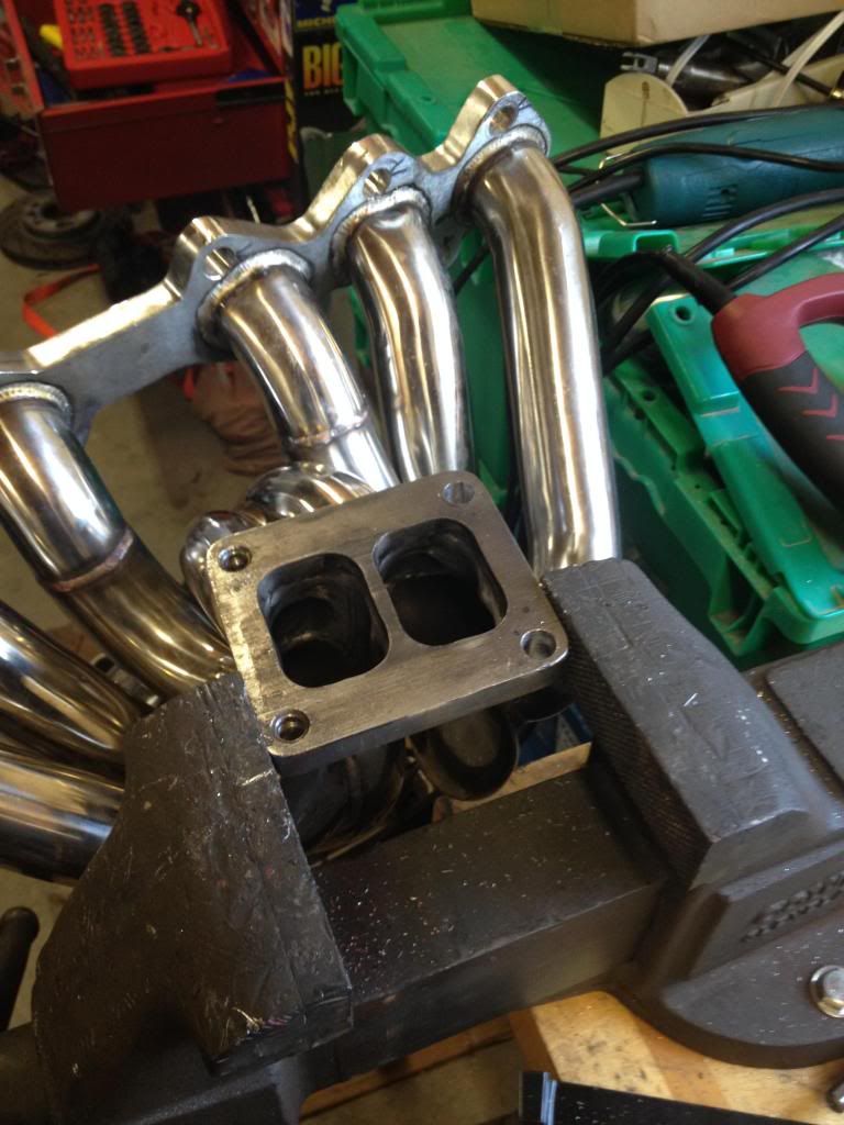

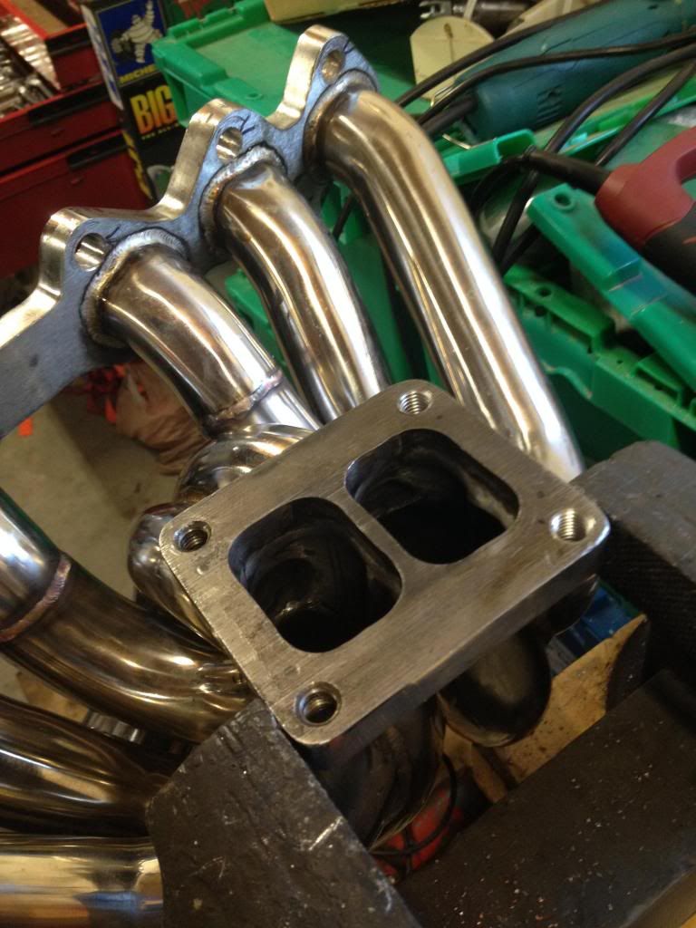

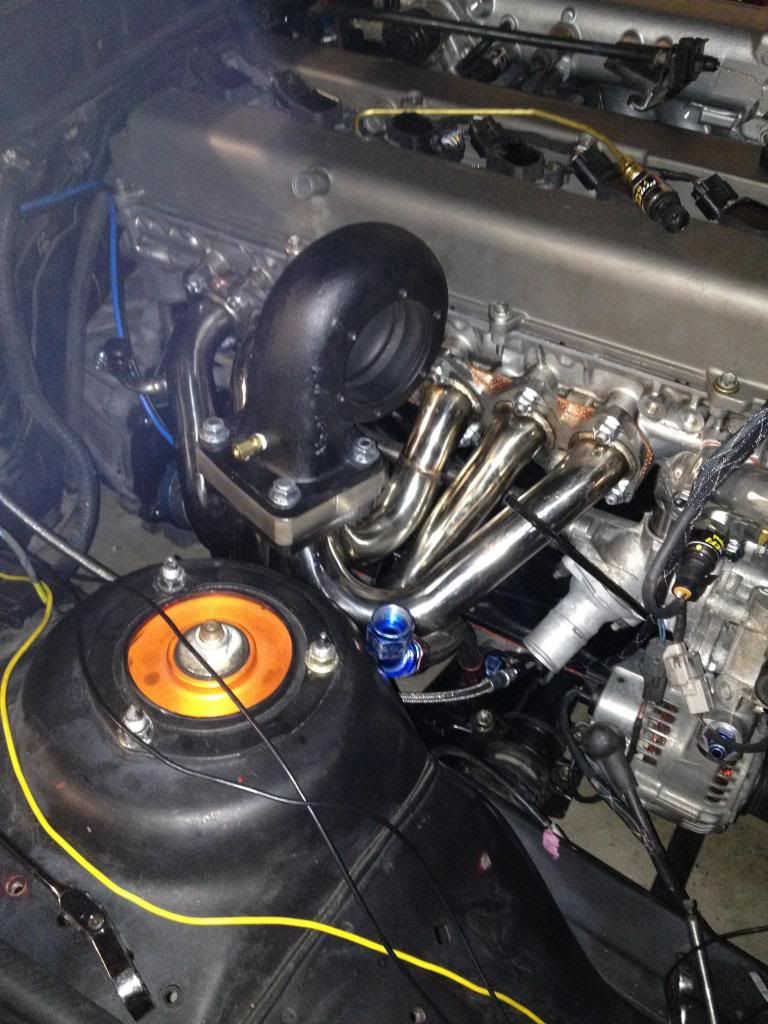

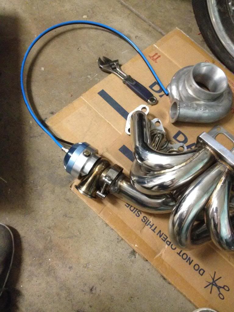

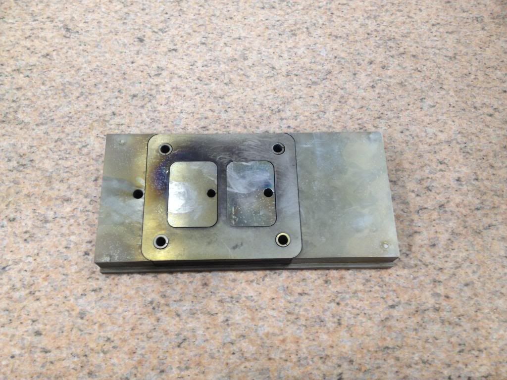

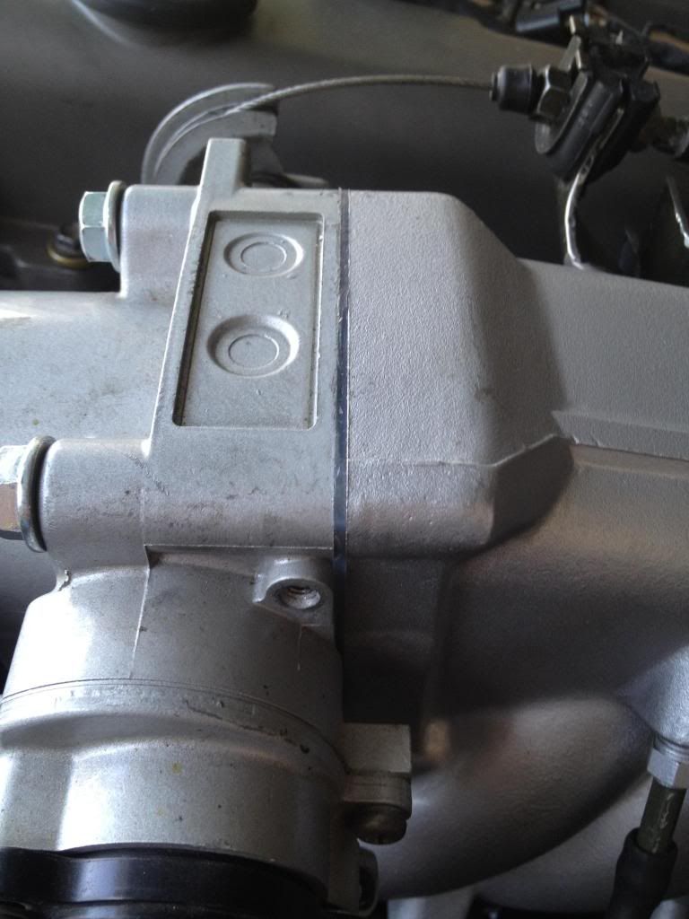

manifold fixed finally and bolted down 100%

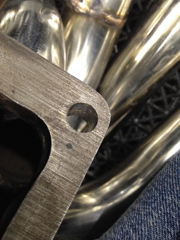

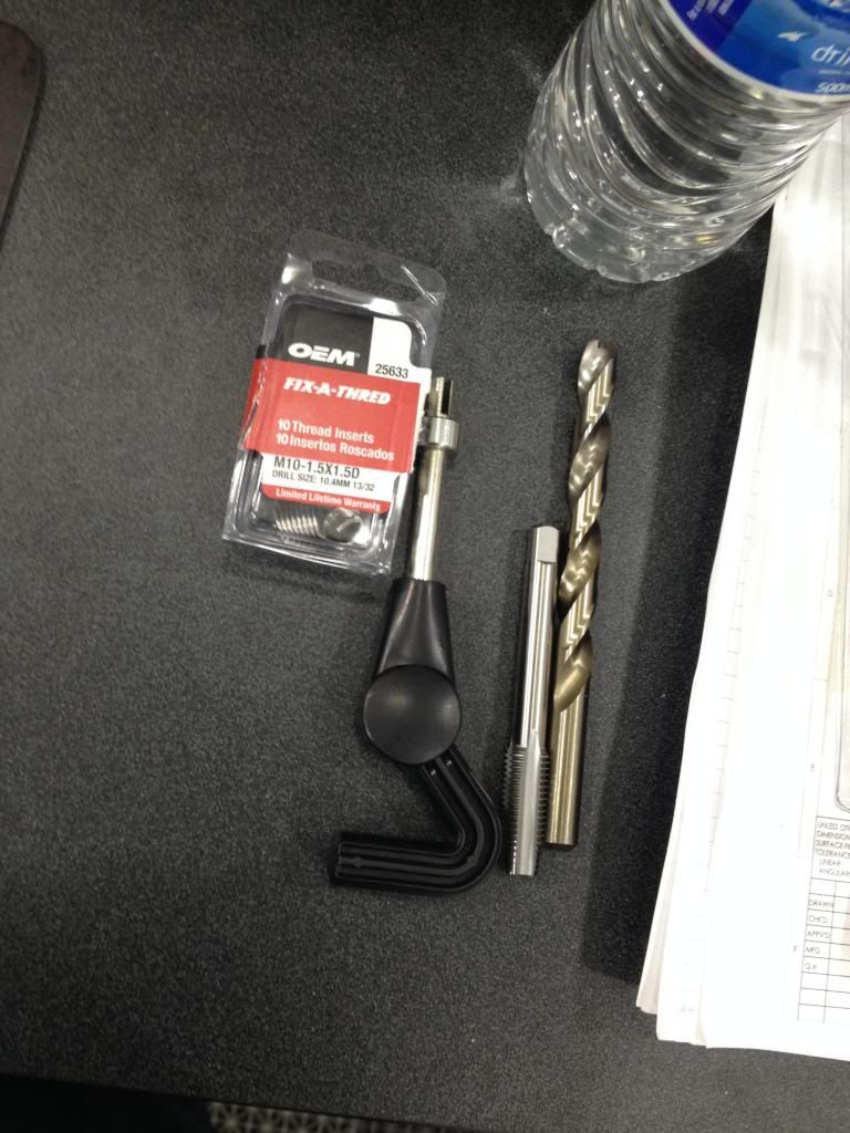

missing threads
drilled
tapping holes for helicoil
done
couldn't find oe gaskets so i have to run this for now but am still looking for oe gaskets
studs

as you car hear its missing on cylinders 3 and 4. still not 100% sure whats going on, checked coils and am getting spark and the fuel injectors are clicking as well. next thing im going to check is the physical timing on the motor to see if its just set way out or something.

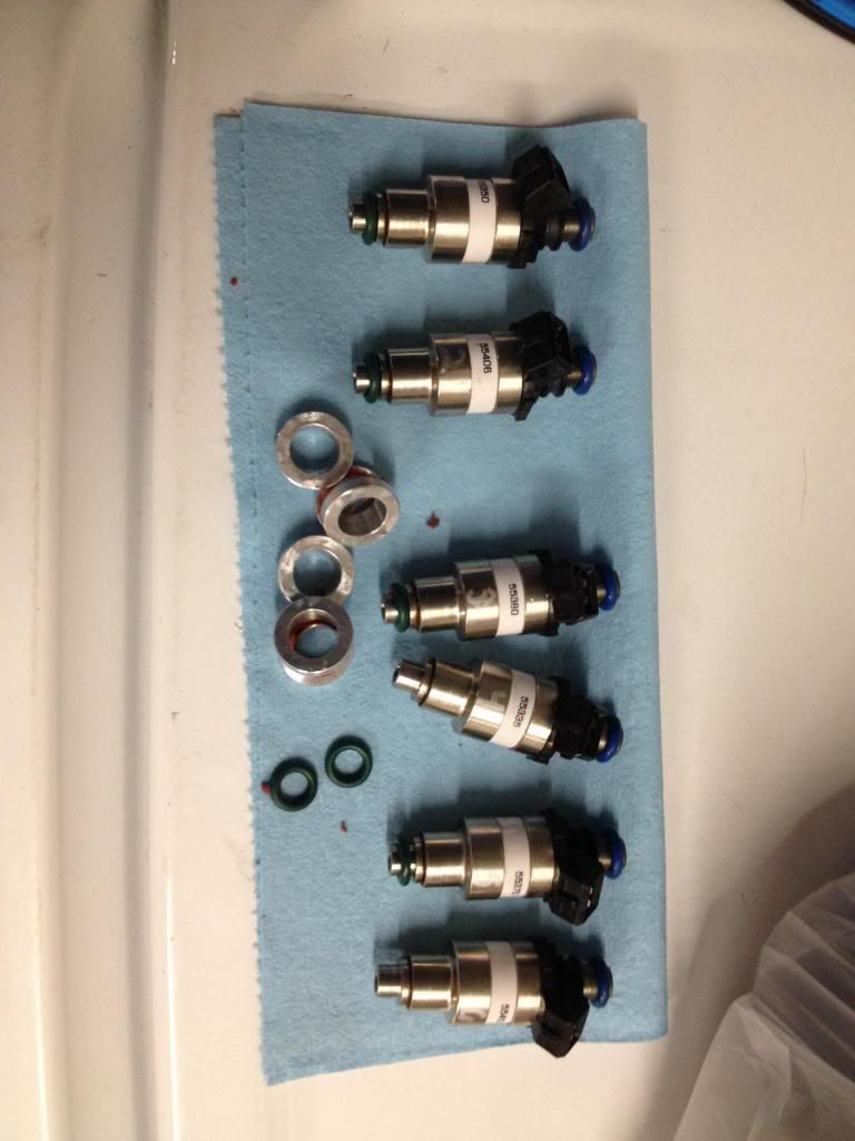

well lastnight i went to harbor freight and picked up a spark tester so i could 100% check that spark wasn't my issue. I also did a quick compression test on cylinder 3 (one of the ones thats not firing) and it was above 145 on a bad crank so i ruled that out, by bad crank i mean low volts 11.64 to be exact and only turned over maybe 2 full revolutions before the battery was too low for cranking. only comes down to one thing left and its injectors...
injectors out and ready to get sent out, hoping to drop them off at 11 today and get them back today as well.
