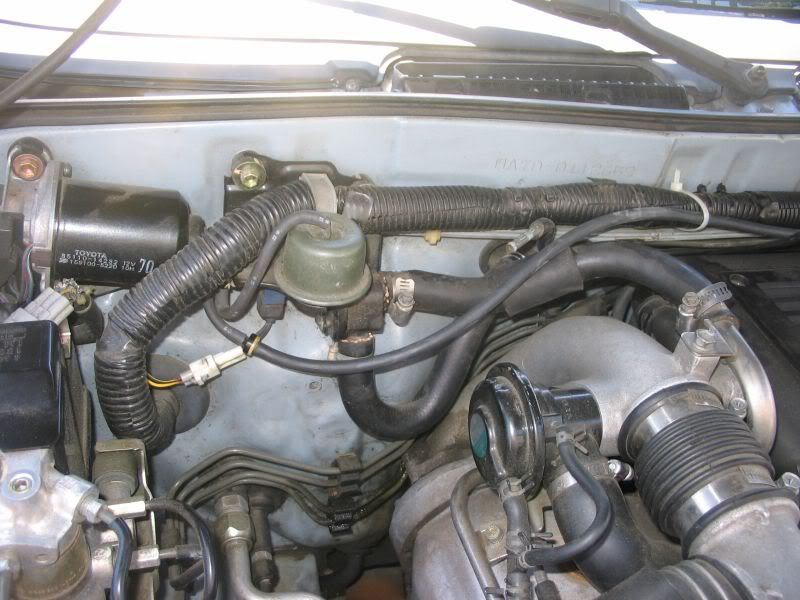

At first what I thought was a climate control problem, may just accually be a VSV/ heater valve problem.
At the moment I am trying to see how my heater valve and VSV are properly supposed to be plumbed, particularly on a 1jz. As it sits, I have constant vaccum on the valve, which gives me REALLY hot, or hot(ambient)

I would still like to plumb it correctly, as when I bought it, It was totally unconnected other than coolant lines., And I needed a defroster, so I ran a vacuum line from the top nipple, to the intake manifold to give myself vaccum, and now i'm stuck with heat!
Once I get it plumbed correctly I want to test the VSV via the climate control, and if I confirm it works, Then I can assume the heater valve is not working.
If the VSV isn't working, I can try a new one, but I may just jump straight to the My wiring harness is FUBAR :[

Vacum from the intake goes to the vsv unit - The little square electrial unit at the bottom , Into the port facing towards the drivers side. There is a small hose that comes out of the bottom of the vsv unit nd plugs into the top of the bigger round cannister/valve thingy.
As it sits, you have direct vacum applied to the cannister thingy. ( this keeps the hot water flow open at all times.)

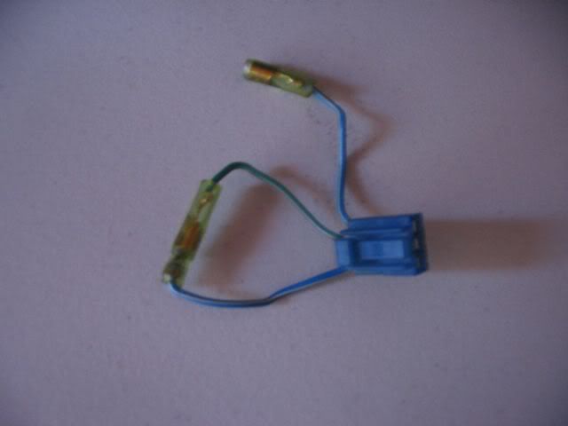

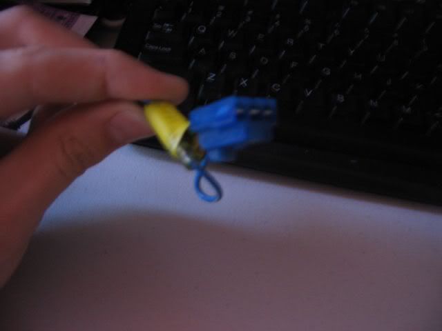

Is this the other side of the plug I am looking for?
My glovebox is out, I can hear a flap moving when i turned it down from 85, And I visually confirmed my recirculate air flap is working. It seems as if the VSV is completely bypassed, So my next stop is probably to grab a foot of vac line to plumb it back in, corectly, while my main concern is this damn plug.
tissimo
Stock is boring :(
4,238
Melbourne, FL
yes thats the plug.. I dont remember the pinning.. but look under the center of the dash you will see the mixture control servo, you need to verify that its in the proper position...

Okay,
Plumbed in my VSV, No change in heat or cold(not very noticeable.
I went to each extreme on the scale, and the arm was in the same position on the valve.
I may go pick one up from Suprastanger507mgte later this week, and Hopefully I can get some chilly air!
