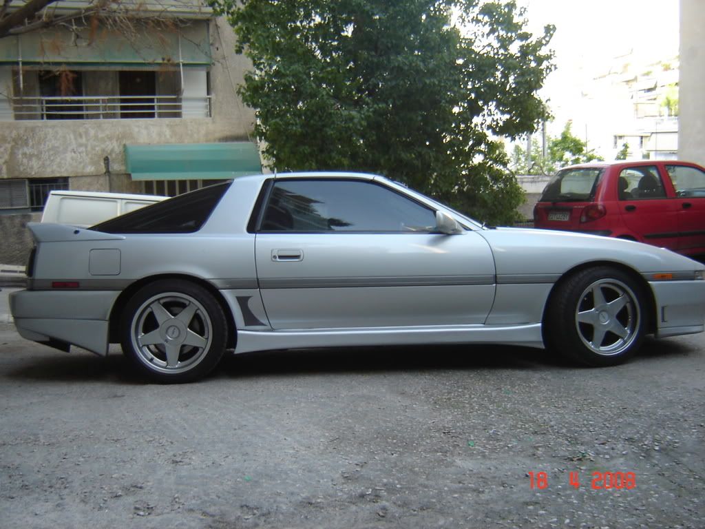

Racer-X;1295877 said:
Love those AZEV A rims! However, you should have cleaned them a little...
:biglaugh:...The picture is about 6 years old. It was made rundomly on the
street. I do clean and wash my car every week...:sarcasm:

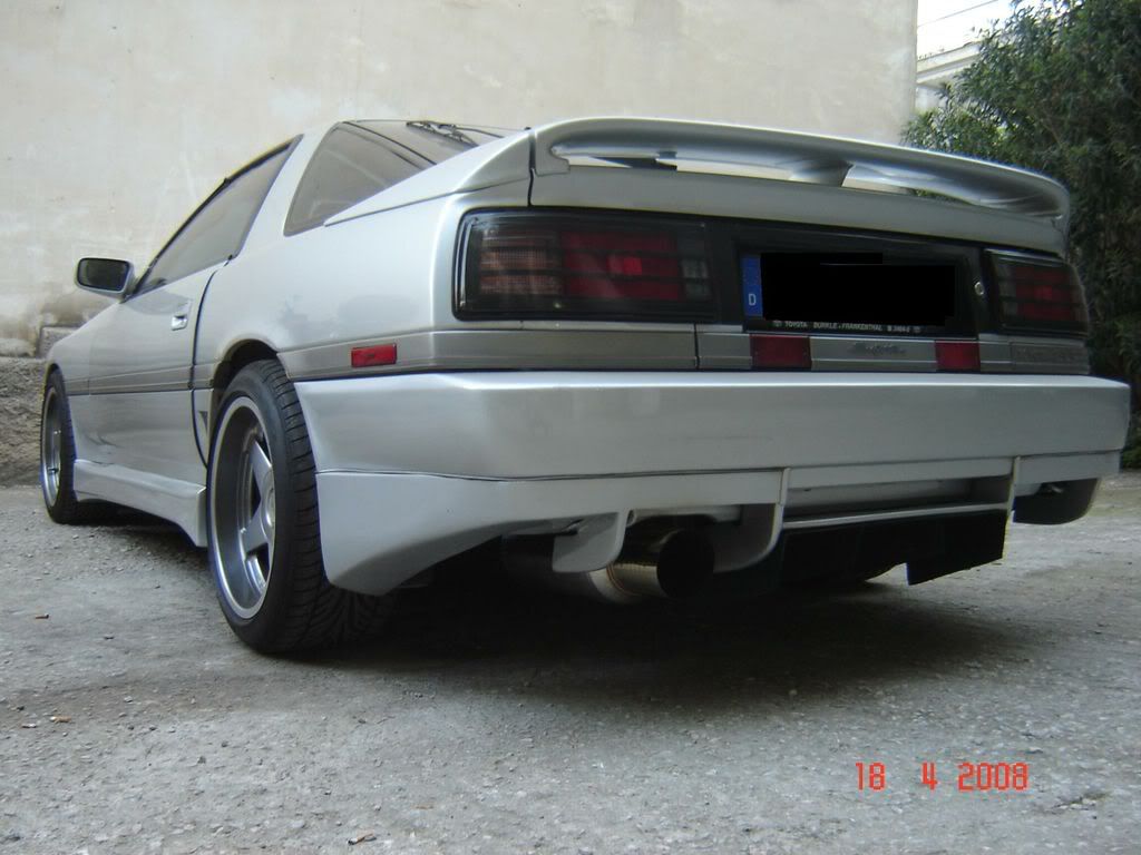

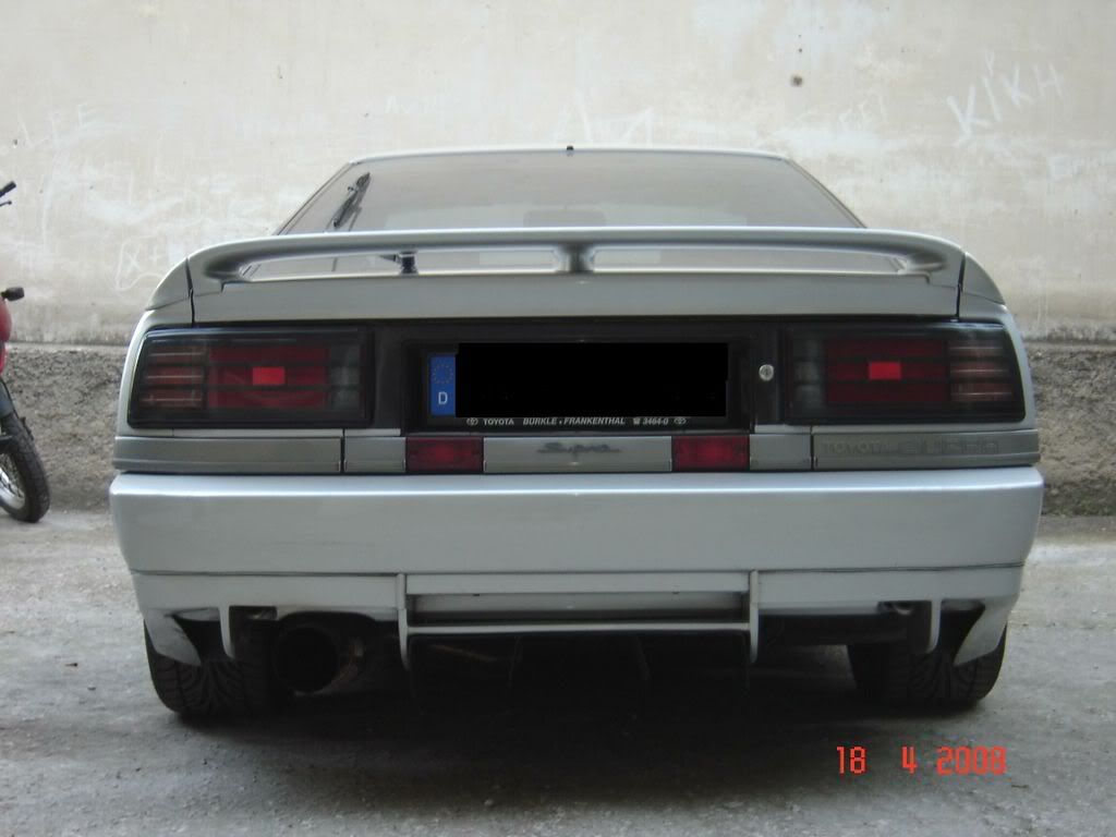

akito;1296139 said:
IS that a stock rear defuser??
No...:nono:
It is a 'Regulus' rear under spoiler....custom hand made since Regulus stopped
making body-parts in late 90's :icon_mad:
But yes...it has a rear black custom made FG diffuser in the middle section!

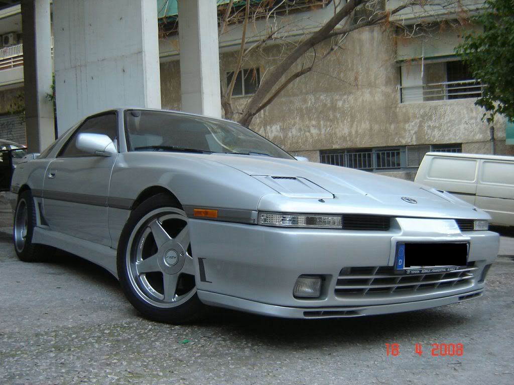

Next on my story...:sarcasm:
Lowered my car with eibach pro kit springs and Tokico IIs for TEMS.
Put new disc brakes allaround and rebuild the calipers.New pads also,and
LIPP (jdm) stainless steel braided high pressure brake lines.

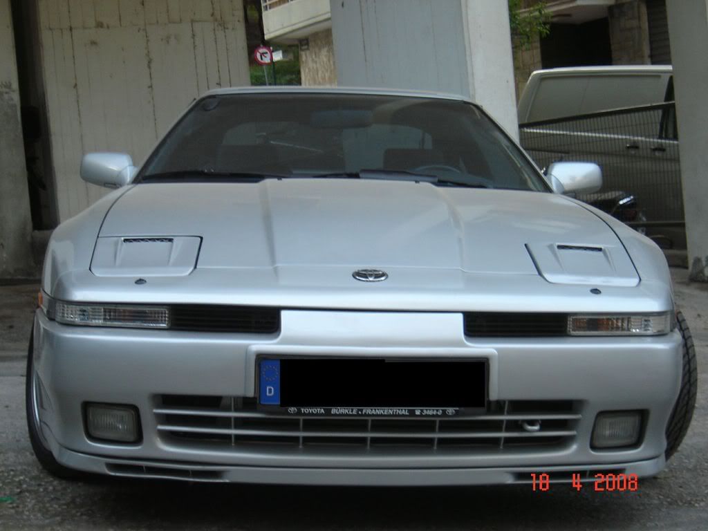

I installed some exterior parts:
# Regulus rear under spoiler
# Bomex side skirts
# Painted the stock front bumper grills black along with the
stock JDM spoiler lip (which has the air vents for the front brakes)
# Added rear carbon covers on the rear lights and middle section,but
still kept the stock rear fog lights.
# Added the US spec side markes and it's moldings .
# Tinted the windows all around 36%
# Installed a 3rd brake light on the top of the rear hatch.
# Clear/lexus style front turn signals (which I've mentioned it before)
# Clear crystal lenses on the front pop-up lights
# 8000k HID lights (xenon) into the pop-up lights
# Aero fiberglass headlight covers with vents
# Rear diffuser
Here are some pics.:
Just to mention,front grills are painted black now.The picture is quite old...
OHHHH...and the rims are super clean !
The car with these add-ons changed it's appearance and looked 3 times better!
And haven't put on another (aftermarket) bumper :biglaugh:
Also,the car was re-sprayed (painted) with it's original toyota silver colour,code 176.
And the rims were painted in grey (metal) silver colour,and now they shine more!

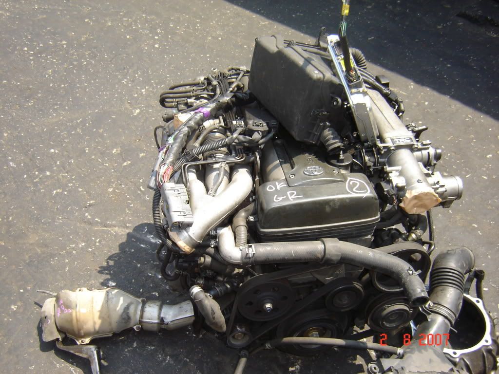

To continue my story......
After I fixed my car and was running ok....I lost compression on 2 cylinders.
Anyway to make a long story short,I sold the 7M-gte with all the aftermarket
parts (turbo,fuel kit,intake,IC) to a guy tha he was willing to start a mk2 7M

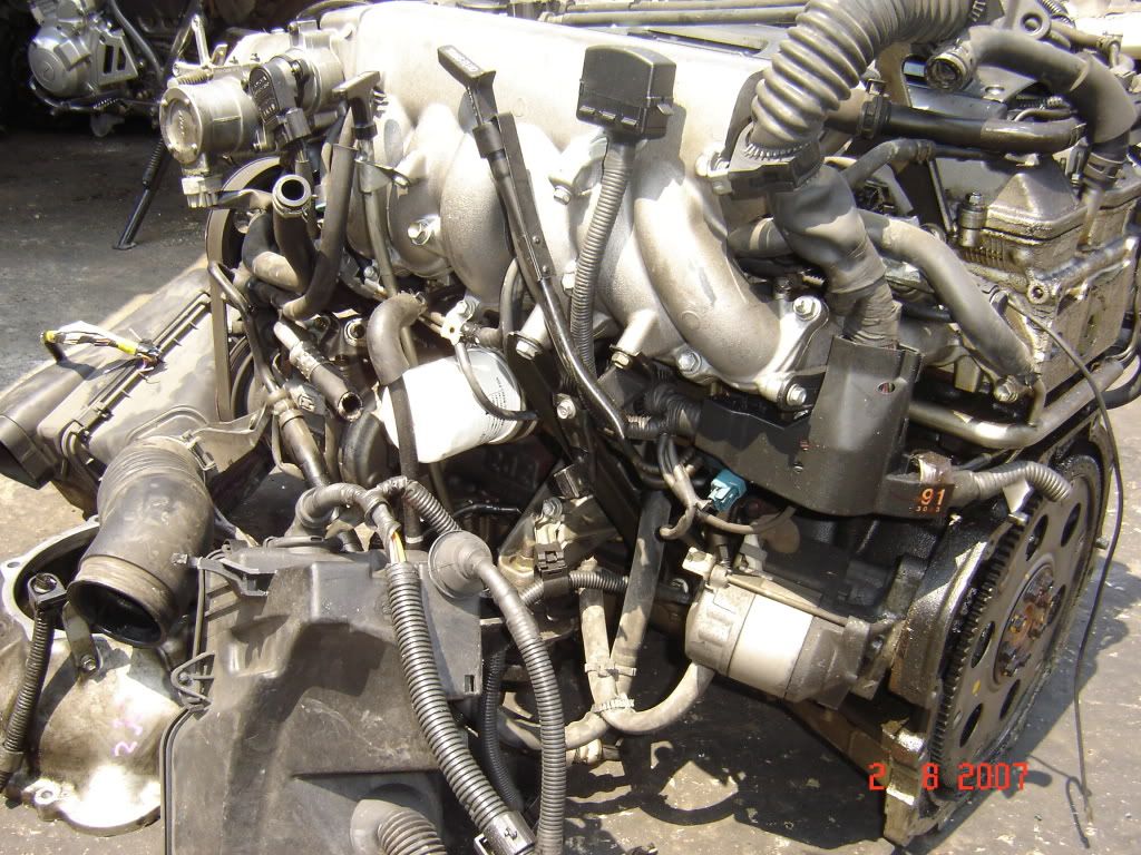

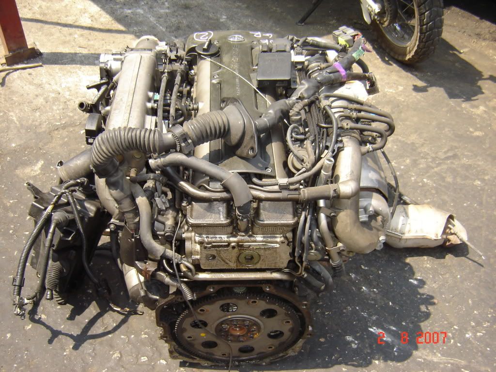

project :sarcasm:
After 1 month of searching I found this 200 miles away from my home...
went there and bought it: 2jzgte (aristo 60K miles motor)
And the mk3 2JZA70 project had just began :biglaugh:
Start buying a lot of Toyota parts & some aftermarket ones for my
JDM 2jzgte engine (checked main bearings,rod bearings...all ok)

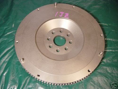

- ACT heavy duty clutch/single disc

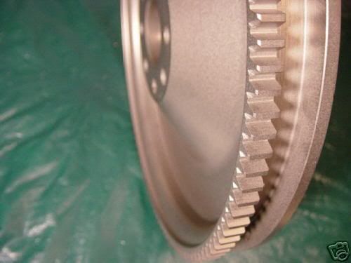

- Jun lightweight 1jz flywheel

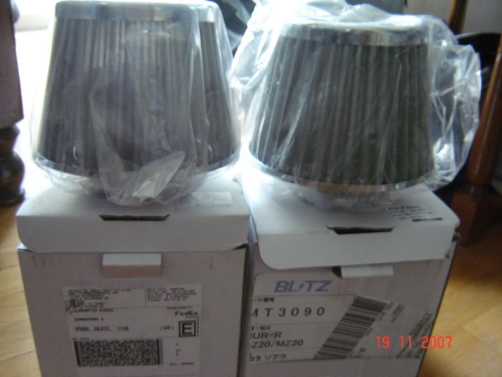

- Blitz SUS x2 air filters /w custom polished aluminum intake pipe

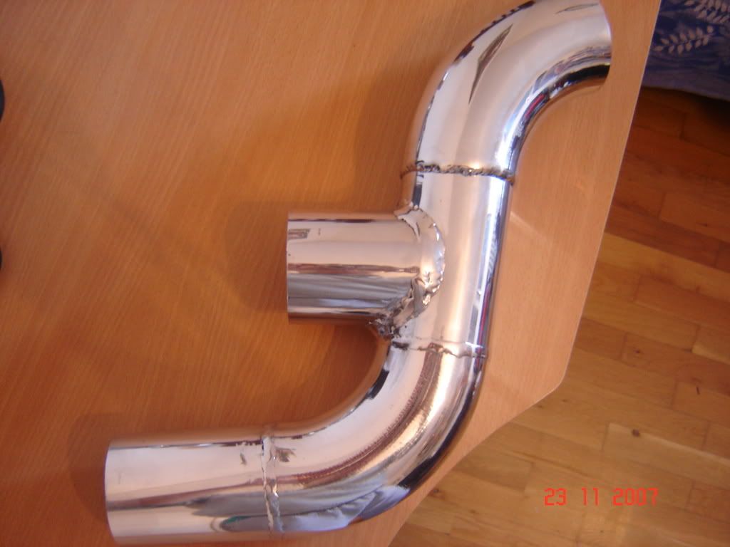

- Custom polished aluminum intercooler pipes

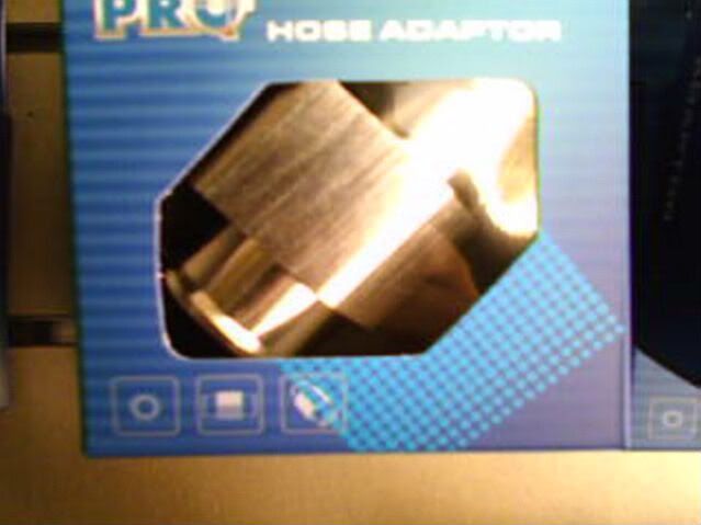

- Pro x2 hose adaptors (for coolant temp.valves,for A/C,elec.fan,gauge)

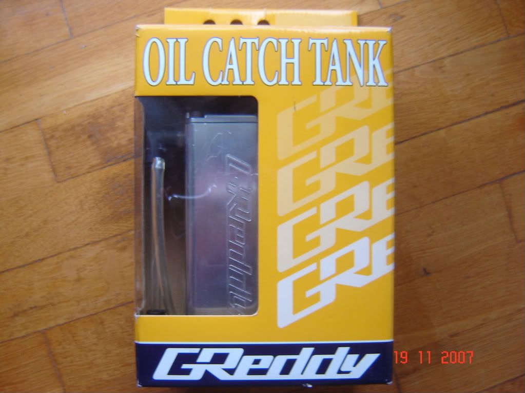

- Greddy oil catch can

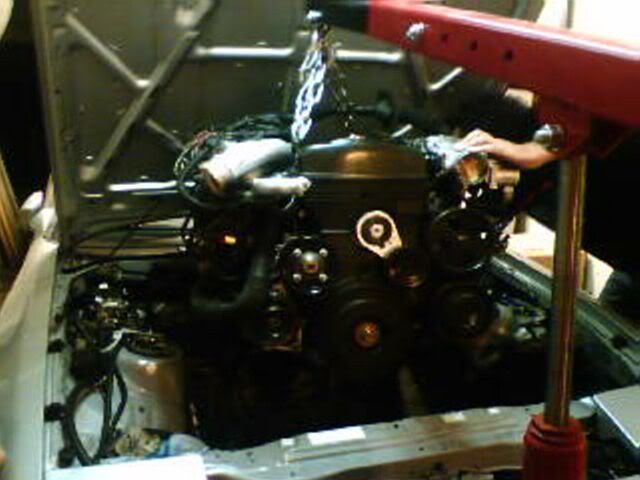

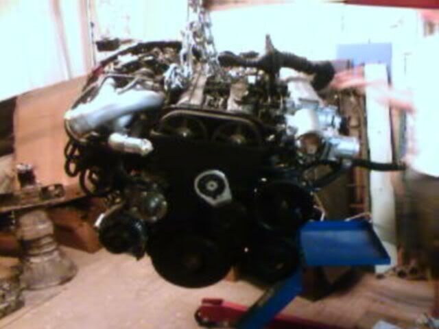

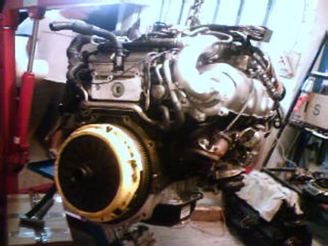

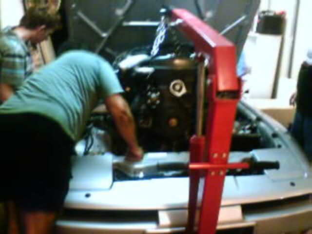

Some pictures of the stuff/parts and generaly of the project:
A friend of mine and Nick (my mechanic) throwing the motor in...I was just
looking....:biglaugh::love::biglaugh:

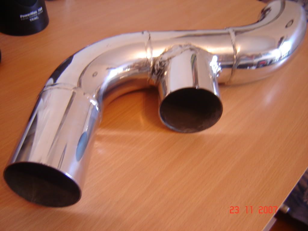

And some aftermarket parts!
JUN chrom moly flywheel

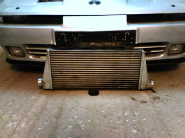

Big IC
Custom polished twin-intake for twin filters
Twin Blitz filters
Blitz SS BOV kit
GReddy oil catch can
ACT single disc clutch
