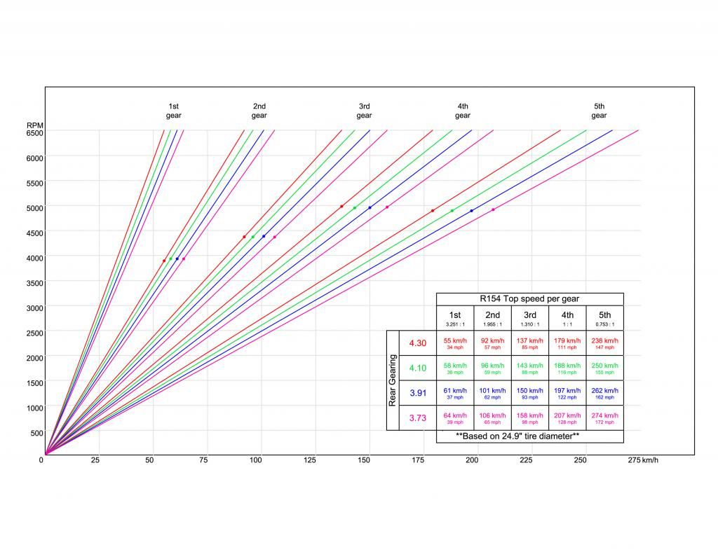

So my parts car has 3.91 gear LSD diff, my 89 is an NA but has 4.30 LSD diff. Worth the swap if going NA-T what are the pros/cons?
Grandavi
Sep 25, 2008
2,664
Calgary, Alberta, Canada
Basically only speed. 3.73 is probably the best overall for a turbo. Lower revs for highway driving.
If your doing quarter mile, the 4.3 is gonna be a snappier diff for the gears.
GC89
1J-THIS
Jun 13, 2007
938
Spokane, WA
Love my 3.73s. I have two 3.91s and a 4.30 diff that I have played with and ended up back where I started. Much better highway car and street wise is just as fast. The turbo spools much quicker and stronger with the higher load of the tall gears.
Best thing to do is pick up both if you get the opportunity, 3.91 isnt bad and some prefer it. I hated the 4.30 though.
Grandavi
Sep 25, 2008
2,664
I think the 4.3 is perfect for a NA as you get the quick acceleration. Or if you were using it as a track car with short runs. But for long distance travel it's nice to be able to stay near 3000 rpm with the taller gears on the 3.9 and 3.73. I'm just swapping in my 3.73 hopefully next week and will be selling my 3.9
