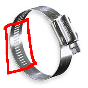

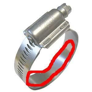

Clamps to stay away from are those that have the rack part of the gear cut right through the band, you need to use ones that are solid on the inside.
BAD
GOOD
Stock constant tension clamps will work well if sized right.
I can't tell the difference between the top two.
62
Alec;1552821 said:
The rack? I'm confused at what you mean. They both look the same to me.
A worm clamp is a rack and pinion just like the steering in our cars...
Pinion is the part you turn to tighten, the rack is cut into the band, on the top one the teeth are cut right through the band and can be seen inside on the 2nd one they can't be seen as they're not cut through.
The "problem" with Silicone hose and pic 1 is the silicone is soft and squeezes through the slots then as you tighten the band it slices that part of the hose off and creates a fail point.

The slots for the screw are exposed on the hose side allowing the screw to chew into hoses. The 2nd one looks like it's made so the screw/holes won't come in contact wth the hose. I used the last kind on mine when I put it back on, but mine looked like it was double re-inforced.

That red portion will cut into the hose when tightened down...it comes into direct contact with it.
There are no serrations for the screw clamp to grip to on the inside slider of that clamp (the outside slider has the serrations), therefore it will not cut into the hose when you tighten it down.
