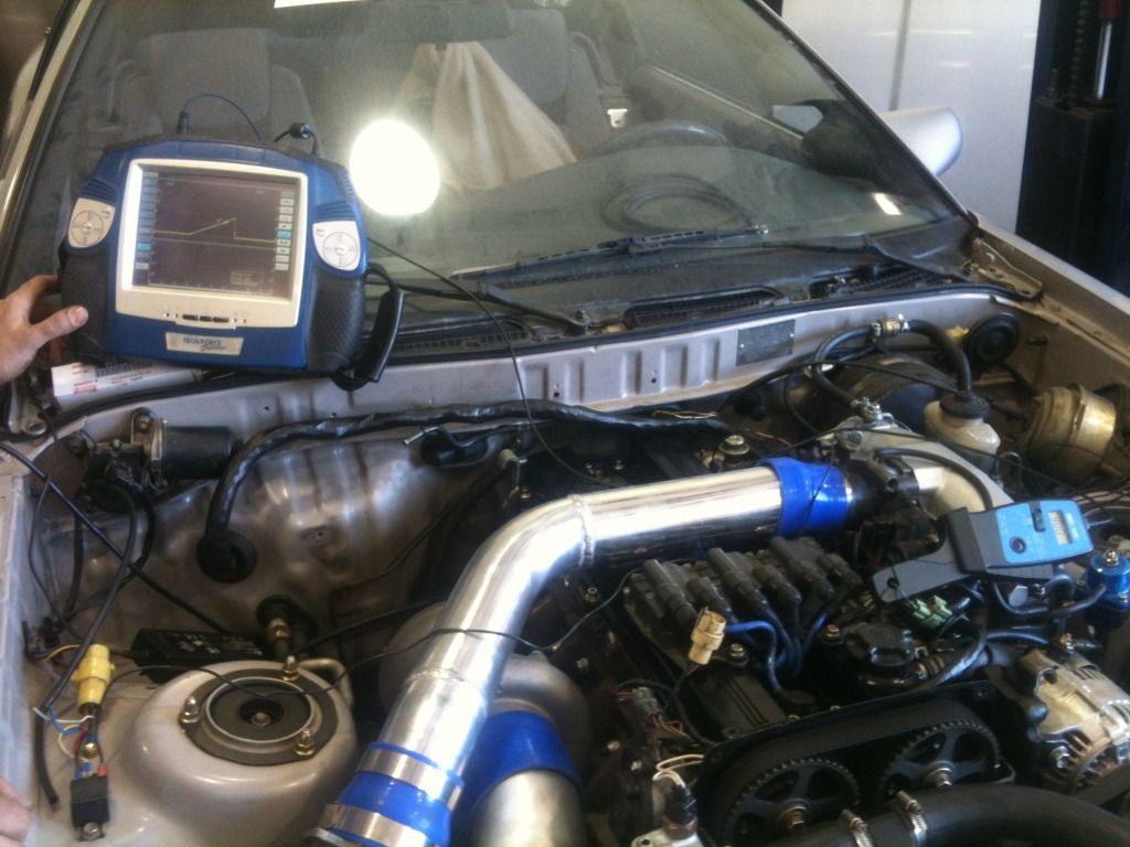

updates... Car is done other than the WOT tune. I've been driving it around, no leaks, everything is good.
Measuring amperage and dwell on stock Coils
Short running video to keep the haters out.

Only thing I don't like is the AFM setup, it's not where you placed it, it's just the AFM in general. Yes, I know the AFM is more accurate and users can post all the info of how much more accurate an AFM system is than a MAP based one but it would just look neater. Besides, tuning has evolved so much of the couple of years, it's not a problem tuning any car on MAP.

Why wouldn't it run it's in vacuum if it didn't she would be lee busted and not work were ever no mater were it was :)
and since you are running e85 you will need bigger injectors any way to match the air flow compared to gas.
547cc gas vs 919cc for e85 fro 500 ish hp
and when it is dipping is when the o2 sensore is re feed inof to the stock ecu or slight knock
