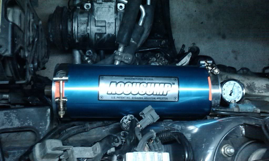

AN-10 oil system with 8x10x1.5 plate cooler, 2qt accusump

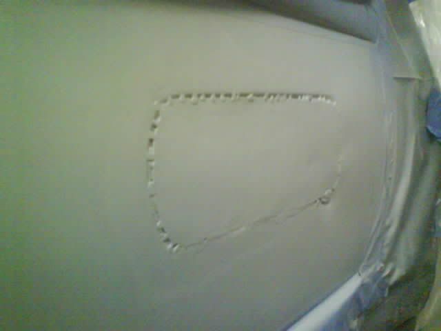

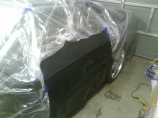

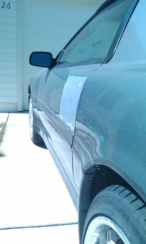

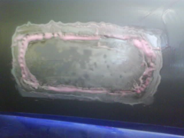

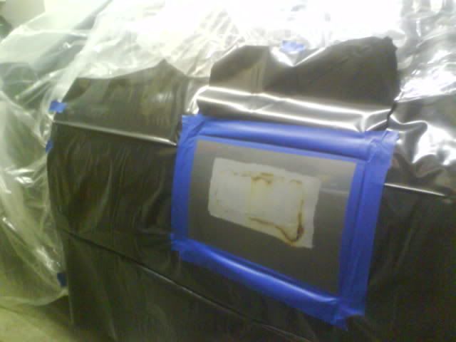

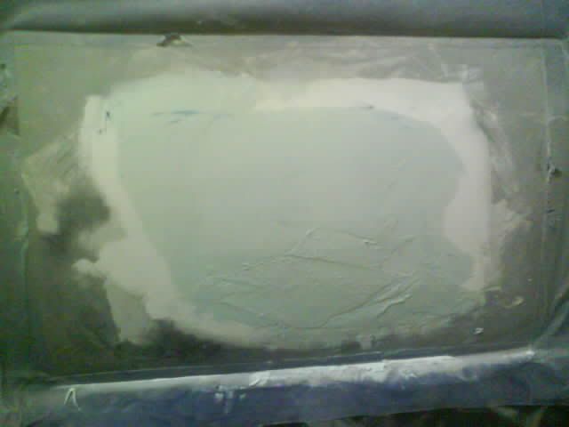

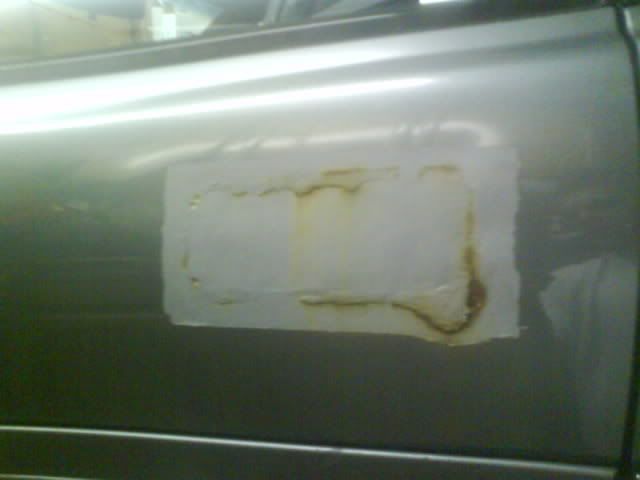

Nasty rust on a shit job of tacking on 16ga sheet metal after years of waiting
Wrap it before you tap it
Take out the rust with a gel form of muriatic acid
Self etching primer, prevents rust reoccuring

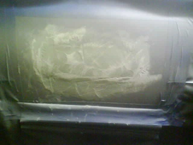

Poly based body filler. Shit turns to plastic, don't wait longer than a couple hours before filing it down!
Rage Gold body filler. The light smooth stuff for final imperfections

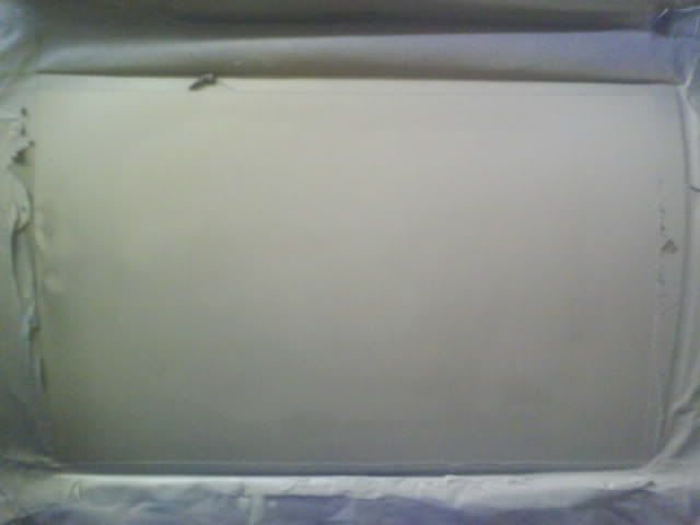

Sand it down

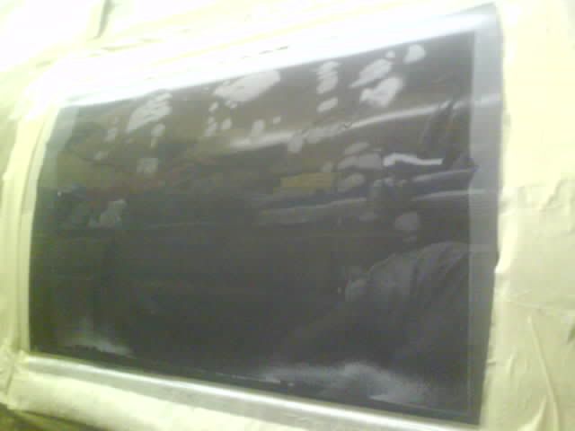

A few coats of self etching primer to seal it and prevent moisture from bubbling your work years later
Block sand by hand to achieve body contour. Clean surface and sand block often with soapy water in a spray bottle
Still ain't painted it 2 years later
---------- Post added at 07:34 PM ---------- Previous post was at 07:24 PM ----------
NTRA08;1591089 said:
love your sig nice car. How did you do the shave
LOL Thanks for looking and the question, I'm happy to answer:
Removing the door handles, there is a lip you can tack a cut out of 16ga sheetmetal to.
If you tack it yourself, proceed like your going in torque sequence or when the metal cools, it'll pull tight and deform the contour of the door skin. Take your time or you'll burn through.
Let it cool, put on long sleeve shirt pants, shoes not sandals, gloves safety glasses. Take an angle grinder and smooth out the welds. Cool, clean, prep and apply bondo.
Notice on my job, the philosophy of not doing an entire bead as the finished product, is that since doors slam, body filler may fail over time so the gaps provide more to hold on to as it squeezes through then dries.
-Dave

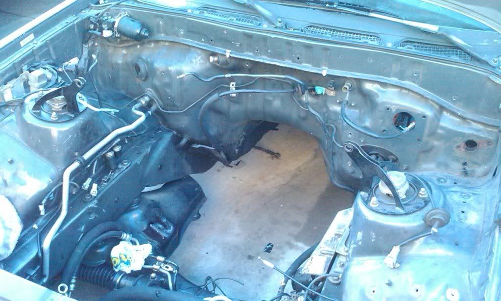

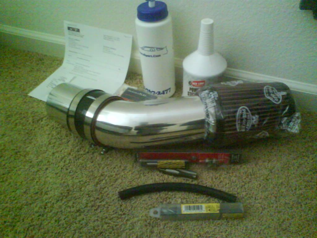

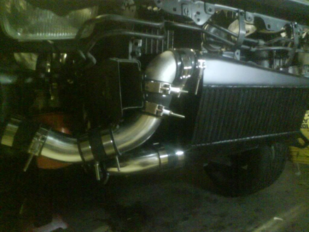

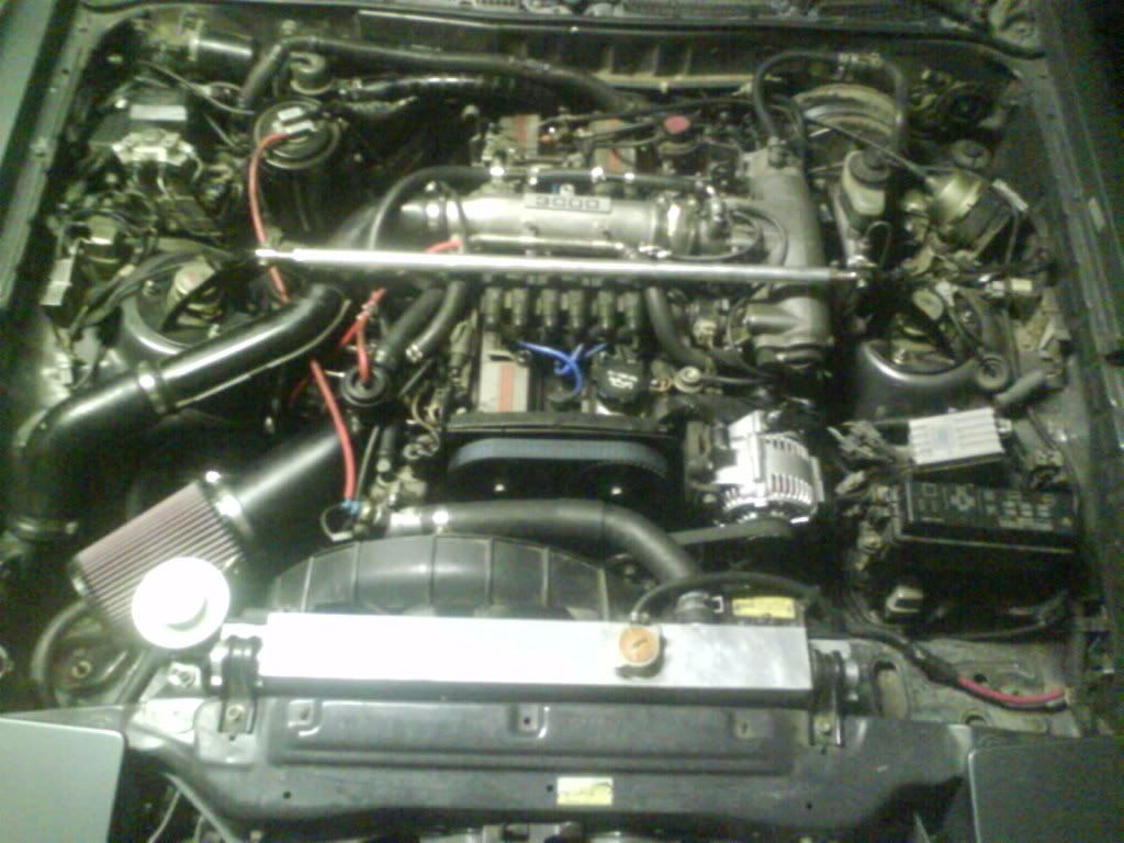

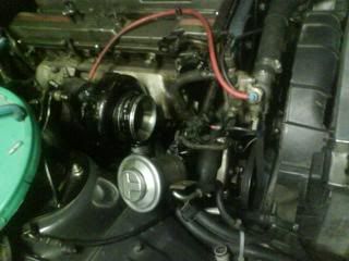

I was in a hurry and with Suprasport and Driftmotion's help, I got to upgrade the intake while trying to make this bolt-on fit:
2.5 IC charge pipe, DM spearco replica

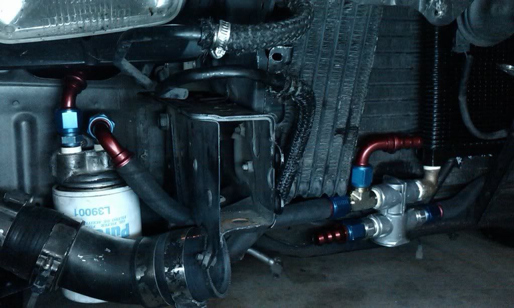

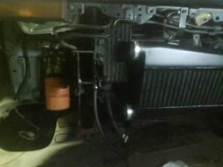

At the same time I went to full thermostatic oiling and tossed the oem spring based filter housing.
I moved the oil cooler over:
It practically bolted up, just turn the hose connector tube a bit.

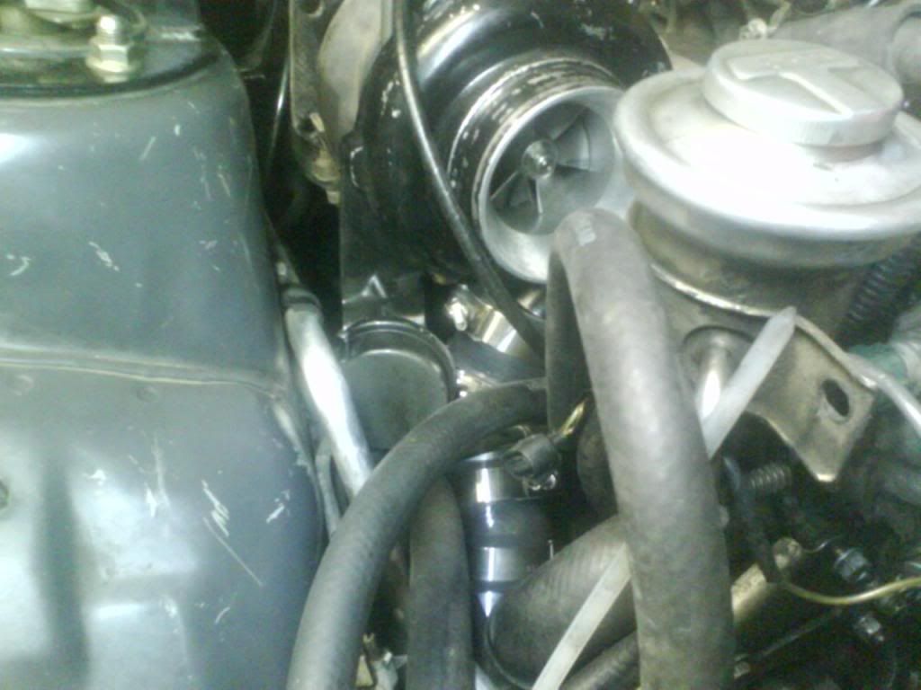

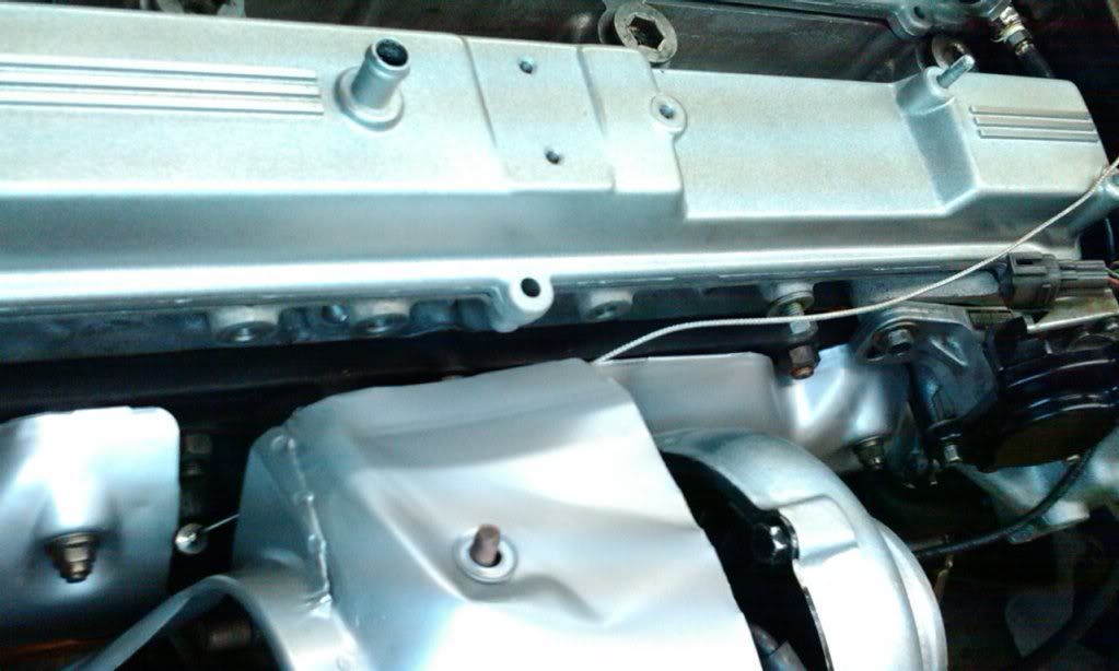

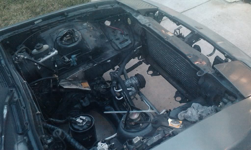

To fit the t70, I had to beat in the heat shield some. I yelled "Conform Bitch!!" all the while :D lol
But now the PS reservoir had to move for the 4in intake to pass
2 days later Suprasport came through
After some fabbing for the vacuum lines, I installed the new and improved super sucker K&N filter and modded 4" 45* bend with vac ports
I moved the PS reservoir forward and bent a small bracket to bolt it in place.
I also retained the fender pipe during the IC because the time crunch and it simplified my install. Plus it's low key.
Edit: I have to give Adjuster the credit for placement of the PS reservoir

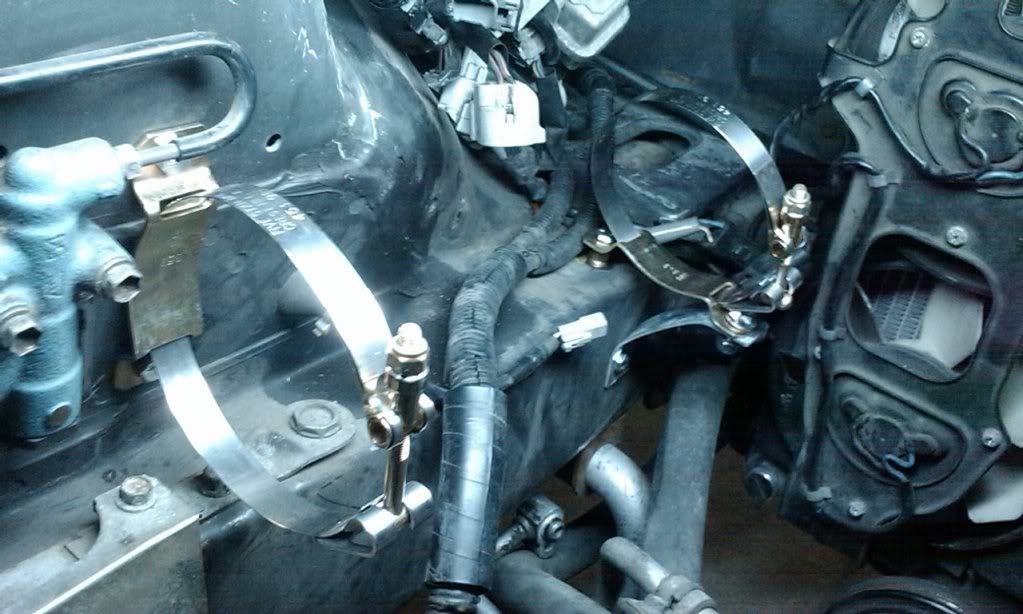

OneJArpus;1591178 said:
i like the look of it so far, but what is up with all the couplers and tbolt clamps. get that mess welded.
Did you miss the 80s, man?
Remember all the leather biker jackets with tons of belts, zippers, and snaps?
Gotta accessorize :D
Fo sho, that crap will get sorted, soon as a find/hear of a competent place to go.
Right now its last on my list. Till the couplers start blowing off lol

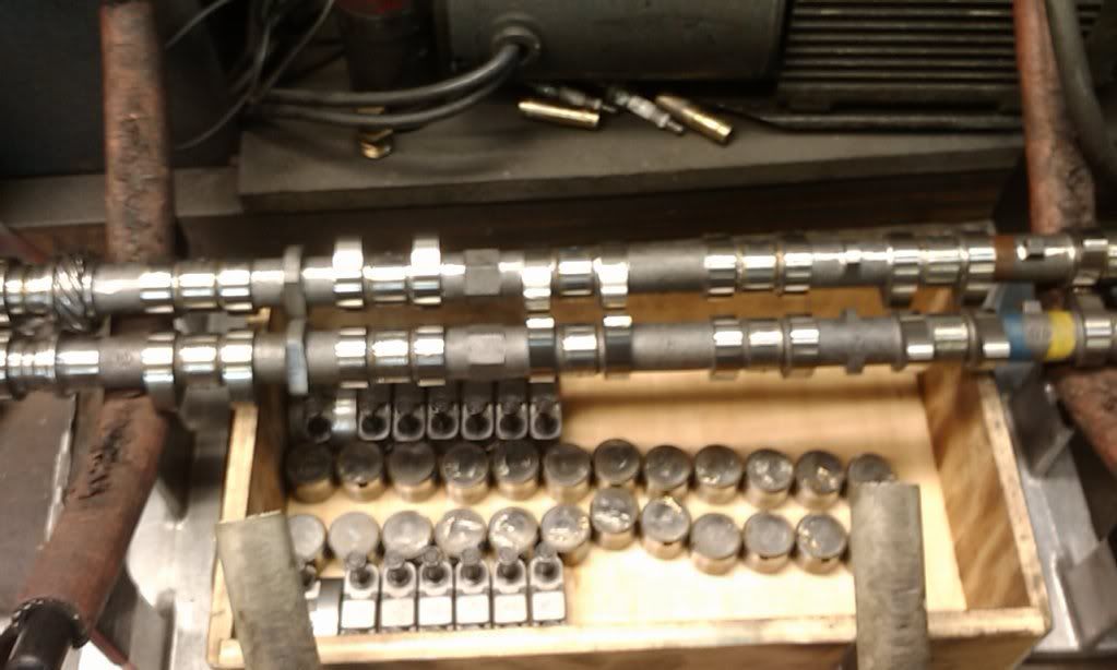

Gasket matched, seats cut for oversized valves and fresh out the hot tank
Shimming for BC 272s

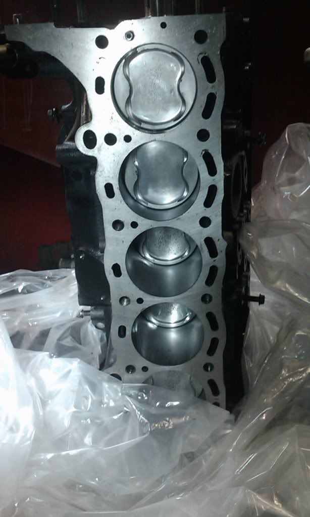

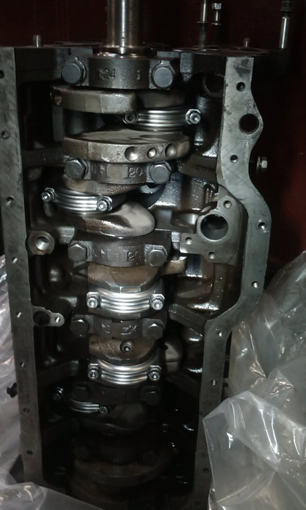

.010 Undercut crank, Eagle rods, King bearing all .030 clearanced
Arias pistons, .020 overbore

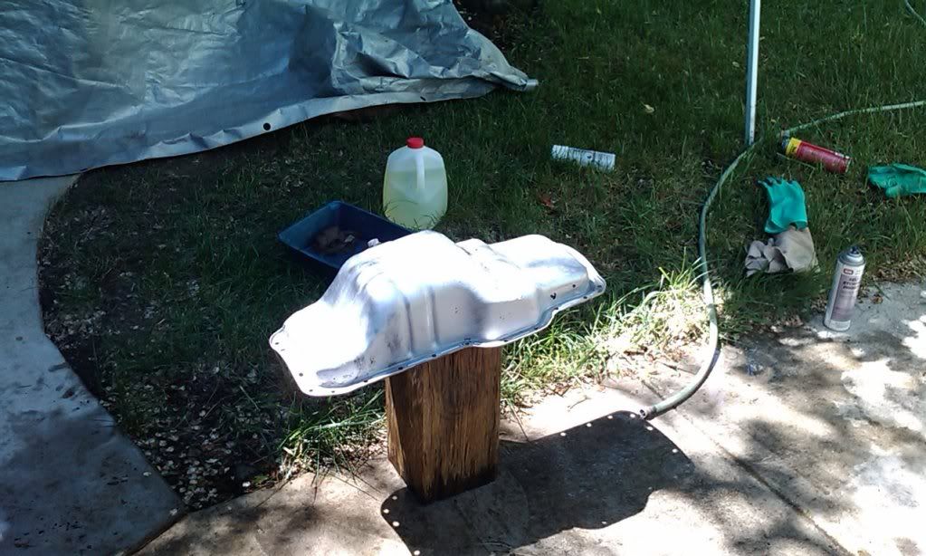

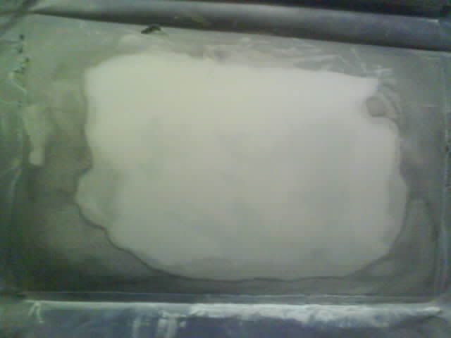

Muriatic acid bath.
-4mil NITRILE (a Must!) gloves
-outdoors (fumes)
-running water to prevent cement etching
-a plastic container to hold the diluted acid
-rag to wipe on the acid.
Takes several passes to acheive perfection.
Rinse and blast with brake cleaner.

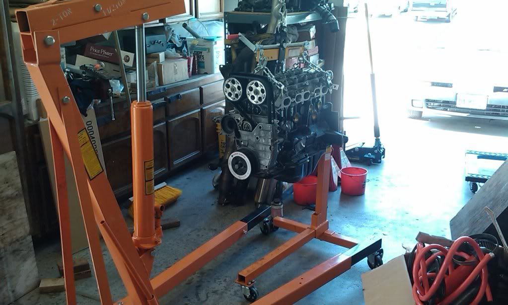

Rotating assembly.
-Fidanza cam gears
-ATI dampener
-Gates timing belt
-HKS stopper, 2mm
Cherry picker, engine stand, load leveler from Harbor Freight.
Napa low profile jack in background, no more parking half on sidewalks!

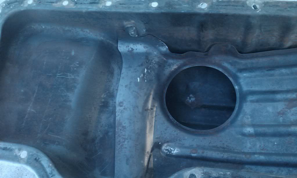

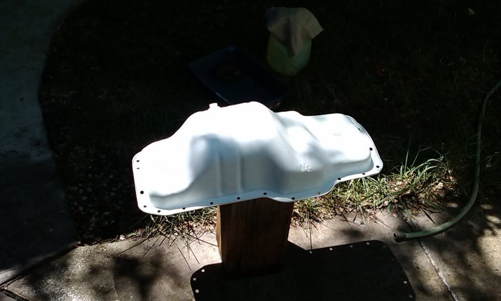

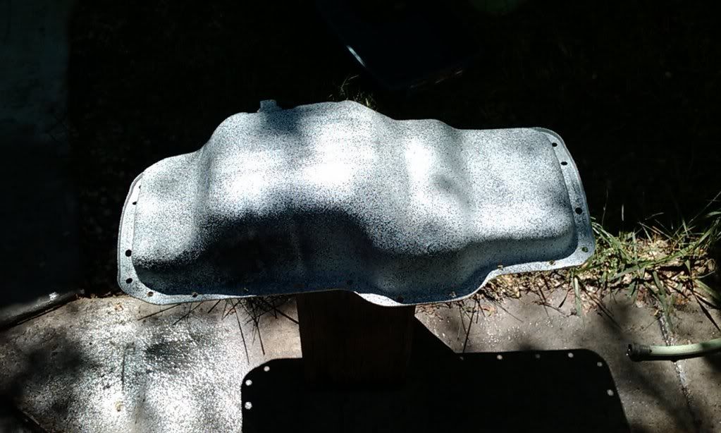

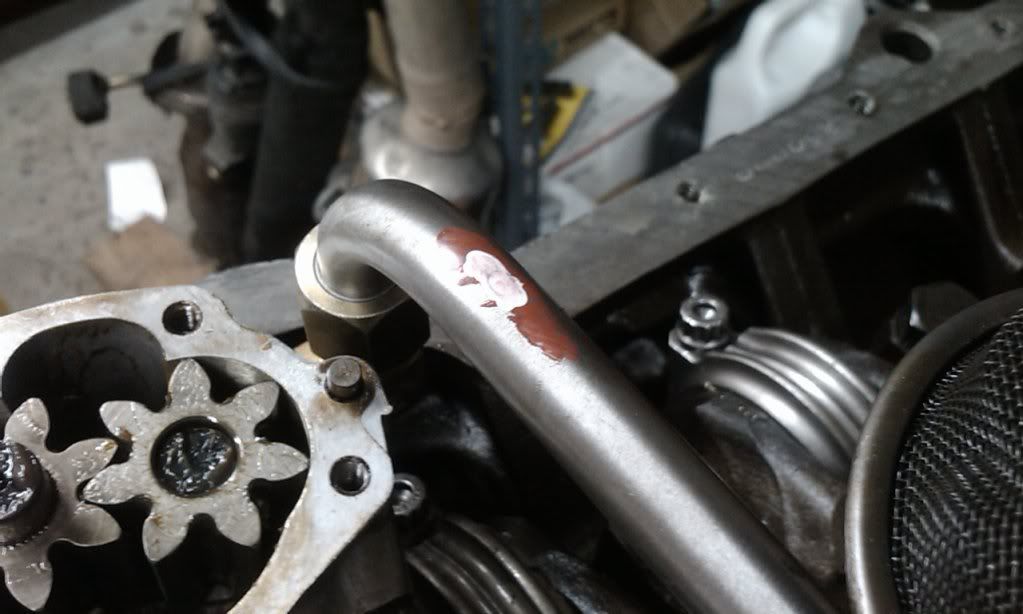

So I removed it and went to fit the pan but discovered a clearance issue:
The ARZ oil pipe upgrade is larger. Using paint pens helped me figure out where the pan needed to be massaged
The old and now disposed oem oil cooler banjo return had been plugged, but now hits the fitting to secure the oil cross pipe.
The bottom most rib of the pan baffle got beat down, and so did upper left of the pickup insertion point.

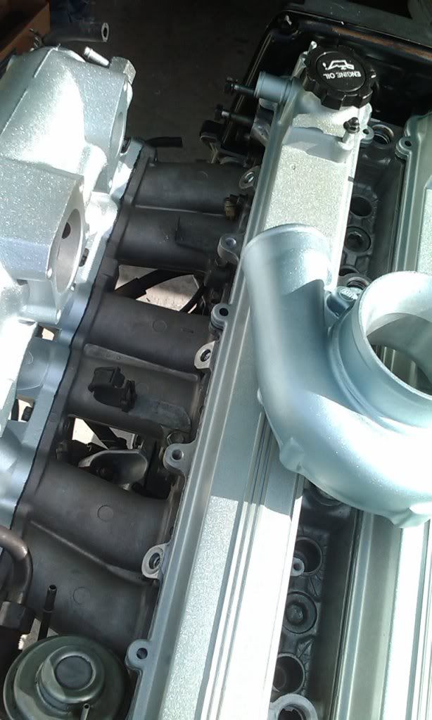

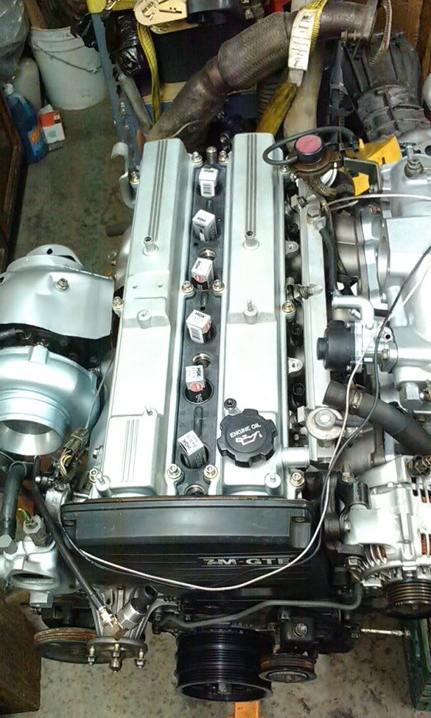

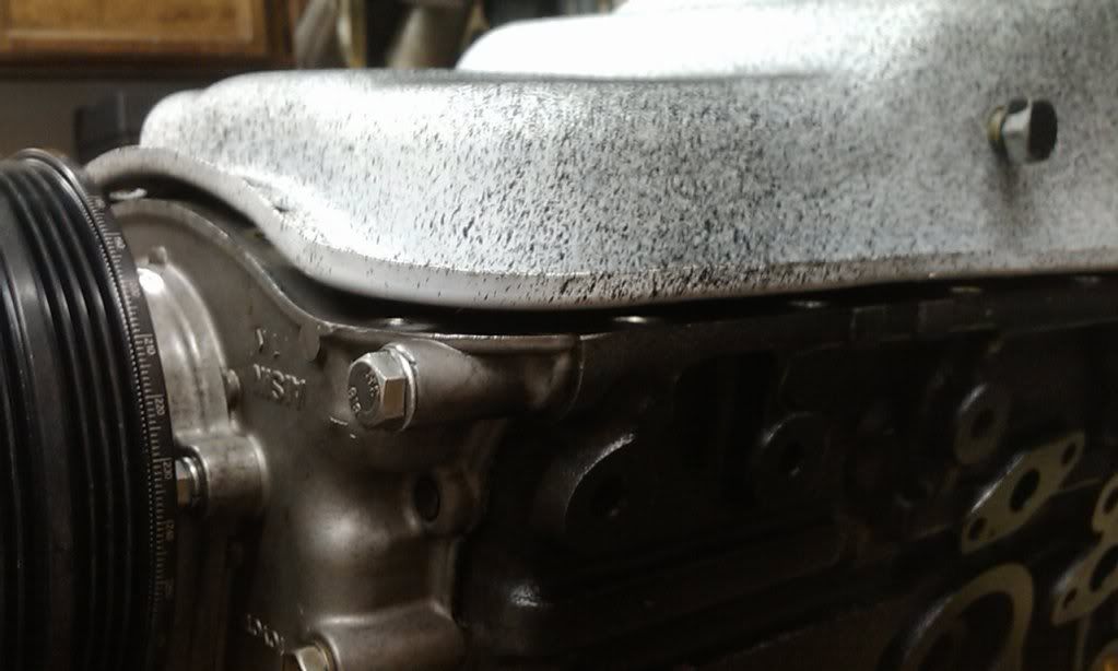

Mild porting and gasket matching on intake.
Also, I minimize sealant used to prevent oozing into the runner and potentially hurt overall flow.
Sealant of choice is Permatex 'Right Stuff'

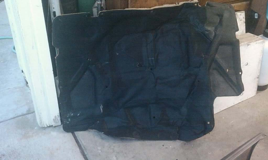

Degreasing, prep and paint takes a real long time. Its not hours long but DAYS to do. Pays off though.
I brought it into the sun to see what parts were sprayed with Duplicolor's 'Metal Specks', similar to metallic flake in paint.

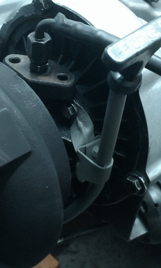

Fabbed a bracket to hold the oem dipstick
Braided stainless lines get heat shrinked to keep bling down and save my stuff from abrasion.

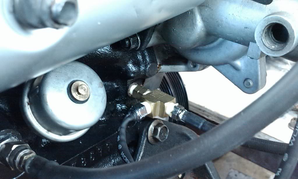

Also, front oil galley plug under water neck removed for 1/8 bsp to 1/8 npt adapter to tee, for oil pressure and temp gauges.
EGT sensor tapped in an inconspicuous spot for a clean install
AN-10 oil system.
-Summit remote filter mount
-Permacool thermostat 1070
-TRU-Cool 8x11x1.5 oil cooler
-OEM cooler repurposed as PS cooler
-Aeroquip fittings and line
Location of 2qt accusump. 3qt MIGHT fit but placement of inline electric solenoid may vary

The plan shifted a bit.
I decided I'll paint the engine bay myself. I've got all the stuff and a quart of 182, why not.
-Paint e-bay
-Slide in long-block
-Run in the engine
-Pass smog, get plate tags; I already gave the state its money
-Prep exterior for paint
-Get painted
-Enjoy

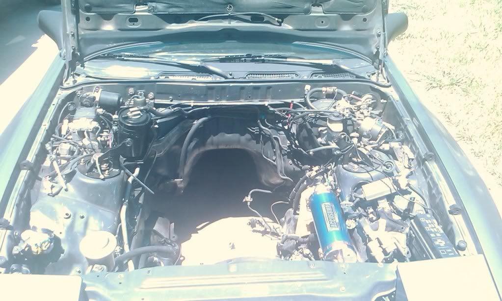

Engine bay before engine bay wiring harness removal
After harness removal:
Those headlight plugs are a time consuming without power to bring them up.
I degreased the hood heat mat thing by 50/50 mix of pinesol stuff in a bucket and water.
Couple gallons of mix, let saturate.
Rinse well with hose.
Hang/prop up mat and let air dry
I did that on Sunday. ~4 hours to remove the harness from the engine bay/driver kick panel.
