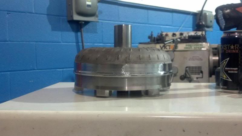

Dan,
Are you asking about my 7M kits or 2J?
My new setup is for the 2JZ, Using stock flex plate, toyota (j3) bell housing, SP pump/bell adapter, fully built trans, and a custom converter. The converter is not a precision or anything else, its completley custom to fit the yota flex and th350/400 trans.
this is a pic of the converter before its painted :)
