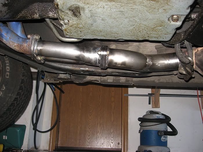

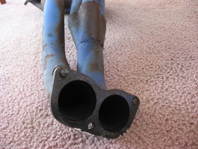

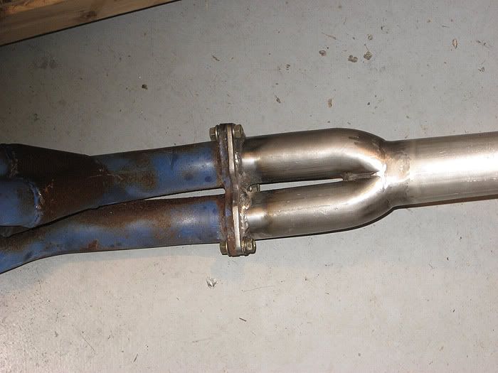

TRUST header, ceramic coated & modified with wideband O2 bung
RabidChimp 2.5" Collector
HKS 2.5" Catback
