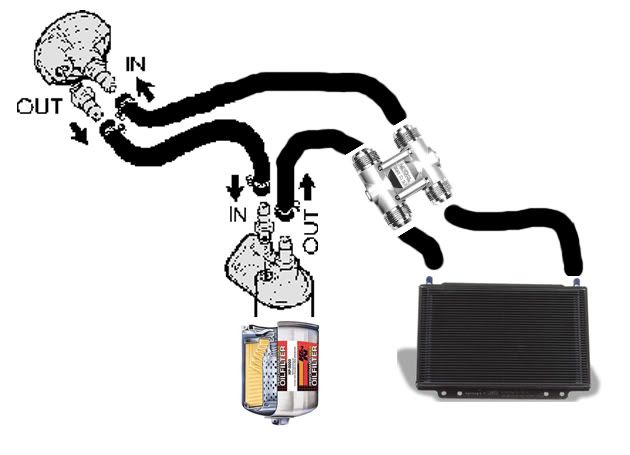

awesome, I have it all ready to go. I will add in the 180 thermostat then. thanks IJ
like this??
I know this has been gone over a lot. But which one do you recommend.

I'm using a cheap and nasty Permacool one but If I weren't so lazy I'd swap it out for either a Canton or a Morcal one as they're MUCH nicer.

Thanks for all the help IJ. :icon_bigg you respond fast!
I didn't mean to hijack this thread, Just wanted to make a simple diagram for everyone.
