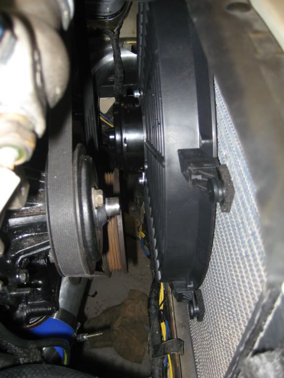

speedfreak426;1245612 said:
I wish I had enough room to install the factory fan setup.....
I had no choice but to put in e-fans :( now I constantly worry that they will fail.
pics
You could always splice into the power wire going to the fans and run it to an led mounted somewhere on the dashboard. It wouldn't help if the fan motors blew, but that's the least likely scenario anyways.
jetjock
creepy-ass cracka
Jul 11, 2005
9,439
I had no choice but to put in e-fans :( now I constantly worry that they will fail.[/IMG]
Wire them right and the odds are they won't. That said there are lots of simple ways to sooth your nerves. For example you can monitor fan current or speed or use a temp alarm. I use the stock fan and still have an alarm. Very easy to do using the stock AC overtemp switch...

speedfreak426
Mar 31, 2008
380
Brighton, MI
I just have them hooked up with a thermostatic controller.... sooo none of the stuff you mentioned.
Any suggestions, or well, more in-depth suggestions?
