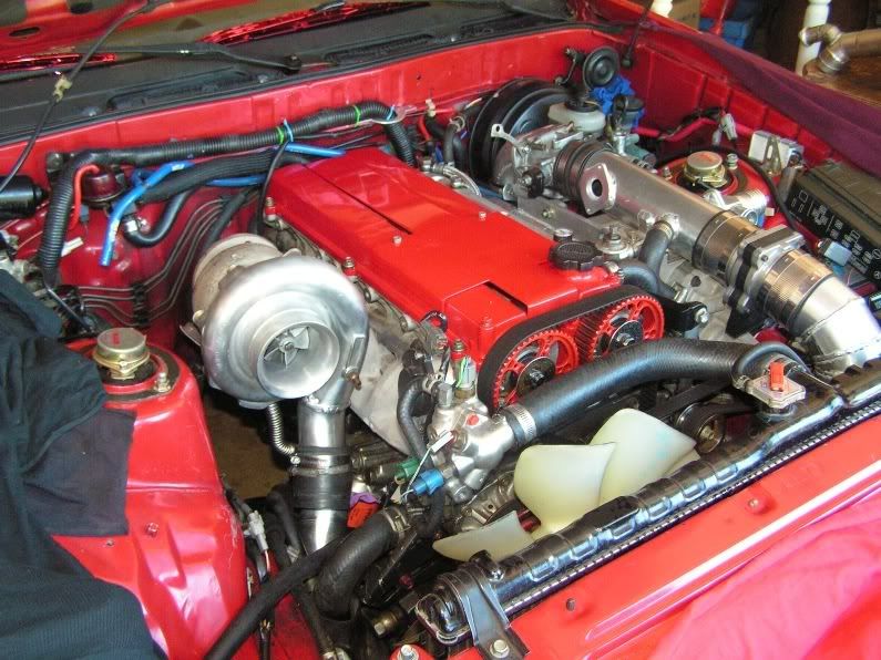

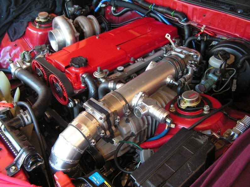

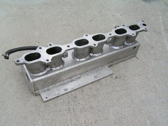

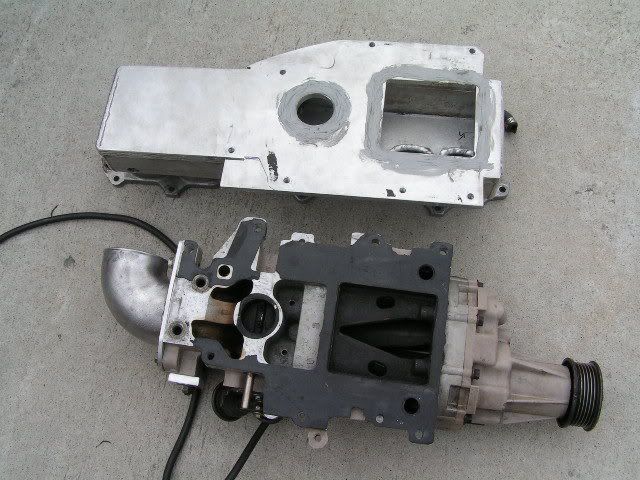

I'm working on my twincharged setup as we speak. Not on a 7M but a 1jz.
Eaton M62 Supercharger
T04R Garrett Turbo
PowerFC Engine Management

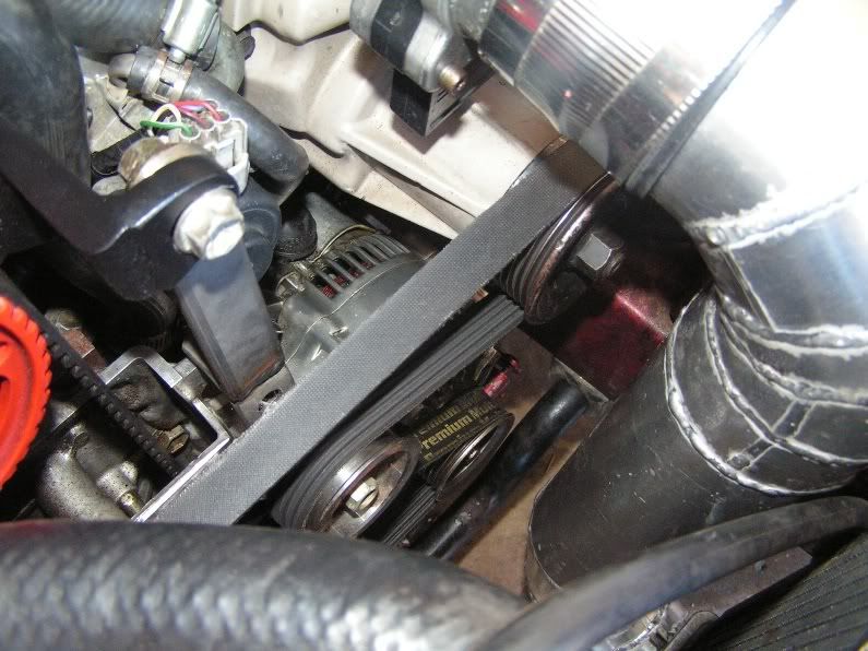

This weekend I moved the Alternator to drivers side to make room for the s/c.
Took a little more time then I had hoped. So next weekend will mount the s/c.
I will post pictures when all I get it all done. Hoping for the low end torque of a s/c with the high end hp with my turbo. In theory it should work :dunno:
There probably a better way but trying to do it a little different. plus I love this kinda shit. Fabbing up mounts and doing it all my way whether it works or not.

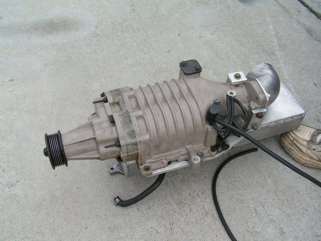

T04R Garrett Turbo
don't use the m62, i run one of those on my 2.0 cobalt. there are massive tuning issues with the twincharge kits on the cobalt's with those. get rid of that an get an m90 off of a gtp. the m62 will simply not have the volume needed for a 3.0 motor.
i know they said it is for up to 4L engines, but it simply will not be good for this application. hell, we're running them on 2L engines and have maxed them out and have had to look at tvs and harrop blower swaps just to get over 300whp.
get on ebay, search for m90's you should be able to find one cheaper than an m62

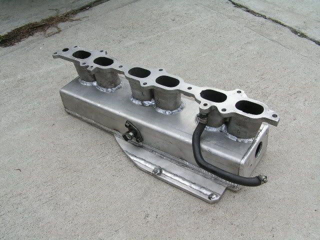

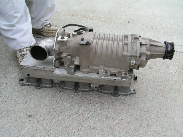

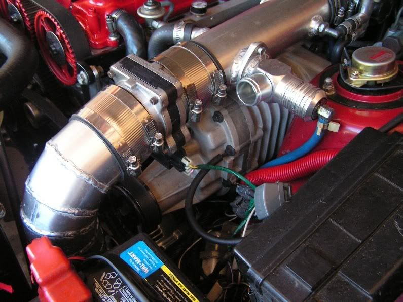

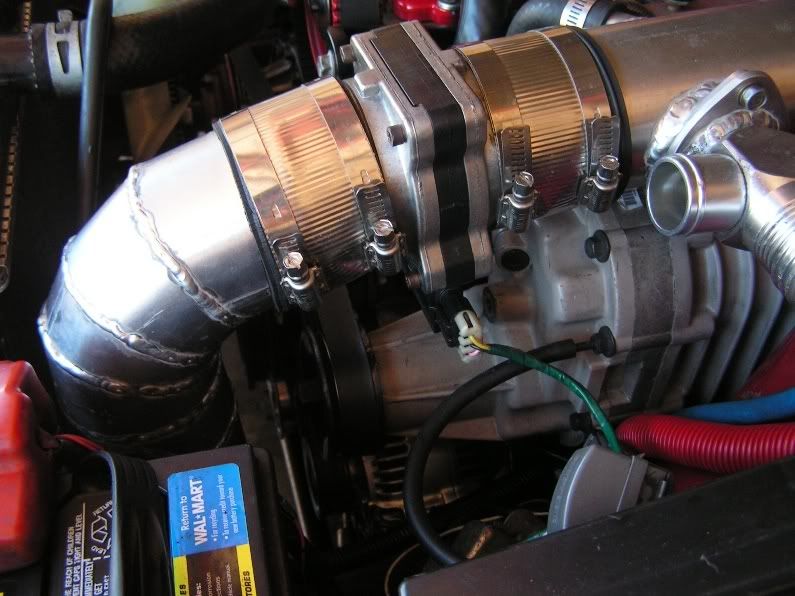

those plumbing couplers in the pics look like a bad idea... love the supercharger tho. my buddy has a spare one sitting in his garage.. hmmm

Lee_MA61 - He was running it compound boost.
He has switched to a 2JZ and is working on twincharging it right now. I'll try to get some pictures for you all to see.
