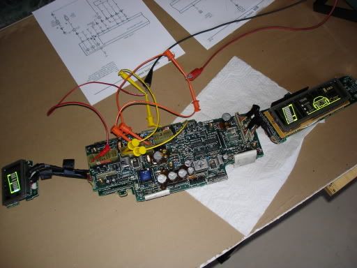

****UPDATE****
Just a small one, as I promised I went over and tested the reconfigured board with my dad tonight, and it worked, much to his relief ahahaa! So here's just some cool pics of digi bits being tested, nothing exciting really, but I find it all exciting so w/e.
Whole setup wide
Close-up of whole. All 3 boards light up, you only see the new one far left, and the small one as the main coolest one is flipped for easy pin connection.
Close-up of the new board.
Now that I have this board back, I can build the right side of the cluster, positionning this board properly into it and then fiberglassing it tight. I have to extend those 3 groups of wires coming off of it as it now resides on the other side of the main board, so the wires are mega short. I hate fiberglass work, as it stinks and is just difficult, but I'll probably do some this week, as I have mon-wed off. I'll update when I get somewhere cool. Especially when my box-o-digiparts arrives from Suze!
