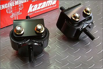

These are Great mounts, if you can find them.....
Made by Kazama in Japan.
Because of the through bolts, there is no way the rubber can fail.
But they still allow for some movement, and vibration dampening.
Ooohh. Somebody finally started making import mounts like GM did back in the '60s. May be time to trade in the solids.
Not a fan of solids on ANY car.
Tends to rattle fasteners loose and just overall drive you batshit from the vibration. Most of the F-body guys I've known only run one solid that basicly acts like a hinge to stop the torqu from ripping the engine out, and the other one is stock to kill the vibrations. It does still have a bit more vibration, but not nearly as bad as full solids...
