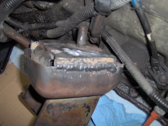

just do this......
used 2 small strips of 1/4 inch steel plate to fill the gap from the mounting plate to the metal surround. Welded it up solid, should be good for anything and only cost me 10 minutes and a small amount of steel i already had laying around.

Damn that looks like something I blow out of my nose after grinding cast iron!! ;)
