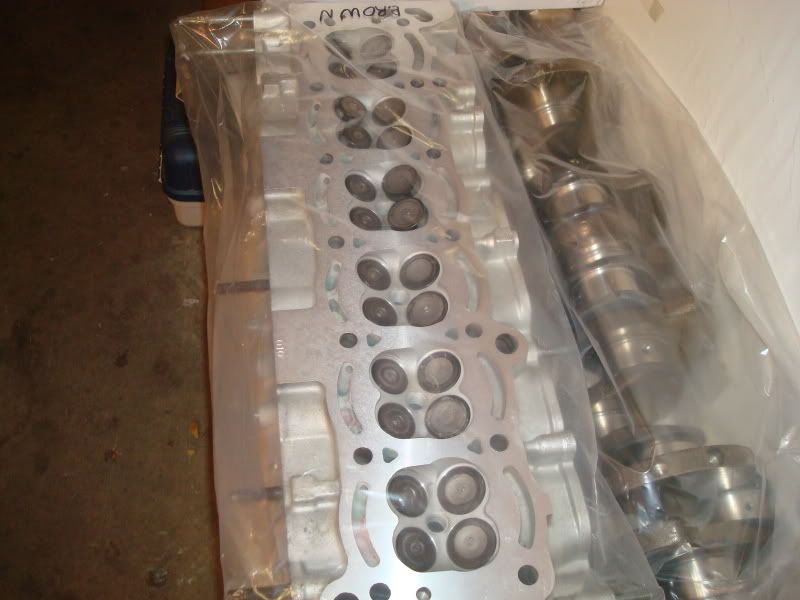

So I just got a call from the machine shop, he said he broke the coolant pipe banjo bolt on the back of the head and damaged the threads, has anyone
run into this. Any suggestions for fixes other than a new head.

Yep been there done that....

Were your threads damaged or were you able to just remove the damaged pieces. This sucks I was ready to start ordering parts
but if this guys tells me the head is bad I'm gonna cry that was my last spare one.

Using that tool the threads were ok, don't know what he's tried so far he might have killed the threads if he's used a conventional easy out as they tend to expand the broken part....

Yeah that's probably what happened. I think I'm gonna end up welding a small pipe and add a T for the coolant lines.

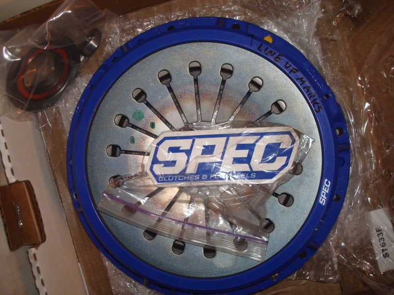

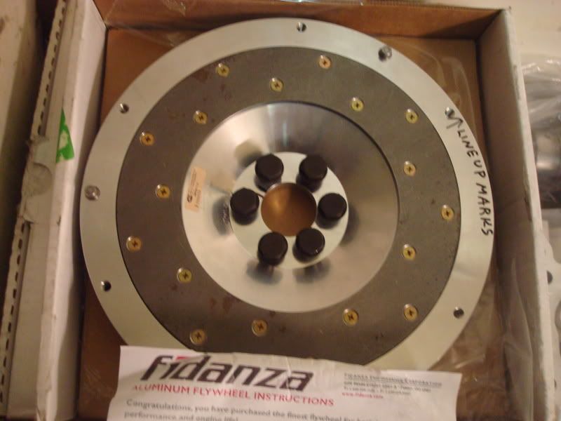

So have some updates. I had a machine shop custom machine a larger coolant banjo bolt for the back of the cylinder head
that broke and they tapped the threads larger in the head, it came out perfect. I just ordered some goodies.
- .020 over CP forged pistons
- Eagle rods
- Fidanza light weight flywheel
- stage 3 Spec clutch
- Clevitte bearings
- Torque plate ( really sucked getting this, but I live in CO and nobody has one)
Still deciding on which turbo, Billet Precision 6265 or 6765.

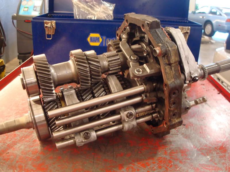

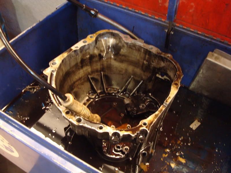

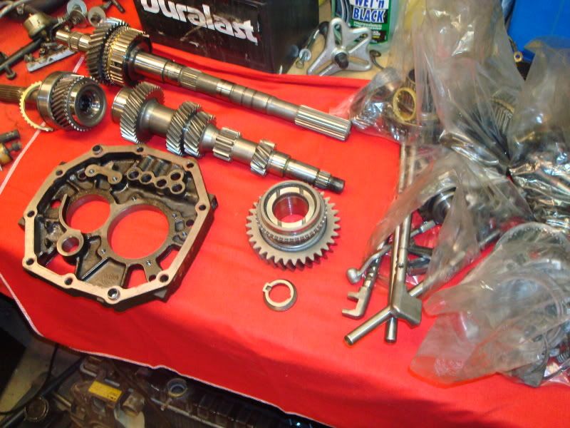

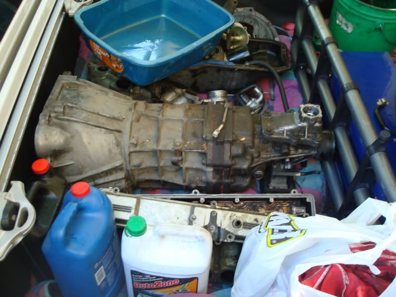

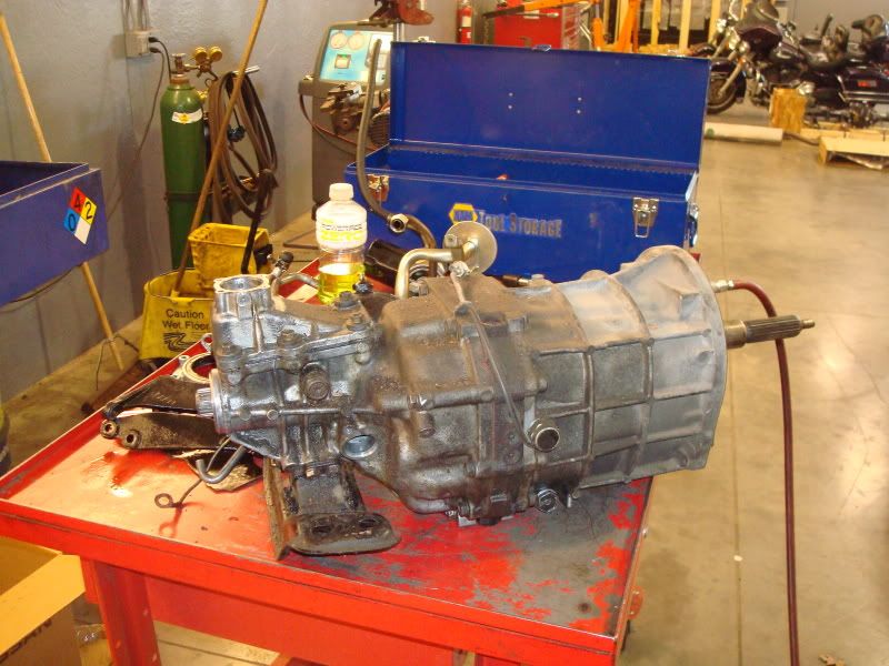

So I'm working on the transmission while I wait for engine parts to arrive. Here's some tear down pics of the tranny. Does anyone know of a rebuild kit for the r154, I couldn't find a site for mdc motor sports anymore.

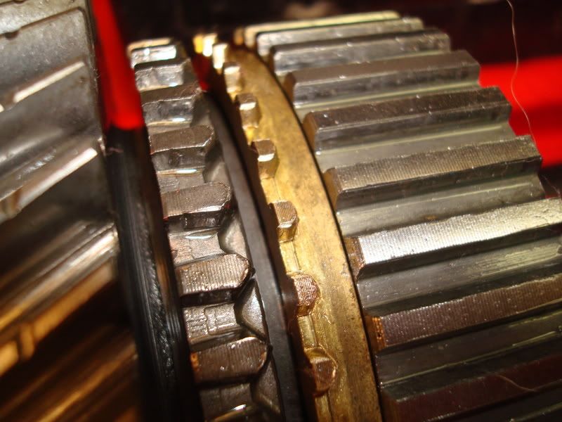

Here's a good shot of one worn out synchro.
Nick M
Black Rifles Matter
Sep 9, 2005
8,898
U.S.
www.ebay.com
For those that haven't seen it before or are otherwise unfamiliar....
The brass ring has pointed ends, where you see his are worn down. That is the grinding in the transmission when you grind it. The syncro part is the underside which is threaded to match the speeds. The pointed teeth worn down on the top are the clutching teeth that hold the transmission in gear. When they are worn, the trans will pop out of gear.

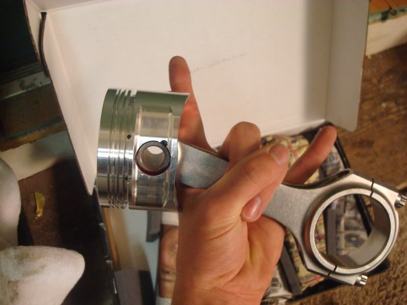

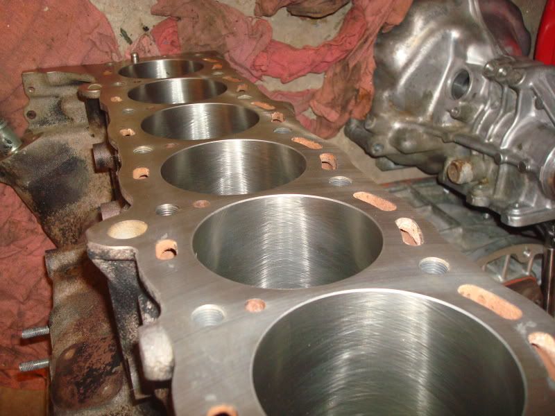

Have some update pictures. Finally got the parts I ordered and sent them to the machine shop.
I had the cylinders bored .020 over, decked the block, new oil pump drive shaft bearings, all new
freeze plugs, crankshaft grinded and balanced, cylinder head milled, new valve stem seals and
complete valve job. Now I'm ready to assemble the engine. Next will be the drift motion 67mm
turbo kit.

builds looking nice but you should touch the rods to much they'll get surface rust from the acids/oils from your skin,just a heads up for ya!
IBoughtASupra
Mar 10, 2009
4,455
Queens, NY

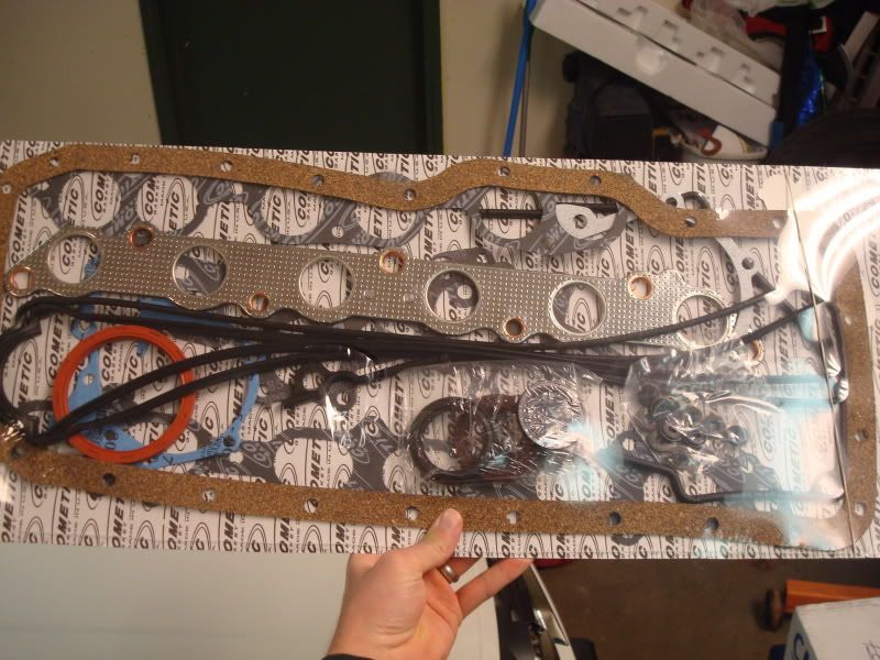

Did you balance the rods and pistons? Just incase you don't know, do not use the oil pan gasket that came with the kit, use Toyota FIPG since it is the best silicone I have used.

They are brand new CP pistons and eagle rods. I didn't think they needed balancing, they are supposedly balanced
within 1 gram of each otherand yeah that cork oil pan gasket is going in the trash I learned that the first time
I resealed the oil pan.
