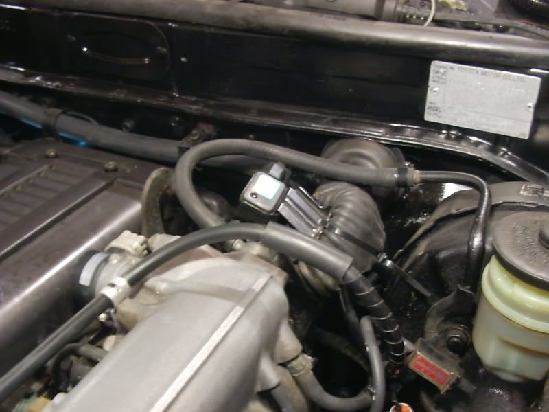

You better give them another call it looks like your missing the map sensor as well :nono:
excuse the zip tie , this was just after install and yes that's right I didn't extend my harness but it's a MKII so you may or may not have the room for this option.. hope it all works out for ya !!
