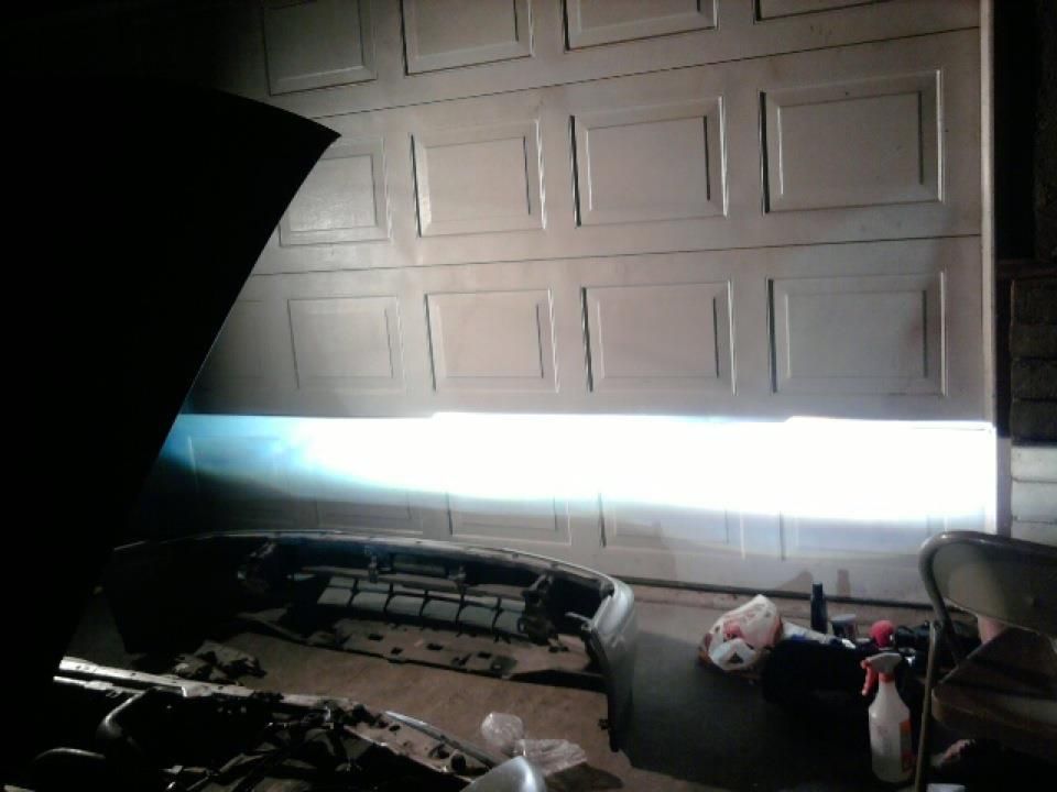

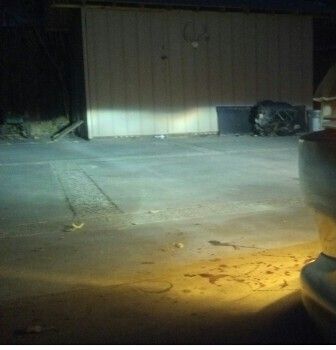

damn..where was i?? lol...i did mini h1 in both my old accord, integra, and now my mk3. i just did some minor trimming on the reflector bowl and it fits wonder, like factory.
supra cut off-
accord-
as you can see, the accord's cutoff is more clear and sharp than the supra, idk why. could it because the supra's len is glass??
but here is how it looks fitted inside.

akito;1972771 said:
That's really nice QWIKSTRIKE, do you have HID's in the projectors? How are the light output?
Yes I have HID 8000k's but will probably change them to the 6000k's for a tad brighter light. They work excellent and you can see with the white primered hood the cool blues were installed. I forgot to mention that I had to cut and message the stock buckets to get these in, and did not need to cut the radiator support.
supra cut off-
accord-
Thanks for posting. They look good. Its good to know that they will fit with only minor trimming.
It probably the glass lens making the cutoff a little fuzzy. That's why I went with plastic.

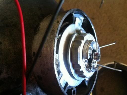

Only pic of the back and to mount, it comes with a h4 ring u put in the slot but with the mini in, the projector sits a kittle far back so your gonna have to make something to fill in the slot so the lock ring can tighten up the h4 ring. Oh btw, u just have to enlarge the bulb hole little by little til the projector fits with the lens on.

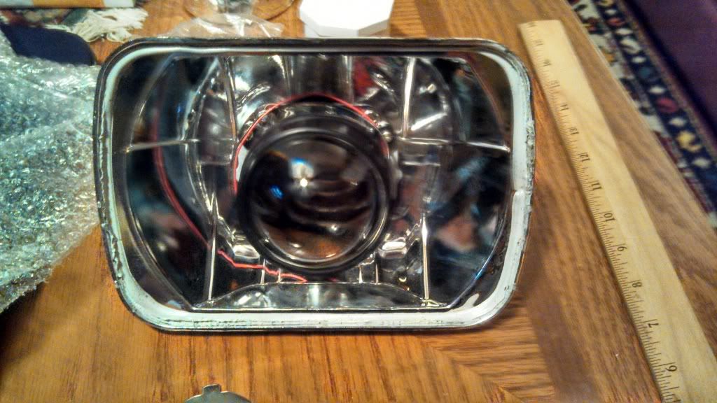

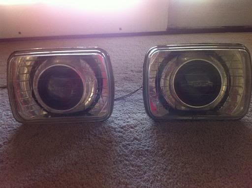

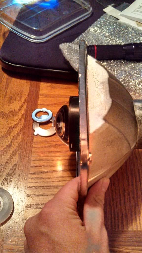

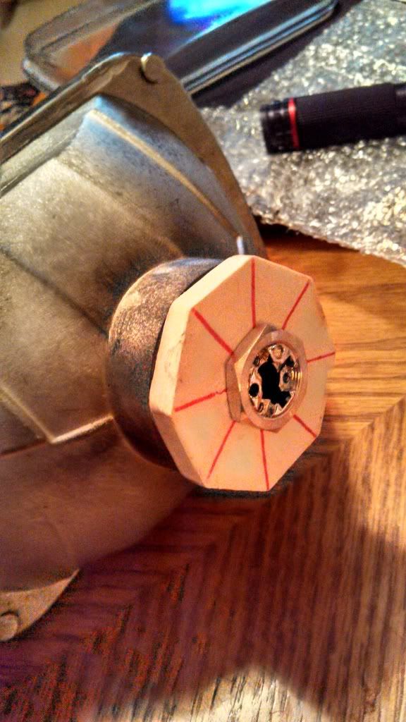

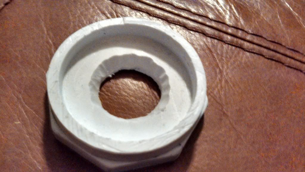

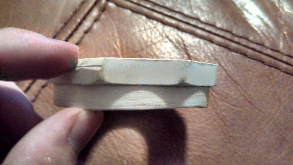

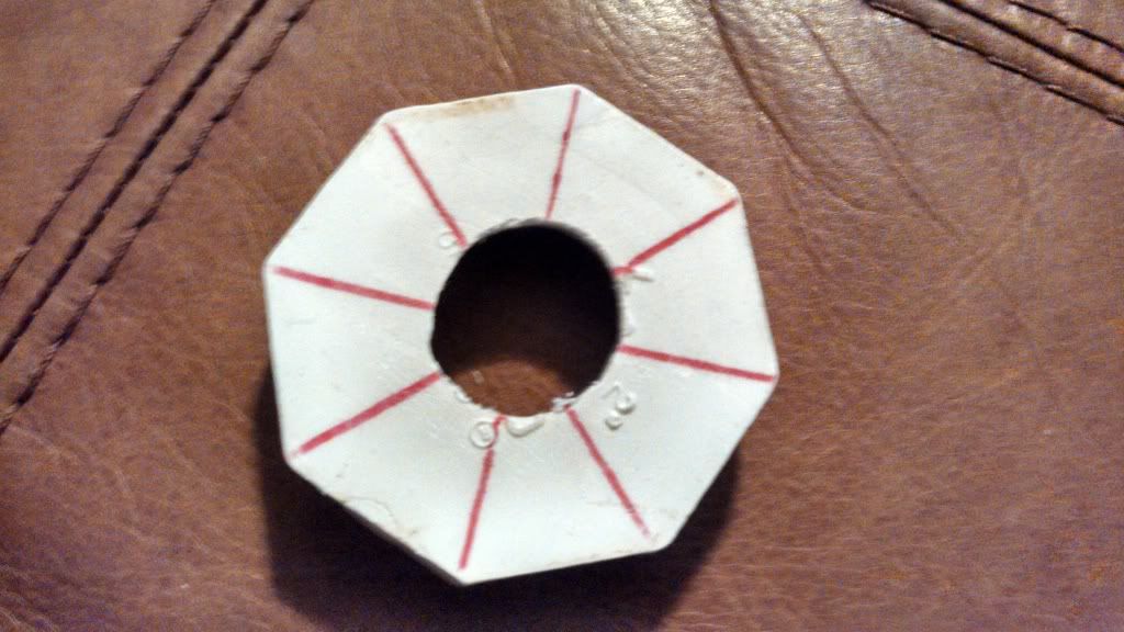

Well I spent a good bit of time today working on one of the housings. I dremeled out everything inside of the circle on the light where the rubber boot goes over and then took a file and got everything as far back as I could without filing through the housing and creating a hole. I got a 2 inch PVC end cap from Lowes and cut it down so only about a quarter inch sticks out past the head of it. Then I cut a hole in it so the threaded shaft on the projector could stick through it. Now my problem is that I still don't have enough clearance to mount the front lens.
Apparently when they revised the Mini H1 to the 6.0 they made the projector bowl ever so slightly larger which matters a lot when you are dealing with millimeters. So right now my options are to just cut into the housing to get the projector to sink farther back into the housing, or space the lens out away from the housing. I would rather not cut any more of the housing because I want it to stay water tight.
Any suggestions or thoughts are welcome.
Here's some pictures of the progress from today.
