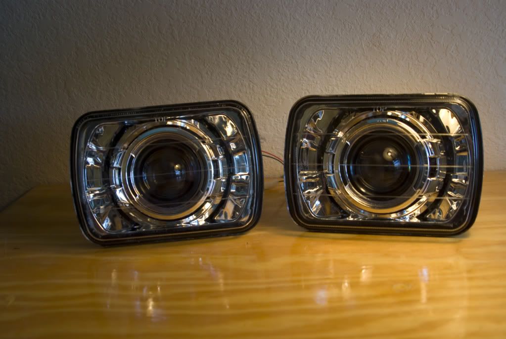

Don't mean to thread jack but I always wondered, do you have to get those projector housings that look like eyes or can you get HIDs with the regular style head lights? I am thinking about going with HIDs as well but I was thinking of going with yellow HID fog lights.
Bit of a loaded question, so excuse the long explanations.
Do you mean the round lens at the center of these lights when you talk about an "eye?"
If so, technically yes. Here's the rub though. Putting HID bulbs into a halogen housing causes all sorts of crazy glare, alignment issues, and crap output (commonly refured to as "kits). While there are cars that use HID in a reflector headlight, it's far FAR easier to retrofit a compact and pretty much self contained projector than it would be to rip the reflector out of those headlights and put them in something else.
Now, HID's in fog lights is ultimately dumb simply because of their intended purpose (they're fog lights, 3x more light is NOT going to do you favors in the fog).
There's a lot more ground to cover though (kelvin, aiming, why all of this matters, etc). Just keep in mind I won't sugarcoat things :)

Yea I did mean the round lens center housings. I like the look of white/white blue headlights with yellow fogs. I remember reading awhile ago that wiring HIDs in our cars is a nightmare or something like that I don't remember exactly.
Thanks for giving me the quick and dirty version. :D
