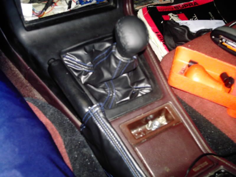

i'm using the MOMO anatomic short shift knob
i got an extra sogi modded shifter. if you want it, pm me and shoot me an offer.
here are a couple of pics of it off the car.

ill take some pictures tonight when i get home. it's exactly the same as stock just shorter [[i never had a problem with it "sitting straight up" on the old car, don't quite know what youre talking about]]...no tape..yes you will, i am using the momo anatomic short shift knob..will post pics later of the one in my car...i recieved my shift boot and e brake boot from empera today so i gotta switch out the stock ones
