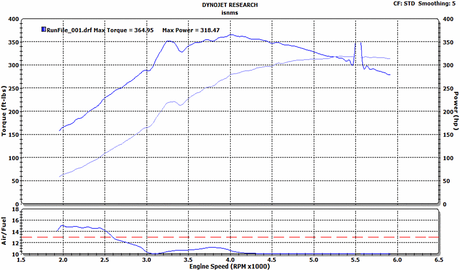

318HP/364TQ, 15psi
Mods:
• k&n fipk • cartech ic series 2 • defcon ic hardpipes • bosch 110 & blitz ss • lexus afm • pte 550 injectors • ct26 50trim no clip • becauseican 3"dp • exhaust depot 3" high flow cat • raptor 3" cat back • magnaflow 12198 • arp head studs • cometic mls • je pistons • crower rods • clevite bearings • ngk plugs • msd 8.5mm • ati super damper • spec stage2 clutch • fidanza aluminum flywheel • mkiv-tt fuel pump • aeromotive afpr • hks tt • hks evc iv • greddy rebic lc cpu-ii • zeitronix zt-2 • g-tech pro rr • prosport fp gauge •

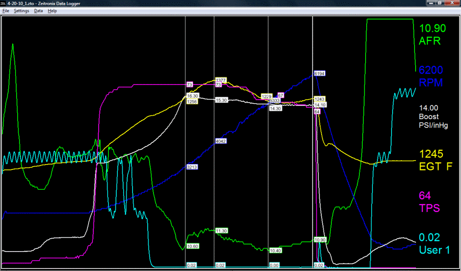

I still have some room to improve. My made my street tune for around 11A/F but on the dyno it dipped deep into the 10's.

^You've got a little room for more power; but, hey.....10's are safe!
I like seeing how the AFR's affect the EGT's. I wish I was setup to log EGT's. :(
I'm headed to the dyno on the 28th. I'll be looking to reclaim a spot on the list. ;)

I didn't do any tuning on the dyno, just two runs for results. I did my street tuning for low 11's. It showed richer on the dyno.
Good luck on your session. My results should get me into 24th spot :D

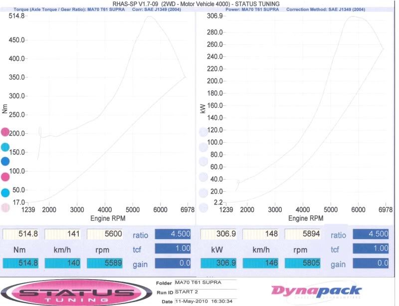

411.5rwhp (306.9rwkw) 379.6ft/lb (514.8nm)
7mgte, more or less stock rebuilt motor, cometic/arps, 3 angle valve grind T61 @ 16psi 3" turbo back exhaust, haltech e6x 835cc injectors & walbro 255, 600x300 intercooler
on boost its about 11.8:1 afr

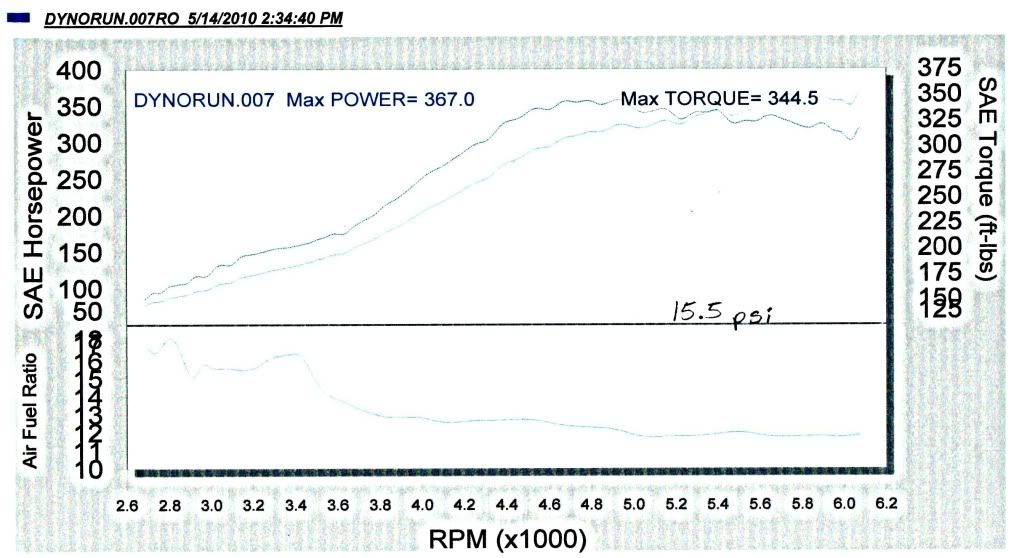

Here's mine from today. 367 HP/345 TQ. Something started to break-up at 15.5 psi so I decided to stop. There's more to be had; but, this will get me back on the list. :)
Engine: 7MGTE
Mods: JT62 @ 15 psi, PTE550's, Walbro, AFPR, Maft-Pro, Fidanza FW, Fan Delete, Extrude Honed Intake Manifold, DM IC, 2.5" IC Pipe, Blitz Elbow, 3" SuperDragger, Test Pipe.
