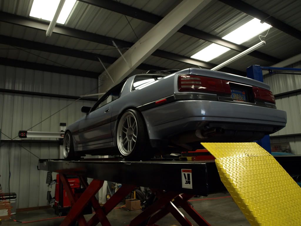

Yup it was a slow day today. My buddy was cutting off mufflers off a S2K exhaust system when we thought of a cool plan.. Why not make an exhaust for the supra???
Put the car on the rack to see what we had to do.
We found that a 350Z mid pipe was almost the right size and bends so we used it and hacked up a bit to make it work.
Dual N1 WooT
Yum
And my friends project SC again.
So.. all in all we used a 350Z mid pipe, 2.5" tubing, S2K Y pipe, and the 2 N1 Mufflers. As for sound it sounds stock haha, that 350Z resonator works crazy good.
