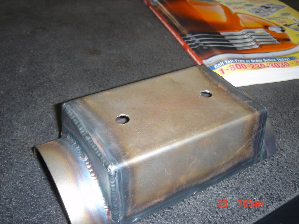

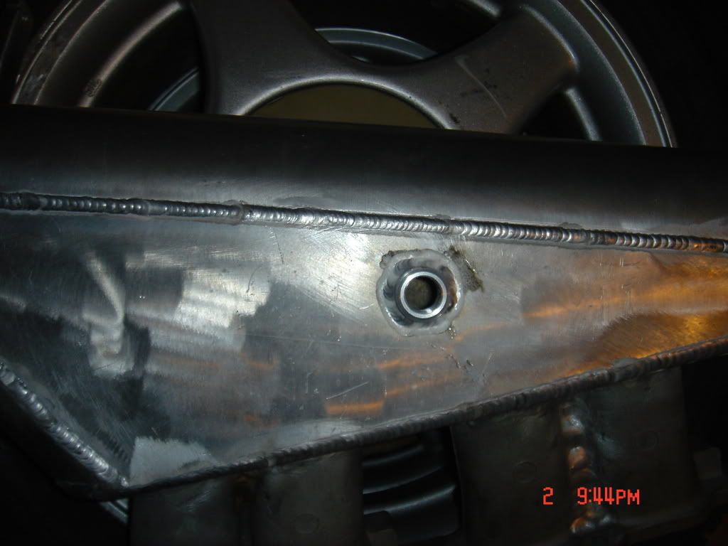

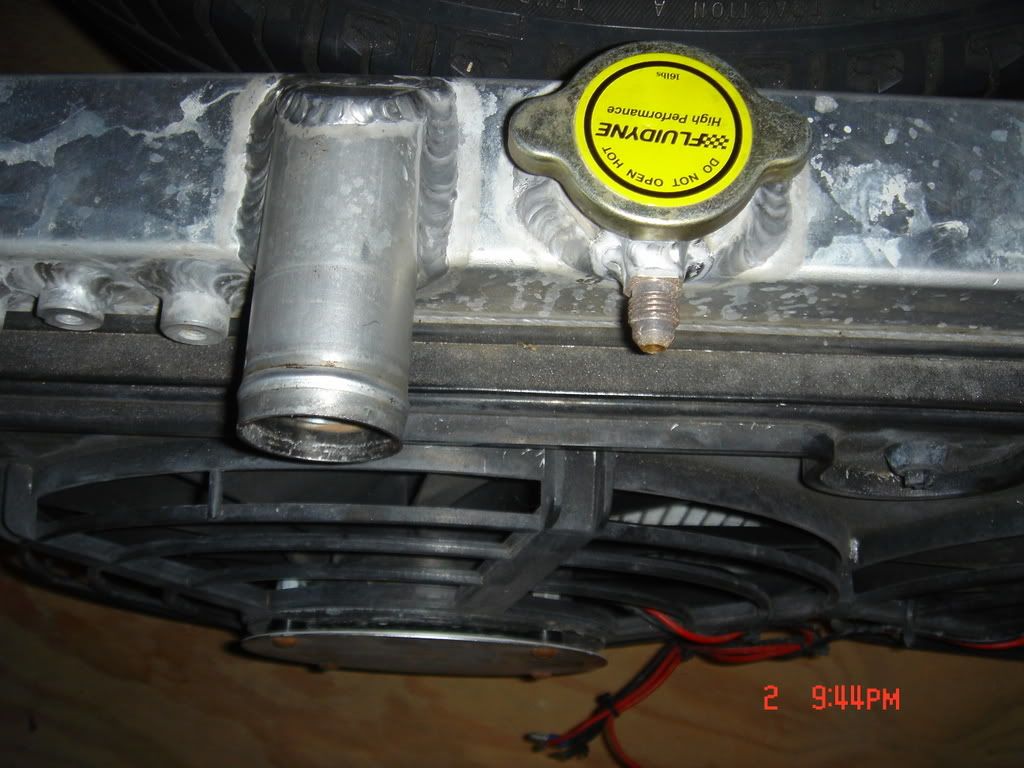

Well i got a few parts back from the welder and we will count that as an update since all i have been doing is removing undercoating and that all looks the same so why post more pics of it right.
Here is my coolant accumlator mount.
My radaitor i hade the -4 fitting welded on. To buy one that would screw in was 60 bucks f that.
And i got the fitting welded in the intake for the intake air temp sensor.

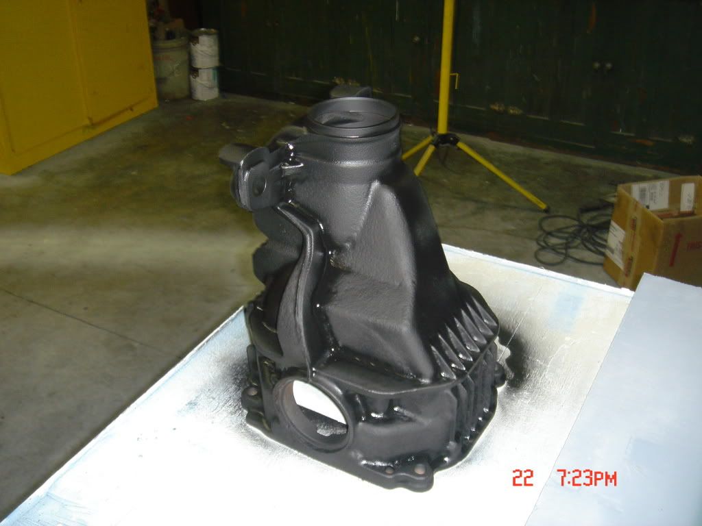

Well i kinda have an update. We finaly got the sandblaster fixed at work so i blasted the diff and painted it so soon ill be able to finsh rebuilding it.

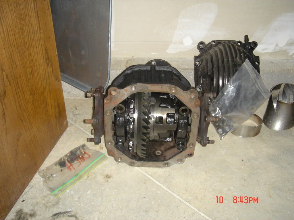

Ok well here is the update since i got the rear end sand blasted i finaly rebuilt it. Its all done except i have to steal 2 bolts out of one on the other ones i tore apart and i need to order the 3 gaskets from toyota then it is done.
