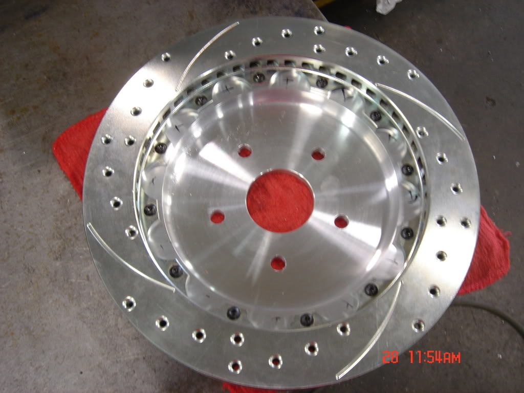

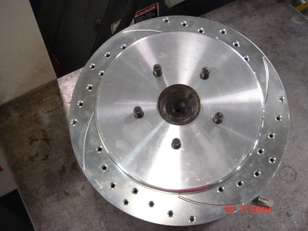

Well i went into the shop today and finshed the rotor hats for my bbk.

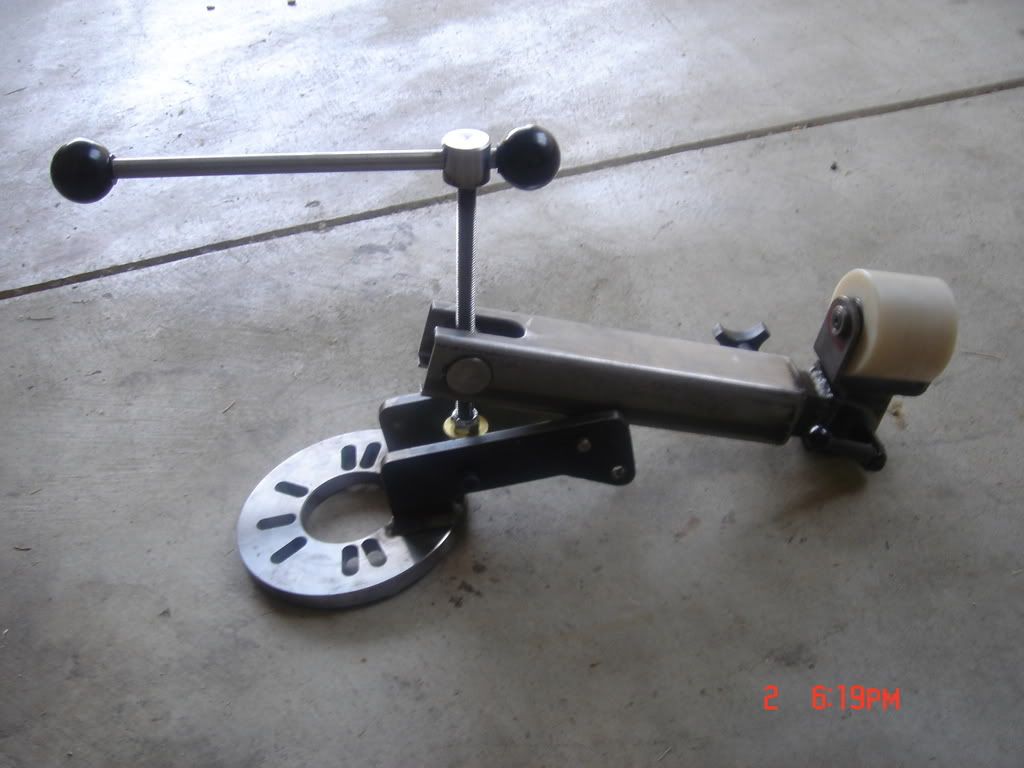

I also worked on my fender rolling tool its almost done i just have to order a few speical bolts.

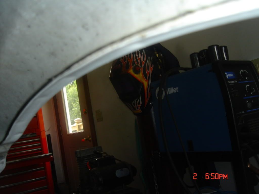

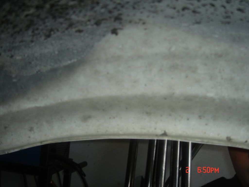

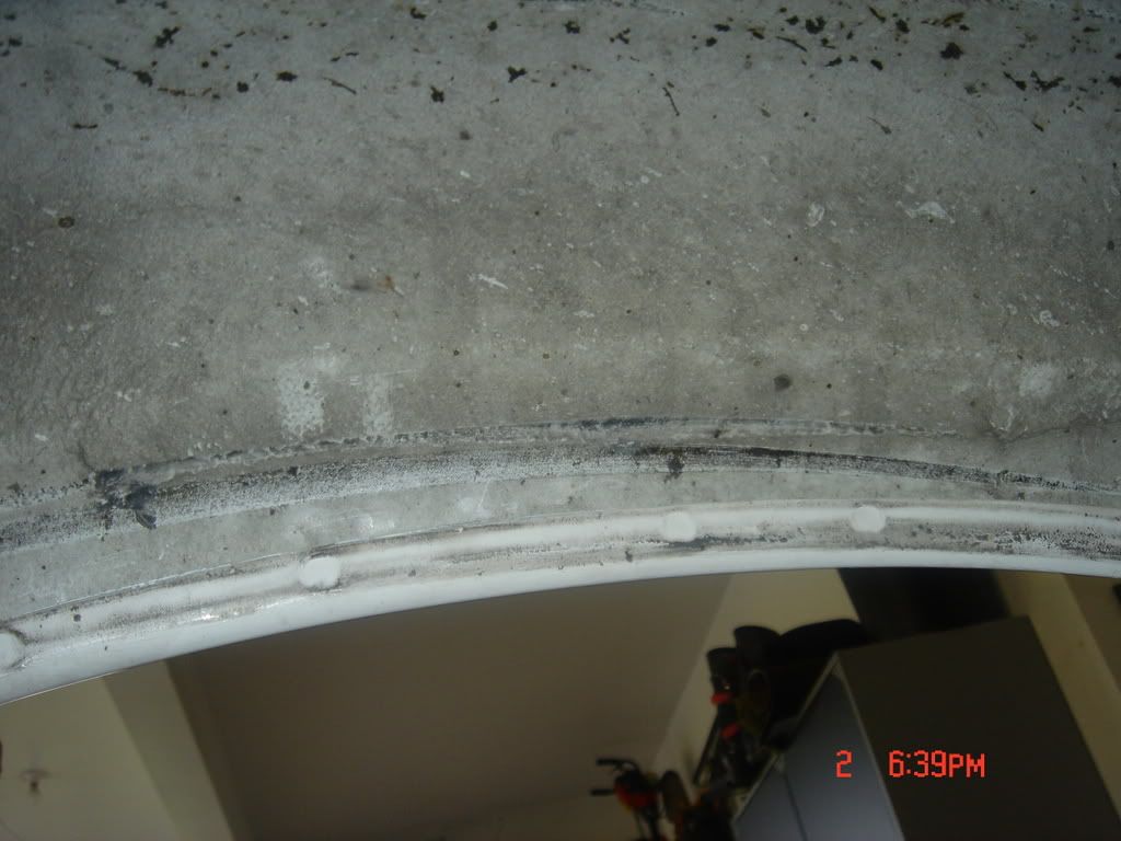

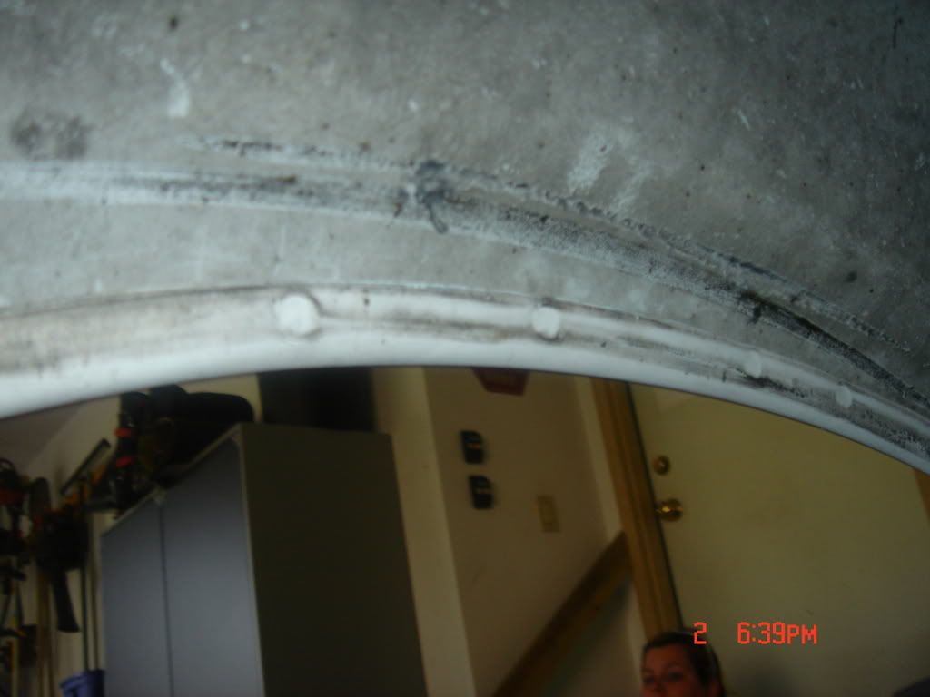

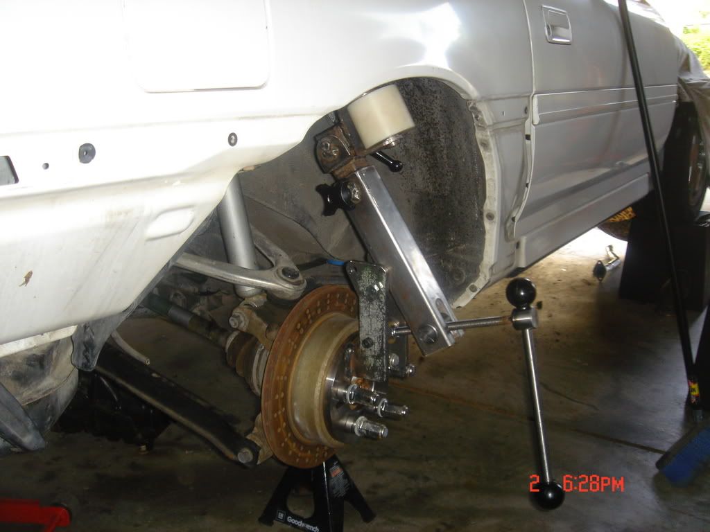

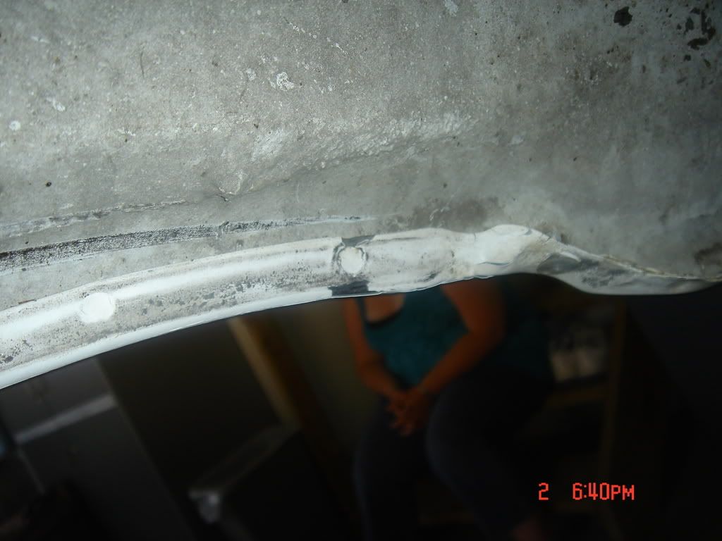

Well yesterday i finshed building my fender rolling tool. Now that i know it works with noe issues i can paint it.
So i decided to give it a try and roll my rear fenders.

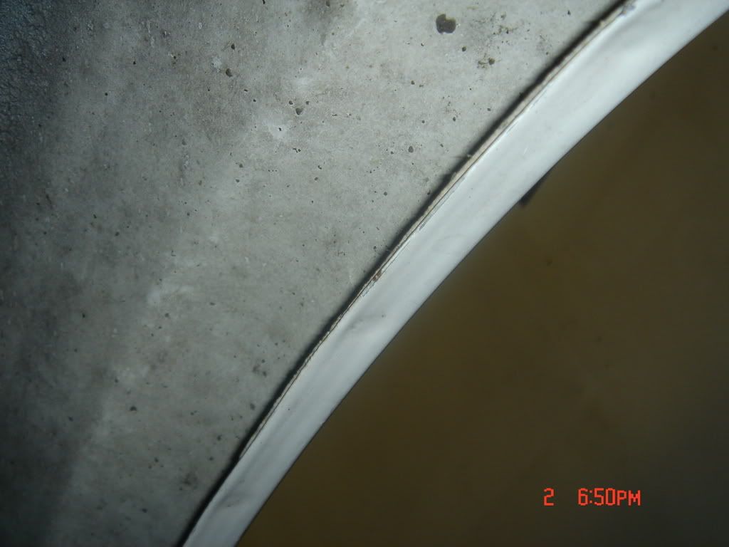

Here are a few pics of before.
And of after i rolled them.

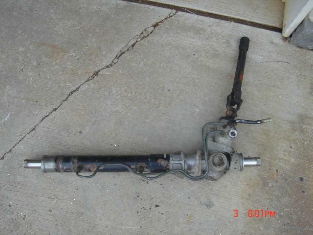

Today i striped the ps rack i got from shane and finshed up the 4 inch.

buckshotglass;1069211 said:
Awesome Wes. I'll be the first to ask... can I rent or borrow that? You already know you could sell them. How much would you sell one for?
Is that wheel from a bed frame?
No i made it out of a big 2 foot long chunk of nylon we have at work. But tire rack sells them for 200 and i dono if i could make them for that cheep. But pm about one or borrowing it.

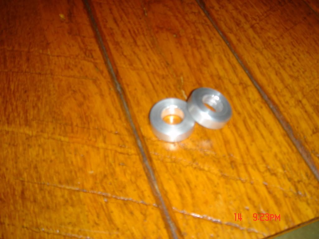

NashMan;1078970 said:
you can get more streeing if you made a extetion as in stead of spacers like threaded extion
Yea i could do that but they would cost alot more and have to be about 1 inch long spacers.
