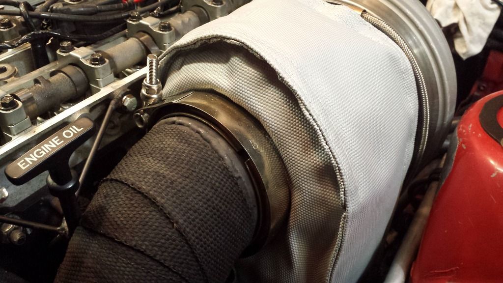

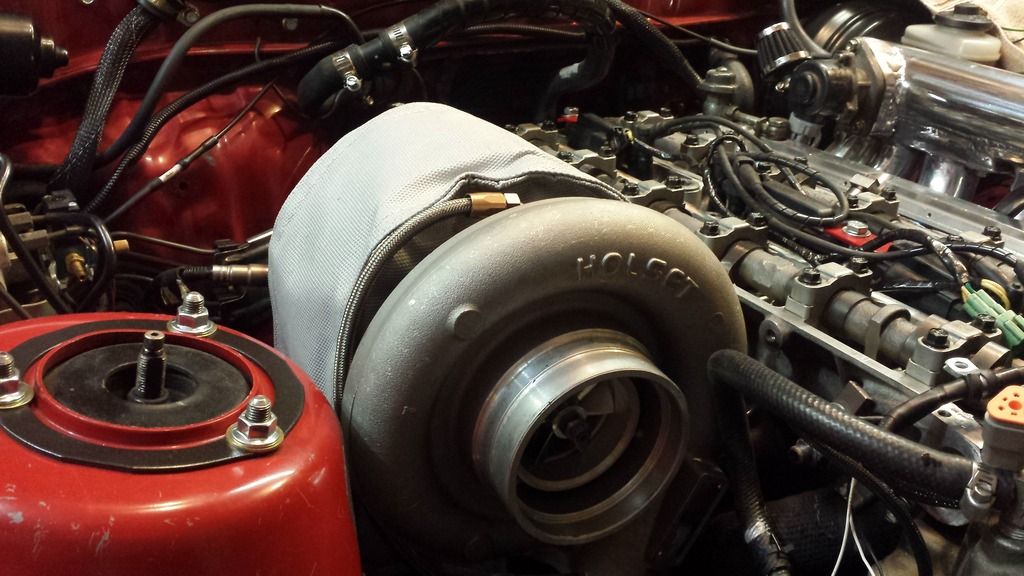

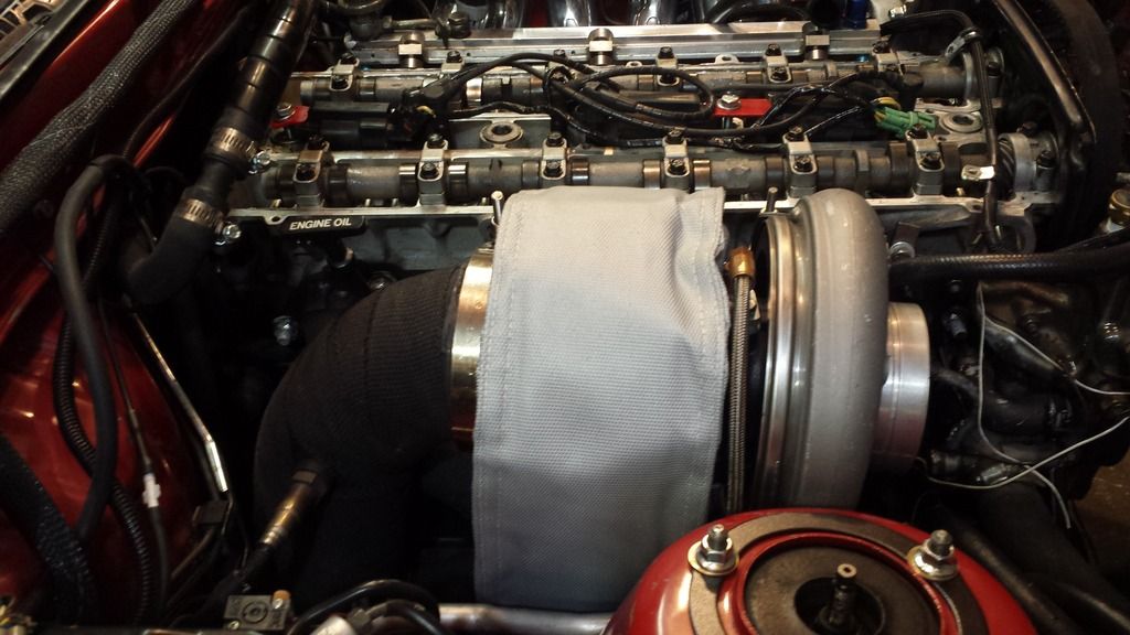

apparently the turbo blanket i ordered was sitting in my mailbox for 2 days and i didnt even know it arrived. threw on it so at least ill be able to run my hood again. the exhaust housing was burning up the insulation on the hood.
this is the same brand blanket i used on my hx35. its 30$ and lasted for a year or so and could have last much longer too. for that price, i figured id pick up another one but in t6 size.

Looks awesome!
If thats the ebay blanket - i have the same one and it must have smoked for 20-30min. Just a heads up!

The other blanket I used did the same thing. Oh well it wasn't too expensive and seems to knock down the heat a bunch.
