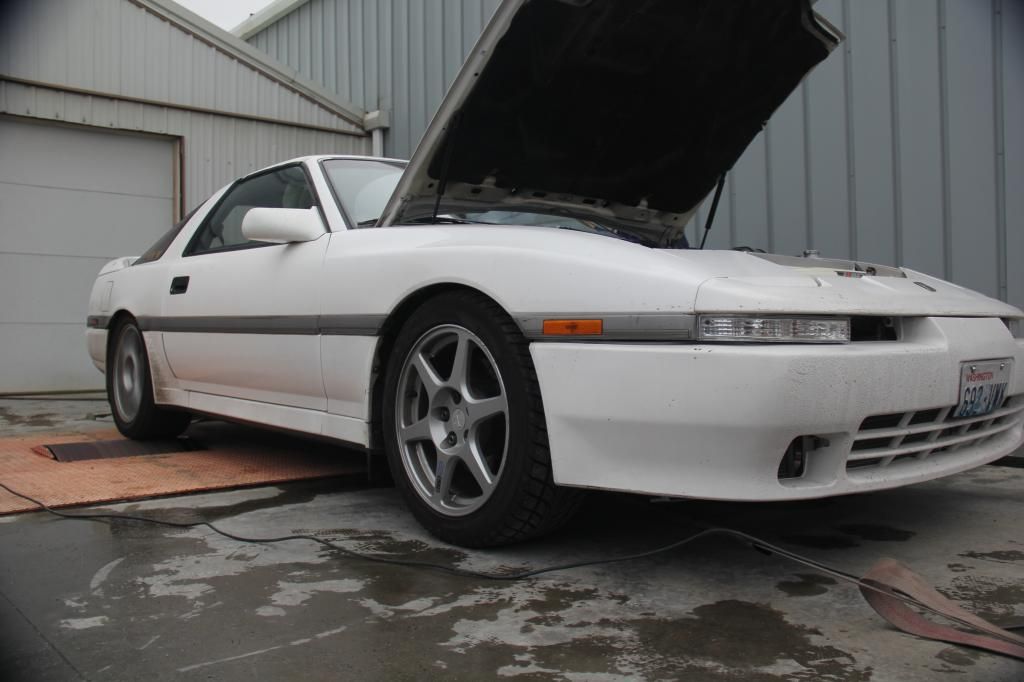

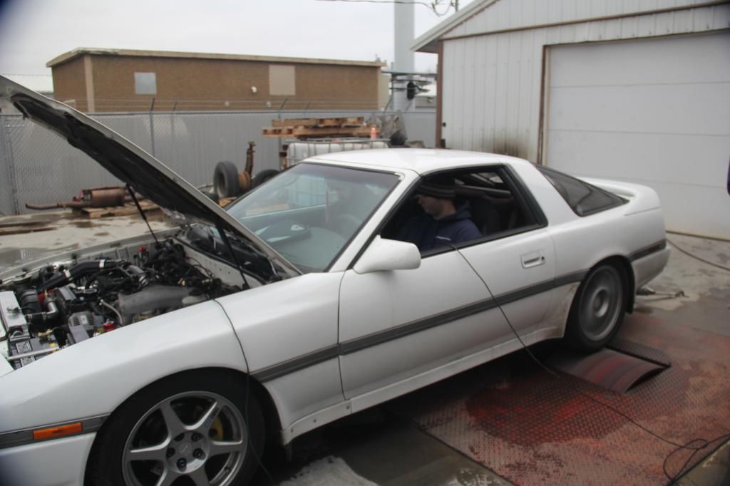

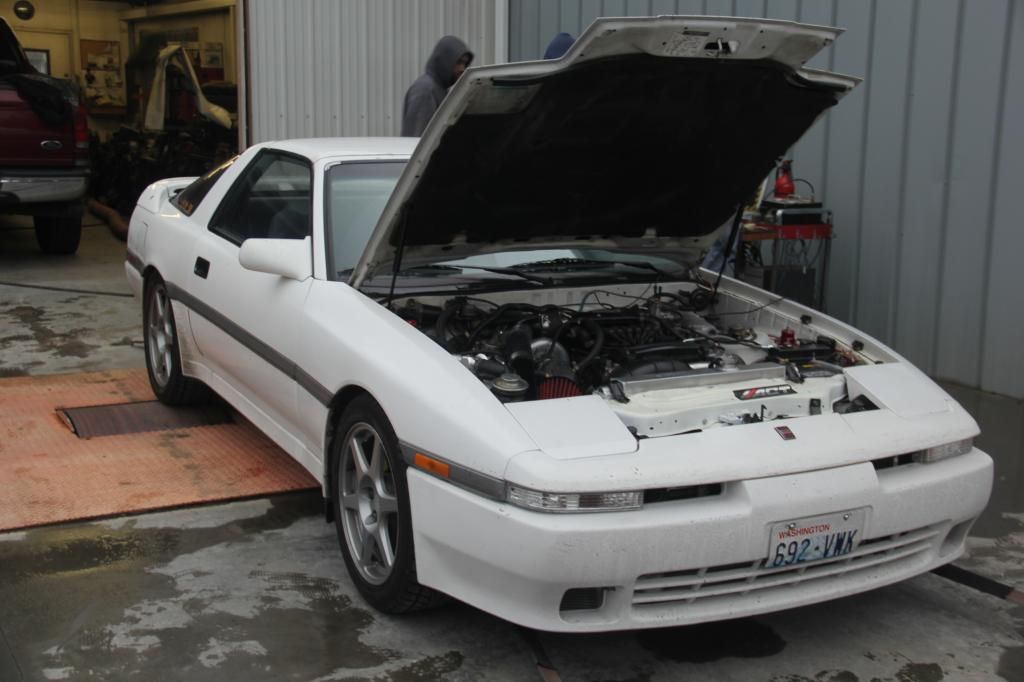

Thanks Kenny! Great day at the dyno, 415hp 392tqr to the wheels! Pretty happy with the results. I'll post up the dyno sheet once I get it emailed to me
