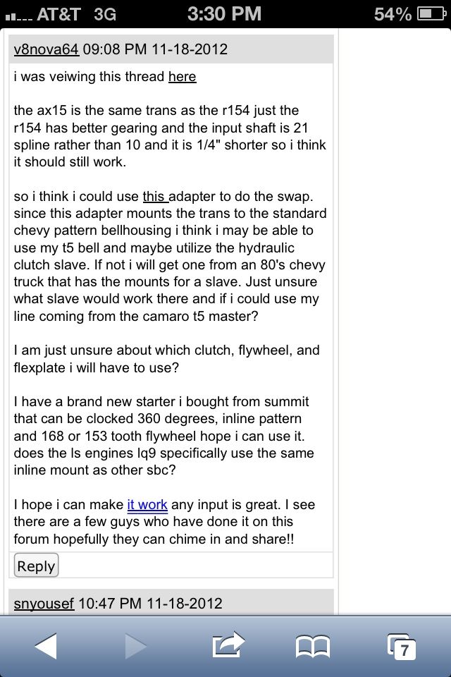

v8nova64;1893840 said:ok alright. If you guys cant send me the pattern could you get me an exact measurement of the thickness of the adapter than maybe we could just cut out the sbc pattern then trace the r154 pattern onto it by lining up the center bearing retainer hole. Also would we just use a front bearing retainer from whatever internal slave we are using? I think 4th gen camaro slave is what we will be using. Here is what we have planned out:
R154, the adapter, fj cruiser clutch disc, gm munice style bellhousing, 4th gen camaro slave cylinder and front bearing retainer.
Just unsure on which pressure plate, flywheel, clutch fork, clutch housing cover, and throwout bearing (or is one used with internal slave?) hope you guys can help!! Youve been great so far!!
Also we are having a hard time finding oilite round stock for the bushings. I forgot to ask is the dimensions of the bushing for LS engine to r154 or sbc to r154 is there a difference in O.D?
