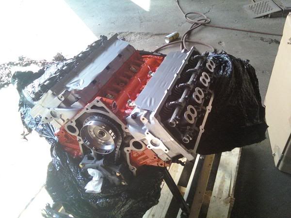

Anyone know what exhaust manifolds might work or atleast be close to fitting? I heard something about stock ctsv's fitting, but i need something with better flow than a stock cast iron manifold.. I was going to use the r154, but i ended up finding a t56 so plans have changed. Ill start a build thread when i start fabbing up mounts and such.
Here are a couple of mock up motor next to an r154..
