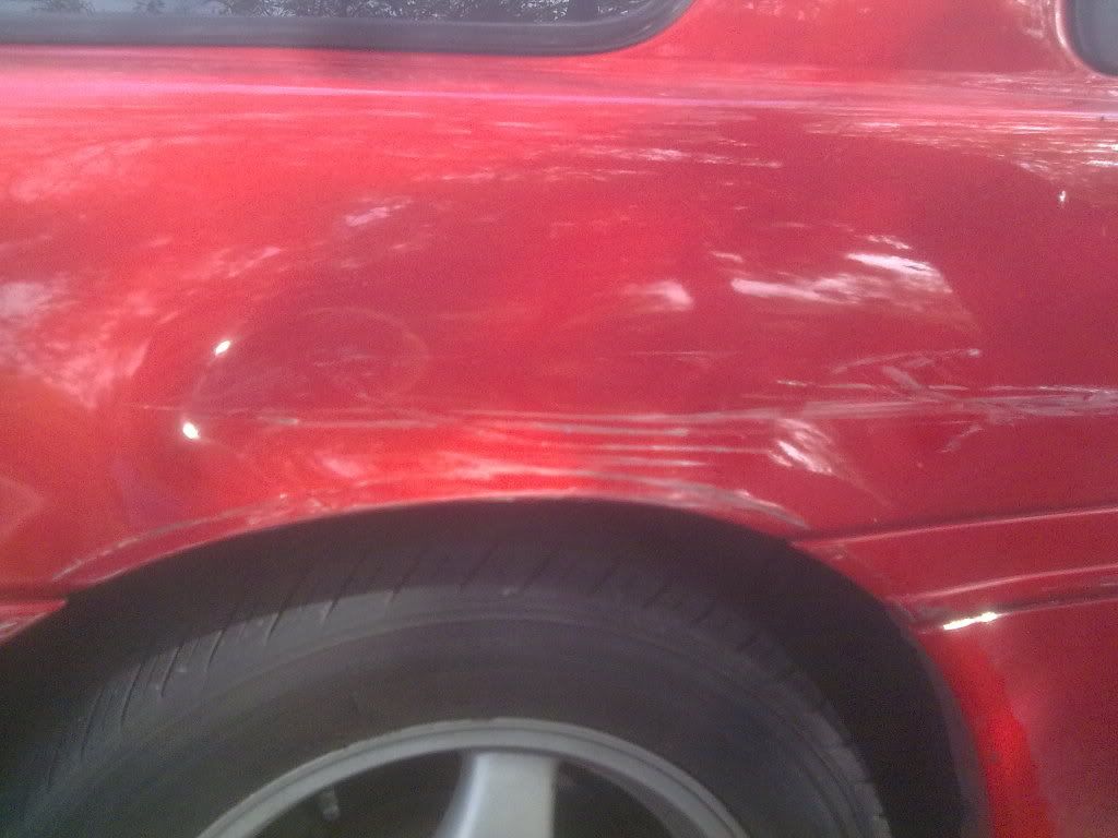

san supra;1646462 said:
rear quarter got side swiped in front of my house last night, nice dent right at the wheel well.
it was on the pretty side too....fuck.
Sad to hear. I almost got hit the other day because some stupid chick decided to go over 3 lanes on I10 without looking. :nono:Luckily i had enough room to avoid getting hit but she was literally inches from hitting my car.:aigo:
