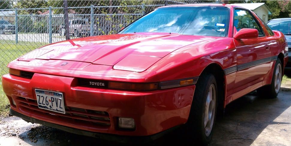

Well I didn't get the BW S366 That I wanted but I did pick up the DM 67mm Turbo. It was cheaper and I have a vacation coming up so need the money for are trip.:cry: Now all I need are cams for my birthday to push the bigger turbo. But thats not for another 3 months. :wtc: Since I have to wait for a turbo I cleaned her up alittle and took that purple tint off the windows. All she really needs a the moment is for the hood to be painted....... If I only knew some one that paints.:sarcasm:LOL
