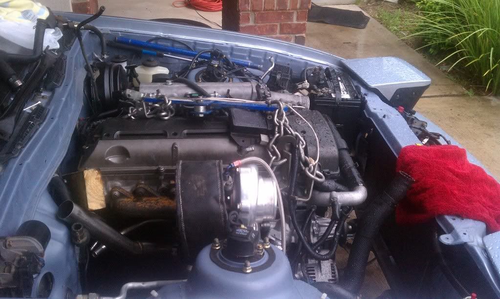

S.A. supra;1820954 said:
Yeah i was on this site last night. Plugs that are bad.... Male/female on the CPS. While i was tracing one the knock sensor wires (the car was running) i was looking at the ECU and grabbed the two wires for the sensor and the plug came off the ecu......car shut off!!! The plug to the ECU clip broke so there's nothing to really holding it in. I plugged it back in and started the car....got a code 11.....temporary lose of power to ecu. I bet none of you have had that code. Knock sensor bank two plug has broken clip so it keeps sliding off the knock sensor. Frayed wires to AFM, coolant sensor, and CPS. Wiring harness needs to be rewrapped. CPS is leaking oil. Found a small leak on the oil pan. Small coolant leak on the hose behind the water pump (i knew that hose wasnt gonna last but used it anyway). Soooooo basically a semi rushed job because of my rush to hear it run. Lesson learned so I shall do it right and move forward.
