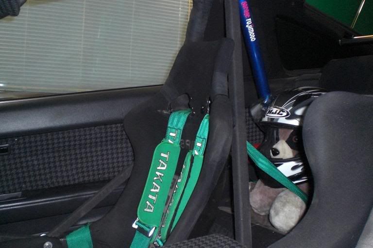

Cage all done, and extras. I couldn't find a place to put my helmet.
The back seat is sorta useless, so this bear can ride along.

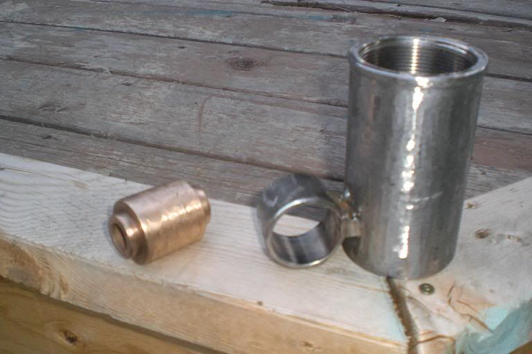

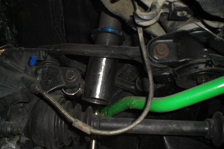

Constructing modified rear coilovers.
Typically the bodies are too long to get reallllllly low without pulling all the preload out of the spring. Bottoming out the shock piston is so 1997. Obviously this is a basic mock-up, it has now been dropped off for welding and gusseting by a licensed welder because I can sorta weld ... but I don't want to die.
I made the bushing on my lunch break instead of eating. Now I am hungry.
