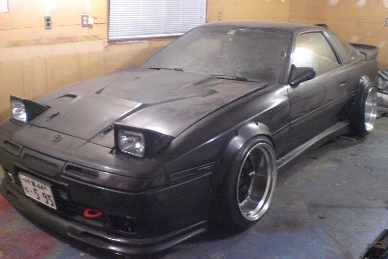

wow this thing is absoloutly gorgeous... i love how you have the widebody look without the actualy widebody lol i have somethign similar planed for my JZA70 except i think im going to run advan 3spokes with a really low offset and advan a048's. i was wondering where i would find those fender flares because ive been trying to find the perfect set and you have it so if it wouldnt be too much trouble, please let me know where i can order a set.

that thing is fresh 2 death, you should post it up on some 240sx forums and show them whats up with the supra world. They wouldnt believe a supra could have such a good fiment:aigo:

car looks pretty cool! not my cup of tea so to speak but it certainly does look aggressive. I'm just not one for stretched tires. The thing that does bother me though is that the car looks undrivable. how the heck do you go around corners without those tires rubbing?

Thanks for the comments.
Bit of a hiatus on the car, it's been very very cold here.
Will have more pics after Xmas.
Does not rub due to body trimming + stiff springs
Satin Black is legit, and low-cost, prob be like that for a bit.
White and black would be Ok too

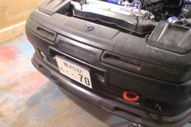

'70' Plate is a good fit for a JZA70.

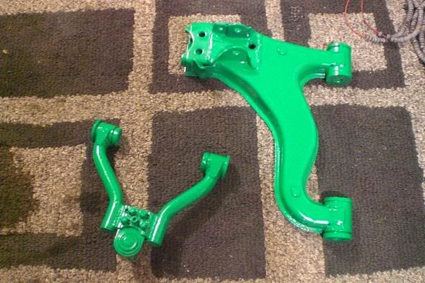

Control Arms, with new poly bushings. Painted green on St. Patrick's Day :)

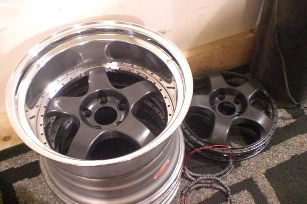

Pile of wheel parts to be assembled. Centers powdercoated, lips polished...

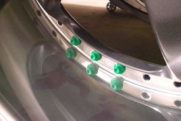

Silver Bolts would have been too boring. This should be neat.

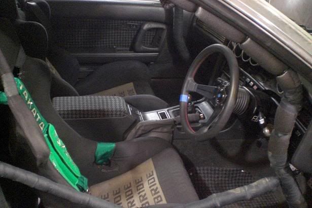

Random interior pic. The bolts and control arms match the seat belt's color.

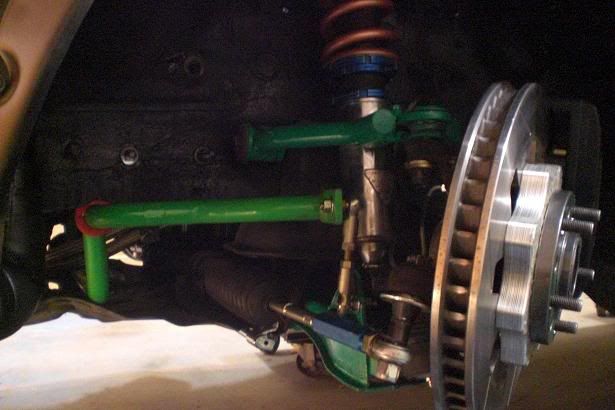

One corner.. showing Wilwood 13'' brakes, adjustable upper arms, painted control arm, new ball joints, big swaybars with poly bushings, GP Sports tie rod kit, BIC swaybar endlinks, stainless brake lines, cut and pulled fenders, gutted inner fender tubs, KTS pro Coilovers and pillowball upper mounts, Swift 18k springs and JIC under-engine control arm brace.

Definitely my favorite pic so far build looks like its going great. That stance just makes the MKIII look even meaner.
Keep the pics coming can't wait to see the end result :biglaugh:
