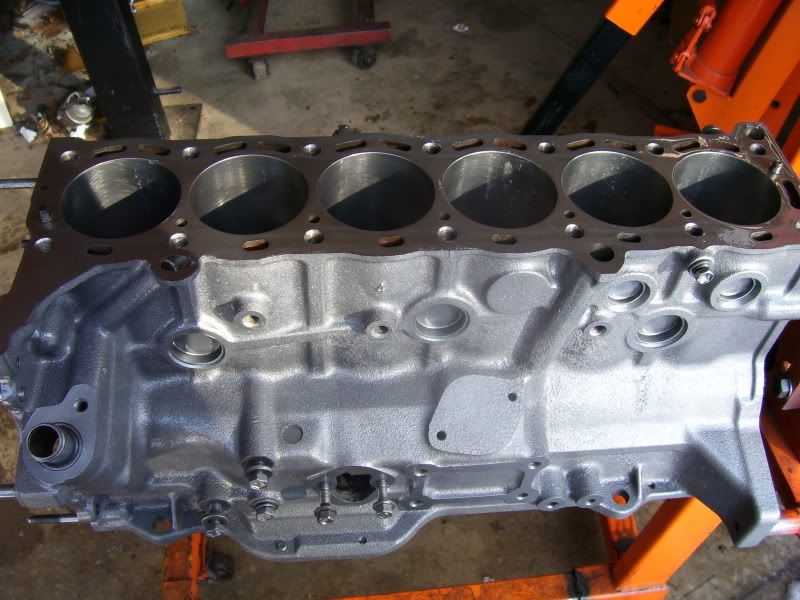

Ready for some assembly

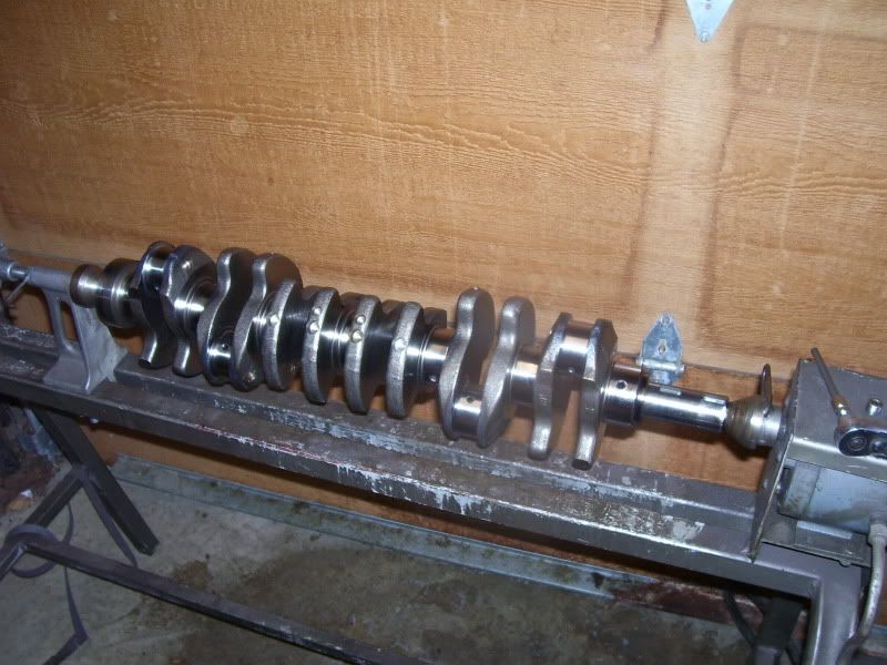

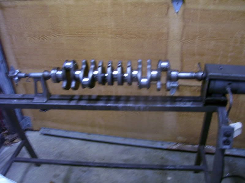

Final polish on the crank

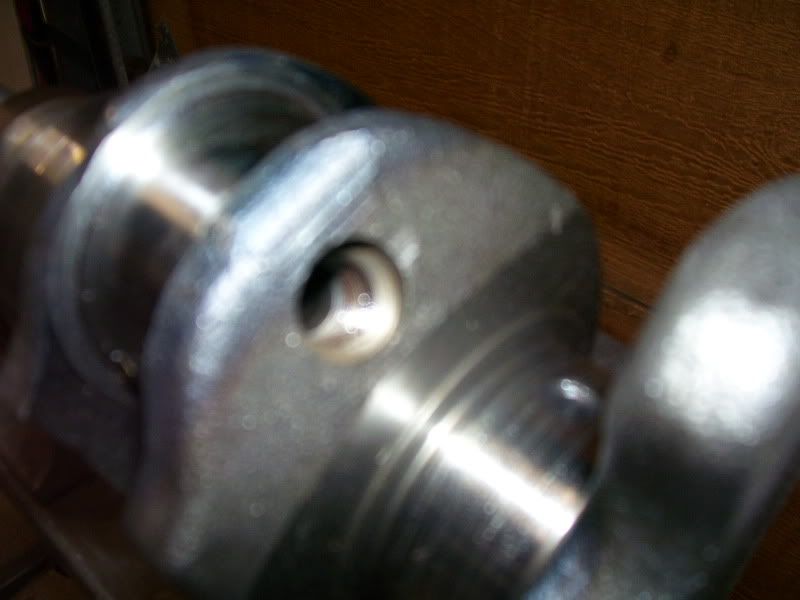

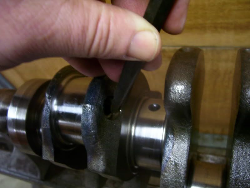

Remove the plugs to clean out the rod journal oil gallery.

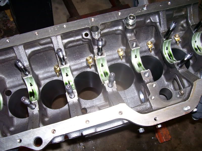

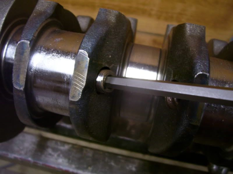

Back to posting some pics for the few who want to see them. Finally got some time to load some more pics to the bucket.
Got all the plugs out and blew them out with air. Not much of anything in there anyway.
All clean and ready to go.
I always take a punch and re-set the pinch on the plugs so they don't back out.

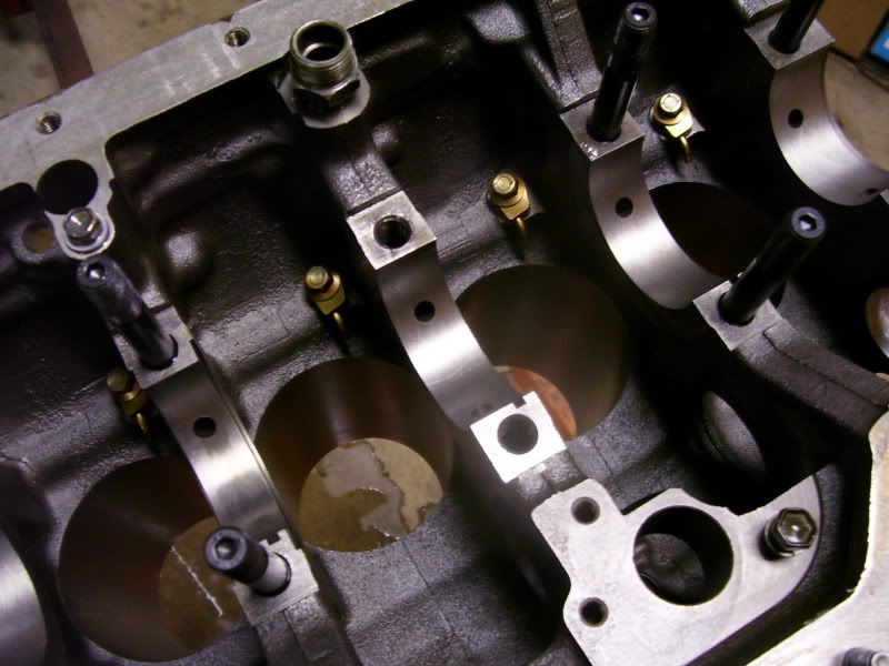

Now back to the block, oil squirts in, main studs in
Main bearings in and a little assembly lube rubbed onto the bearing surface

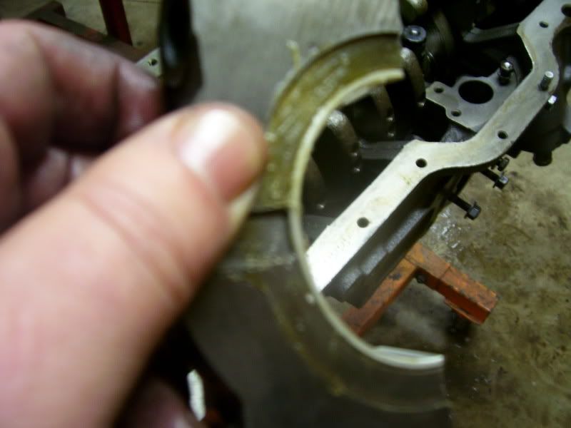

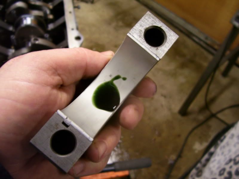

bearings installed into the main caps, little lube too.
Grease the main cap with the thrust washer so the thrust washer does not fall off when installing the crank.

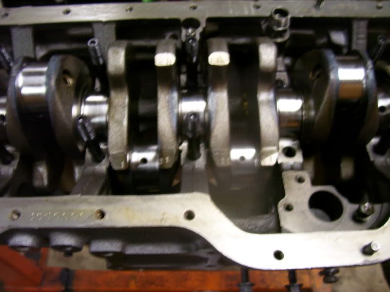

Crank is now set in
More later

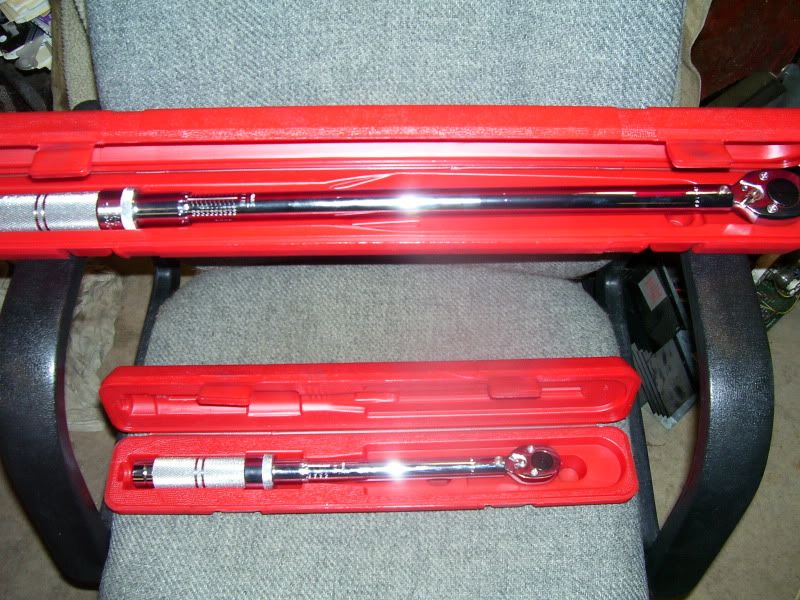

Look what the Mac tool guy brought to me. Needed some new bling in the garage, and the old torque wrenches had a real hard time passing calibration.

It was more like CCCCHHHHAAAAA------CCCHHHIIINGGGG Chris. But boy are they nice. Knurl metal grip, bright and shiny!
