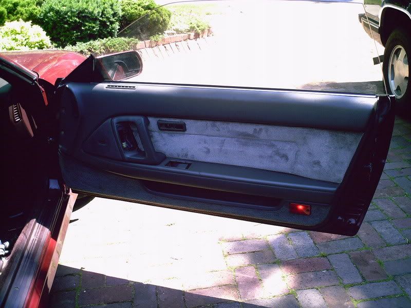

locustreign said:
well how hard are panels to swap out?
Pretty easy, You just have to remove like 6 screws at the bottom, two for the light, speaker grill, window switch, door handle cup w/one screw and remove the two plastic circle peices that are on the handle(top and bottom) and also their is two screws as well here but you have to remove the two caps.(also the 2nd pic is the door panel I changed. It was burgundy and now it gray).
