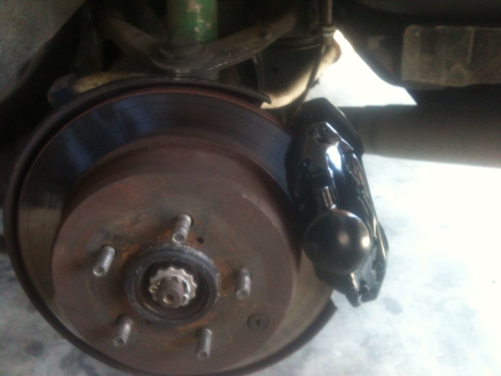

Well I got my brakes installed this weekend. The good news is when combined with my AZ Wilwoods the rears don't lock up before the fonts. The bad news is I flat spotted one of my front tires while bedding in the rears. The install was actually really easy. Everything just went together without any issues. Used my current supra Earls Stainless Steel lines. Does anybody know if the Discount Tire warranty covers flat spots? I paid the extra money for the damn protection so I would like to use it.
Did you end up using the 2mm washers to space the caliper outboard? Also what wilwood calipers are on the front, 6 or 4 pot? How is the pedal feel with the stock master cylinder?
Yes I used some 2mm spacers. I have the 4 pot Wilwoods. The pedal feel feels about the same as it did with the stock rears. Everything seems to be working great together. For some reasons my parking brake is looser now. I guess I have to readjust it for the STI rotors.
The Wilwood and Evo calipers are so easy to deal with compared to the stock units.
Parking brake being looser is very odd as the ID of the sti rotor parking brake is a decent bit smaller.
Thats what I thought so I didn't bother adjusting it when I put the rotors on. Maybe my old ebay rotors weren't to spec? Either way its just a minor annoyance having to remove the rotor to adjust.
